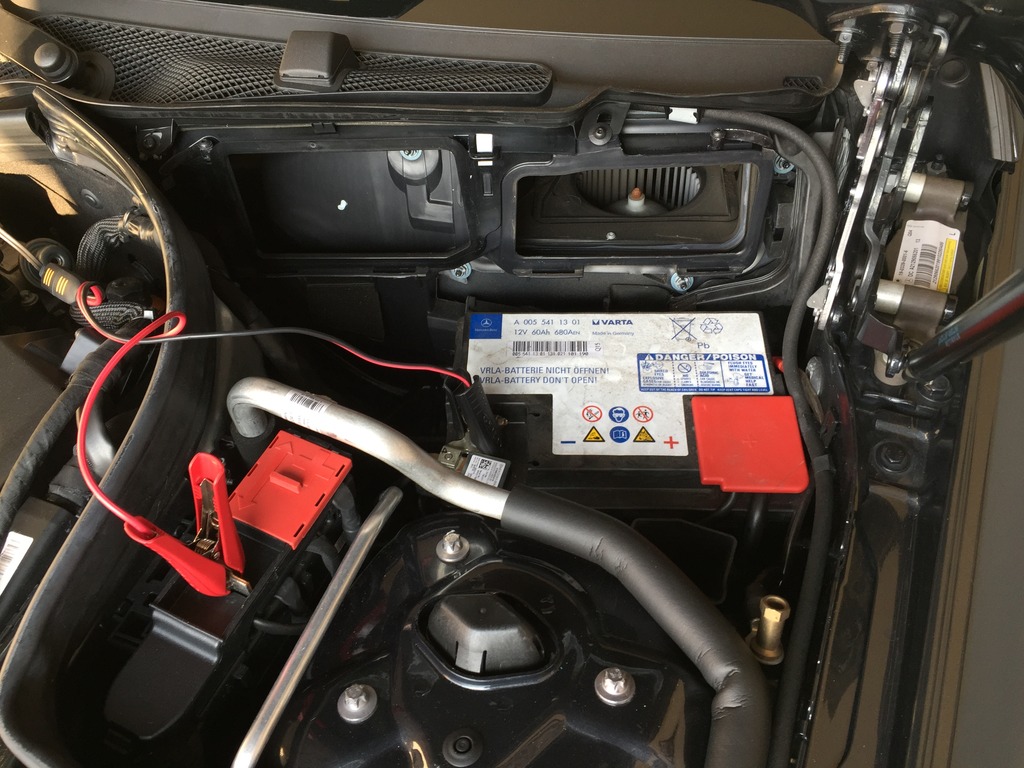

Update: got the CTEK MXS 3.8 from the post yesterday and plugged the coupe around 7pm (friday) last night, started from stage 2 and as of 8:30am saturday morning its at stage 4 (ready for use) but ill keep it on since its the weekend so wont be using the car anytime soon.
Im just surprised as to how small the battery is. Seems OEM with the MB logo but still...

Yeah, that is OEM but it does seem smaller (and on the wrong side ). My battery takes up all the space that you see to the left of yours. By the way, you can use the brass colored post on the right side for the negative. That way you don't have to take off the air intake cowl. No need to connect directly to battery then.
If I connect mine in the evening it is usually done by noon the next day thanks to the low state of charge the alternator leaves the battery in.
