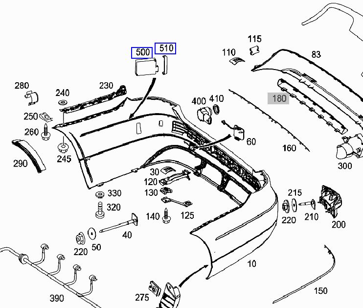

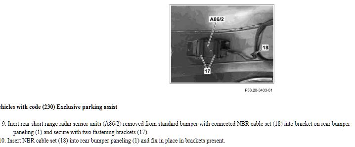

I was cleaning my 2010 E550 4Matic today and noticed that on the rear passenger side of the bumper there was a piece of plastic hanging out from underneath the car right next to the exhaust pipe.
It looked to have been welded on to the passenger side of the bumper (see yellow highlight in photo for location) and the weld failed. It was hanging by a harness that had 6-8 wires going into it.
I was able to get some 3M double sided tape and re-attach it however I'm wondering what this module is responsible for? I cant seem to find anything online showing anything near the spot.
Spot in bumper where module is located.
Mine after cleaning the area and re-attaching it.

Originally Posted by beejAMG
is that a photo of your E550? did you take the photo yourself?
No, the first one is just one I found online that was at the right angle. Second one is the actual module after fixing it.

Blind spot assist radar sensor (500/510 in diagram).
Attached Thumbnails Electrical Module Passenger side Bumper?-capture2.jpg   Electrical Module Passenger side Bumper?-capture.jpg

Definitely Konigstiger to the rescue again.
It looks like part 510 is some type of clip that is now missing from your re-installation. I'm not sure if that 3M foam tape will hold for very long. You may want to try the 3M DUAL LOCK tape, which is a hook and loop (velcro). That stuff is really strong and may be more weather resistant back there.
