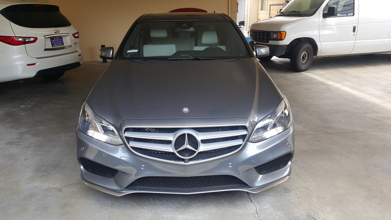

I do not blame the OP for thinking the sensors were standard, and they probably should be on a late model Mercedes-Benz, however they are very easy to spot on the exterior. There are 6 sensors in the front bumper and 6 in the rear. So if your bumpers are free of these "dots" then you do not have sensors.

I realize that most luxury cars are ordered by dealers with what they believe will be popular option packages. Most cars I've shopped list parking sensors as an option. Now the dealer may have ordered it that way so it would sell to their target customer, but that doesn't mean the sensors are standard on base models.
OP, if you want help with what you are seeing on the dash, why not post a picture of it?

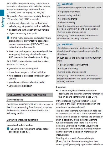

Originally Posted by albert328gts
Something strange happened on the freeway today, as I was speeding up and getting close to the car in front of me I got a warning tone.
Collision Prevention Assist https://www.mbusa.com/mercedes/techn...00ccec1e35RCRD

Ok, cool. You have the collision prevention assist. I assume your start up warning graphic and tone is simply telling you it is turned off. Turn it on.

Arrow
CPA (258 data card)
Attached Thumbnails New Owner SENSOR question-capture.jpg   New Owner SENSOR question-capture2.jpg
