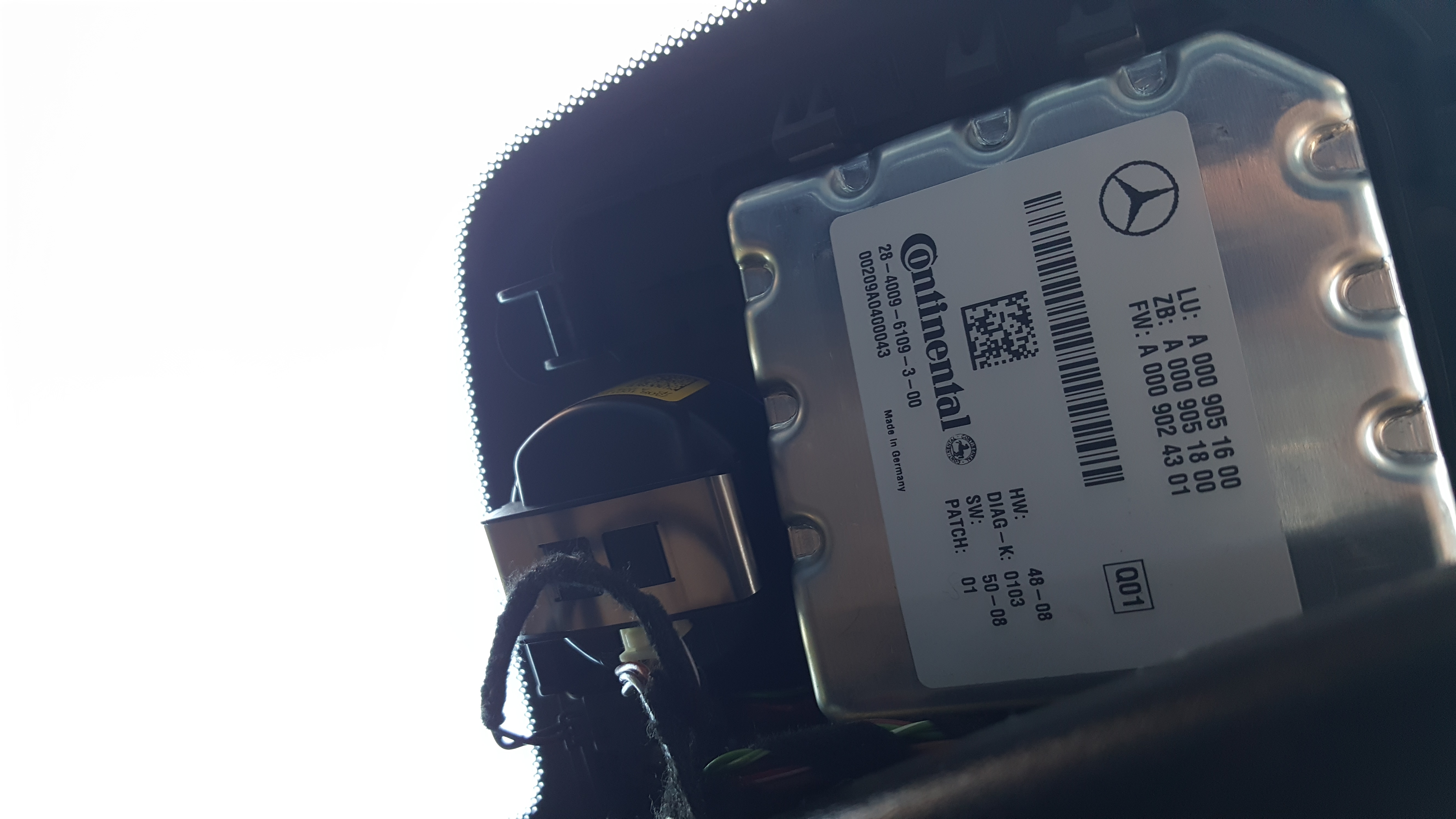

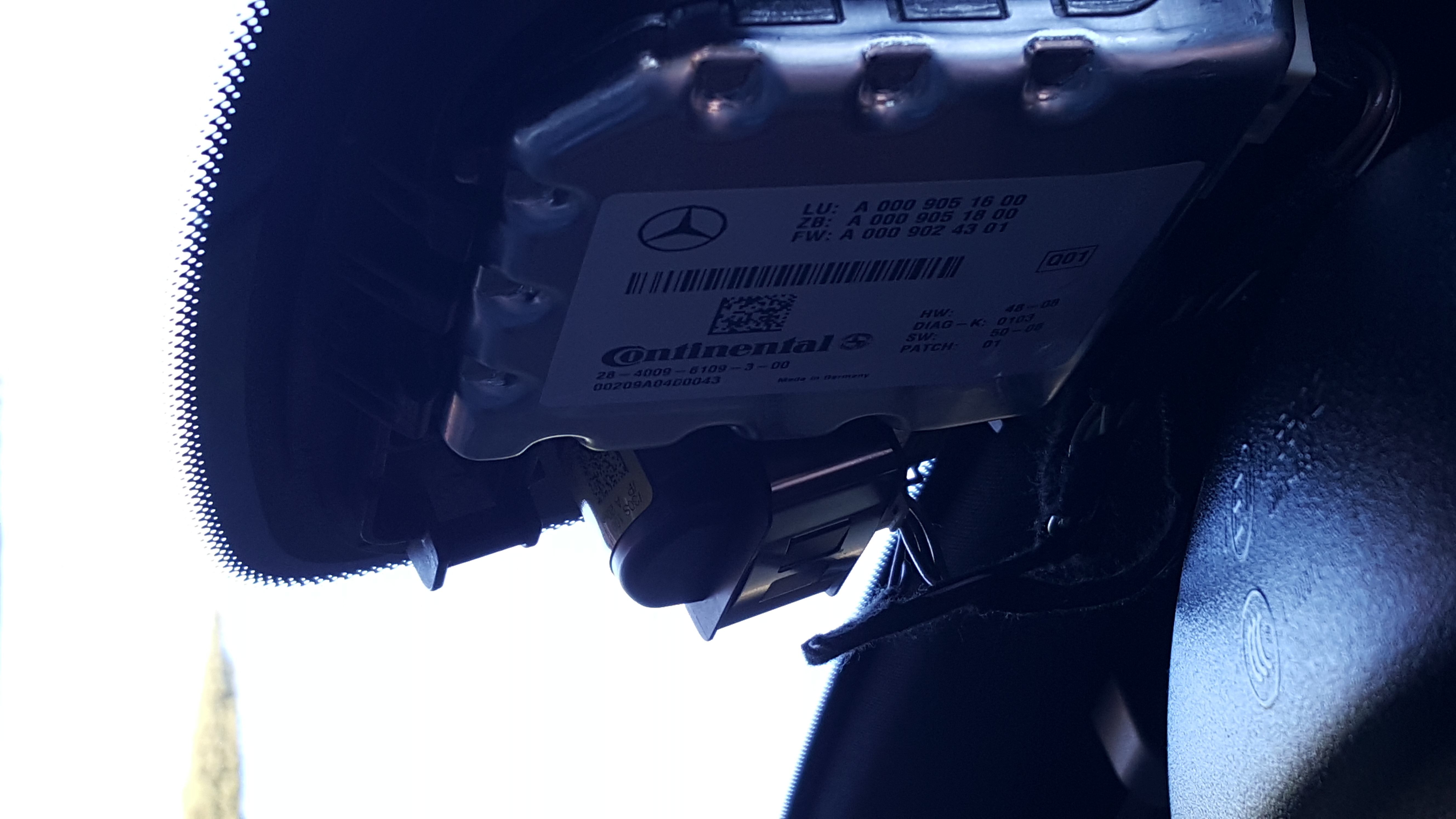

hello everyone
so today i was looking for a place to hard wire my radar detector next to rear view mirror , so i took off the cover right behind it , and found that i have a Night Vision camera (but i dont even have that as an option in my navi screen)
so i was wondering if i can maybe get it activated somehow? or what is that for then ? factory installed but never programmed?
and another question , can i plug in my radar power wire to any of those plugs?units ??
P.S. as far i understand the other unit is a rain sensor right?
any help is appreciated. thanks.
Attached Thumbnails Windhshield camera and sensors-20160722_184944.jpg   Windhshield camera and sensors-20160722_184948.jpg   Windhshield camera and sensors-20160722_185007.jpg

If it's the same as mine, it's not a night vision camera, it's the camera used for lane keep assist.

but it is still a camera , which has not been programmed? and its there. But also for lane assist you need Distronic to go with it im guessing , which i dont have. hmm

It is a camera and programmed to be used by lane assist. I have lane assist but no distronic.
I think night vision uses a different camera as it uses infrared.
also distronic has a sensor in the front grill. You can tell by a big black square plastic piece in the middle of the grill. The sensor for distronic is behind that.

I think that is for the attention assist which you have on your 2010 even though you don't have distronic. Later models had lane keep separate from distronic but I think in 2010 and 2011 you didn't have that feature unless you also had distronic.

High beam assist (code 608).

Yes, P2 has the auto headlights when you push the left stalk forward. So the camera is looking for oncoming headlights, in order to turn the high beams on and off.
