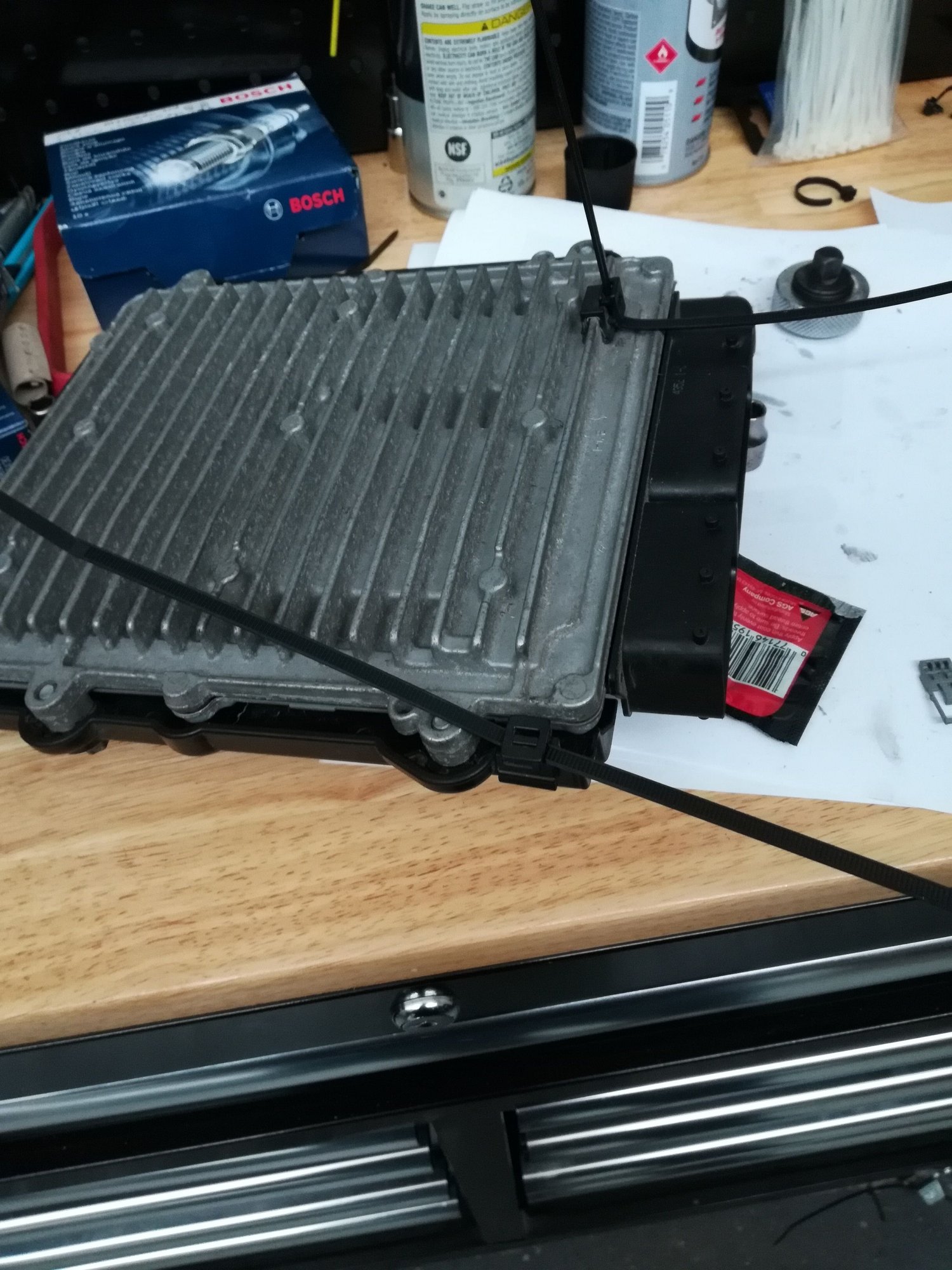

First, thanks Searay, excellent write-up. I just changed the plugs to my 2013 C350. It is basically the same engine that Searay posted in his PDF. The only difference is that my harness wraps around the ECU.
Note: I did not remove the manifold, I tackled the locking clips on the coils from the side.
Here is my experience:
1) Searay the clamp to the airfilter is not a one time use. Buy a Click-R plier and you can reuse them. It's about $15 on Amazon.
2) Start with the airfilter side. This way you will see how things work and get practice for the really tough side (drivers side).
3) I used electrical tape to ensure that I am not fishing for my tools. See pics.
4) This may not be proper but I find taking off the coils easier if I removed the safety lock from the coil. The safety lock is gray and if you keep applying force it will just shoot off and fly across the room. But be careful you can break the connector when the grey lock is not on. Also as Sea Ray said you must press down once you unlock the connector. When I reinstalled without the grey locking tab you will hear a click which was music to my ears.
5) the 14 mm (12 point) tool can be found in AutoZone for $6.99.
6) On the driver’s side I snipped the tie downs and replaced them which is much easier than trying to pull them out from the base.
7) taking out the ECU was a pita. As Searay said it takes force. After I got it out I applied wheel bearing gease to all the grommets. It will be easier to remove next time.
Click-R pliers
Tape on my socket so it doesn't detach.
Tape on my universal socket and 14 mm socket, aain so they won't accidentally fall off.
I snipped all my zip ties (driver side) and replaced with new ones.
