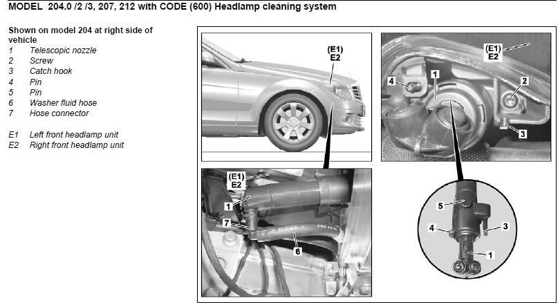

Does anyone know if there is a way to leave the headlight washers in the extended position ?
I'm looking to have them in the extended position as I have to service one of them and re aim the nozzle on another.
Pulling the flap on the bumper down is straight forward, however, getting the washing system to extend outward and remain in that position is what I'm looking to do.

Hi! Im trying to solve a situation on my E220, this is the problem, I have xenon headlights, and therefore i have washer instaled in front bumper, but there are no wires connected onto pump, i know its supposed to be conected somewhere in SAM module but have no idea where exactly, and why is it even disconnected and why are wires removed. I want to connect it back as it was so if someone can give me some wiring diagram that would be very helpfull. Thanks!
Pump is here, but nothing connected to it

these are powered by water and only extend when the proper pressure is exerted on the nozzle assembly from the pump. To service them without removing the front bumper cover, you can just reach down and grab the head and pull it straight up(they do lean forward at the top a little, just fyi). Be careful and do not twist or rotate the head too much to avoid snapping it off. You'll have to hold it up while you work(or brace it somehow?) but you can adjust the nozzles and then cycle the washer button to test.
