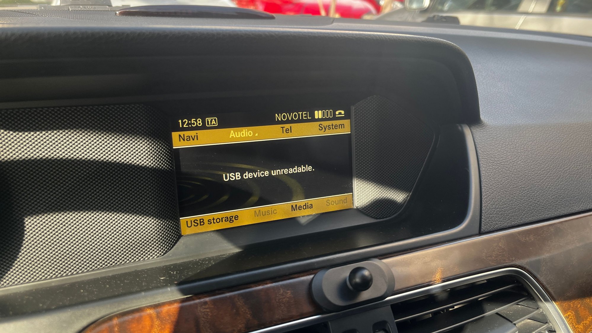

USB device unreadable
did you solve your problem?
tryed fat32, ex-fat, ntfs, nothing works.
