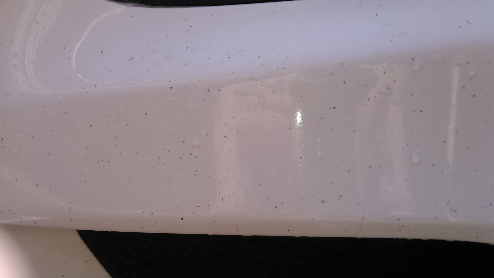

OK, guys, sorry it took so long to get these pics up, but it's my wife's, and she leaves for work before light and gets back after dark, and it's been raining for at least 40 days and 40 nights, and it was covered in bugs so I wanted to wash it before posting.

Holy moly! That’s ridiculous. Thanks for posting those up. Such a shame on such a beautiful car.

@darel - yeah... late to reply but based on your pics, looks to be severe road rash, and it would be tough to prove it's due to paint defect, so smart move on not stressing over a warranty claim, as it would be a wasted effort imo. Best to you and your family on your deployment.
