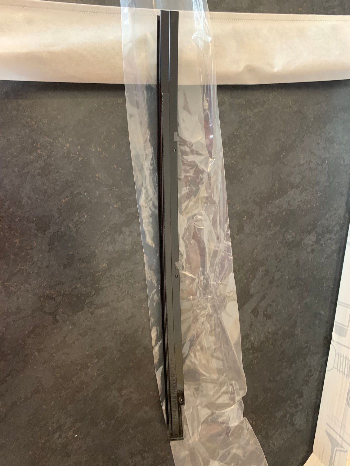

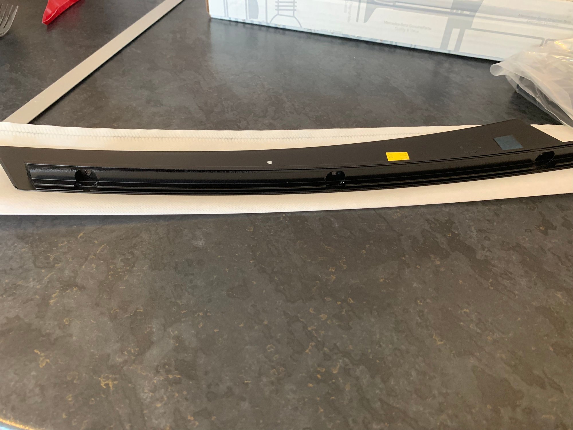

Hello everyone I’m looking to see if anyone has replaced the black metal window dividers on their w212 ? Mine have gone all bubbly and look hideous so today I’ve had brand new ones delivered but have no idea on how to replace them. So any help would be extremely grateful thank you

my guess for you have to remove fixed glass first.
Post pic of new parts - do they have bolt holes in ends or end?

Yes both parts have bolt holes

Well rear on looks simple.. probably remove door seal to find those screws.... and unscrew and replace...
Might have to remove top and bottom trim as I am guessing the hold the edge to the glass or maybe theu use tape or glue.
middle one
need to lower glass and find them screw holes behind the seals... and hope you can remove with fixed glass in place.
OR
GO to BODY shop and have them do it...

Quick update all completed this afternoon in less than 30mins very simple no window removal only the door card and trims thanks for the input ��
