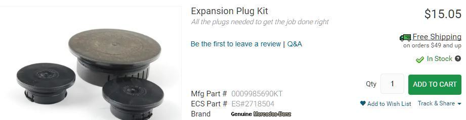

Also look at the Cam plugs on each side of the engine. Back of engine at the top and facing the firewall. You can't miss them. They are cheap to replace and often weep oil.

Had a weepy cam plug replaced for a few hundred bucks.

There's a kit available to replace expansion plugs, simply pull originals out and install replacements.

Yes, cheapo fix
