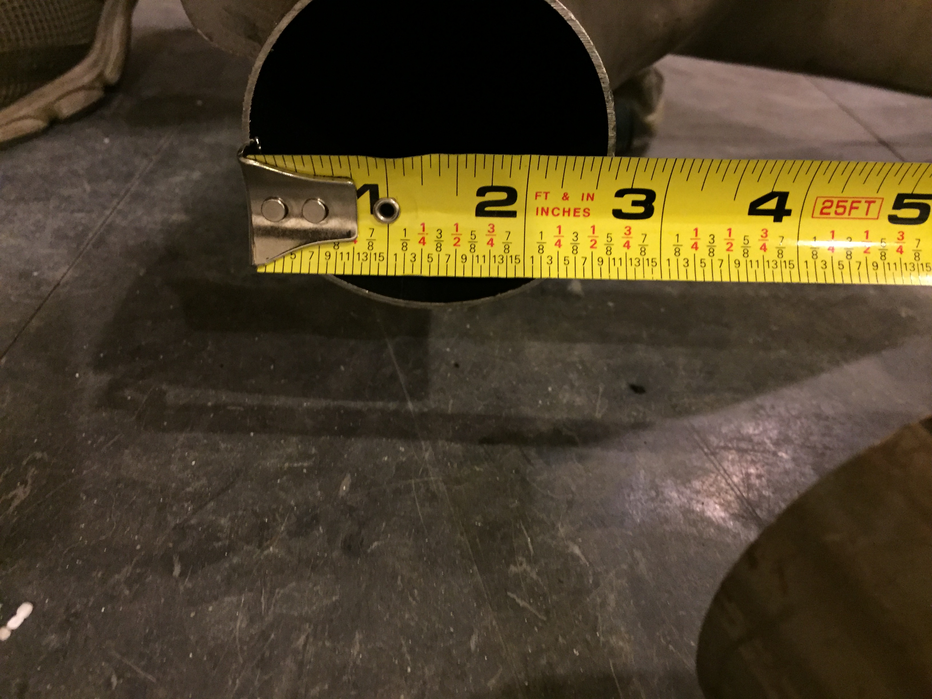

Here is the OEM 2013 E550 exhaust
Attached Thumbnails 2013 E550 Exhaust Comparison - Stock vs. 3 inch vs. AMG-e550-downpipes.jpg   2013 E550 Exhaust Comparison - Stock vs. 3 inch vs. AMG-e550-id-slip.jpg   2013 E550 Exhaust Comparison - Stock vs. 3 inch vs. AMG-e550-l-muff.jpg   2013 E550 Exhaust Comparison - Stock vs. 3 inch vs. AMG-e550-r-muff.jpg   2013 E550 Exhaust Comparison - Stock vs. 3 inch vs. AMG-e550-mid-section.jpg

Here are the E63 pipes (2012 for the downpipes, 2014 for the catback)
Attached Thumbnails 2013 E550 Exhaust Comparison - Stock vs. 3 inch vs. AMG-e63-downpipes.jpg   2013 E550 Exhaust Comparison - Stock vs. 3 inch vs. AMG-e63-mid-section.jpg   2013 E550 Exhaust Comparison - Stock vs. 3 inch vs. AMG-e63-l-muff.jpg   2013 E550 Exhaust Comparison - Stock vs. 3 inch vs. AMG-e63-r-muff.jpg   2013 E550 Exhaust Comparison - Stock vs. 3 inch vs. AMG-e63-cut-id-near-muff-.jpg
2013 E550 Exhaust Comparison - Stock vs. 3 inch vs. AMG-e63-od-slip.jpg   2013 E550 Exhaust Comparison - Stock vs. 3 inch vs. AMG-e63-cuts-flat-section-normal-.jpg

Great pics. Thanks for posting them up. Sounds like you really did a lot of work to get the sound you wanted. And that's the problem since you don't really know what a specific set up sounds like until you spend all the money on it.
