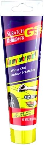

I have d-loaded your picture to examine close up, and I do not see any sensors visible. If you have sensors in the bumper cover, they would be obvious round buttons. See the three "Buttons" in my RR bumper cover. They are beyond obvious, ugly even.. If you do not have these, then your dealer is really lying to you about sensors you don't have.. NONE of the options you quoted in your original post require sensor buttons in the bumper cover.
In any case, your dealer is not being truthful with you about replacing the bumper. At worst, the sensors can be removed temporarilly (from behind) to buff out the imperfection in the bumper cover without need for a new bumper cover at all.
If the sensor is severely scratched, the sensor will not work. (Put the car in reverse -- braked of course -- and have someone walk (closely) behind and block the bruised sensor with a hand or leg. If you get the lights/beeps, then the sensor is working.)
If it's working properly, then a light buff of GS27 will remove the smudging without disassembly... certainly no need for the dealer. If you are really worried, you can apply a round masking tape button over the sensor, then buff out the scratch in the bumper cover around the sensor with GS27. Remove masking tape and you're done.
GS27 is not an aggressive agent, like a rubbing compound. It's the consistency of a liquid wax. It will not harm the base paint finish, or even the clear coat. It just "fills-in" the scratches. That is why I would recommend this approach, first. You can apply and then rub a little, let dry to a haze then wipe off. Repeat if needed. It's worth a try before going to more aggressive paint repairs.
The newer tubes of GS27 may be green color. Check any Walmart, or order online. It will not remove dents, but I have used it several times to remove imbedded paint transfers (in dents) from other vehicles.
All of this advice is pretty worthless, though, without a better close-up picture. Can't see any damage (or sensors) at all in your OP.

I bought the GS27 at least 20 years ago. It's lasted all these years and I used it on my wife's car a couple months ago. Still works great, but after all this time it's almost gone. Time to buy more. The amount of material in this link appears to be a misprint, as the details show 6.4oz...
https://www.amazon.com/gp/product/B017BYGRRC/ref=ox_sc_act_title_1?smid=A1UMBRA5ZTBCX8&psc=1 https://www.amazon.com/gp/product/B017BYGRRC/ref=ox_sc_act_title_1?smid=A1UMBRA5ZTBCX8&psc=1
All those years ago, GS27 was among the first of the DIY scratch removers, IIRC. Now, there are a dozen or more different brands available. I have some "Formula 1 ScratchOut," too, but don't like it as much as the GS27.
I imagine all of them work about the same, so there's to harm trying Carfidant or any of the newer stuff. Might be even better than GS27. Let us know how it works
