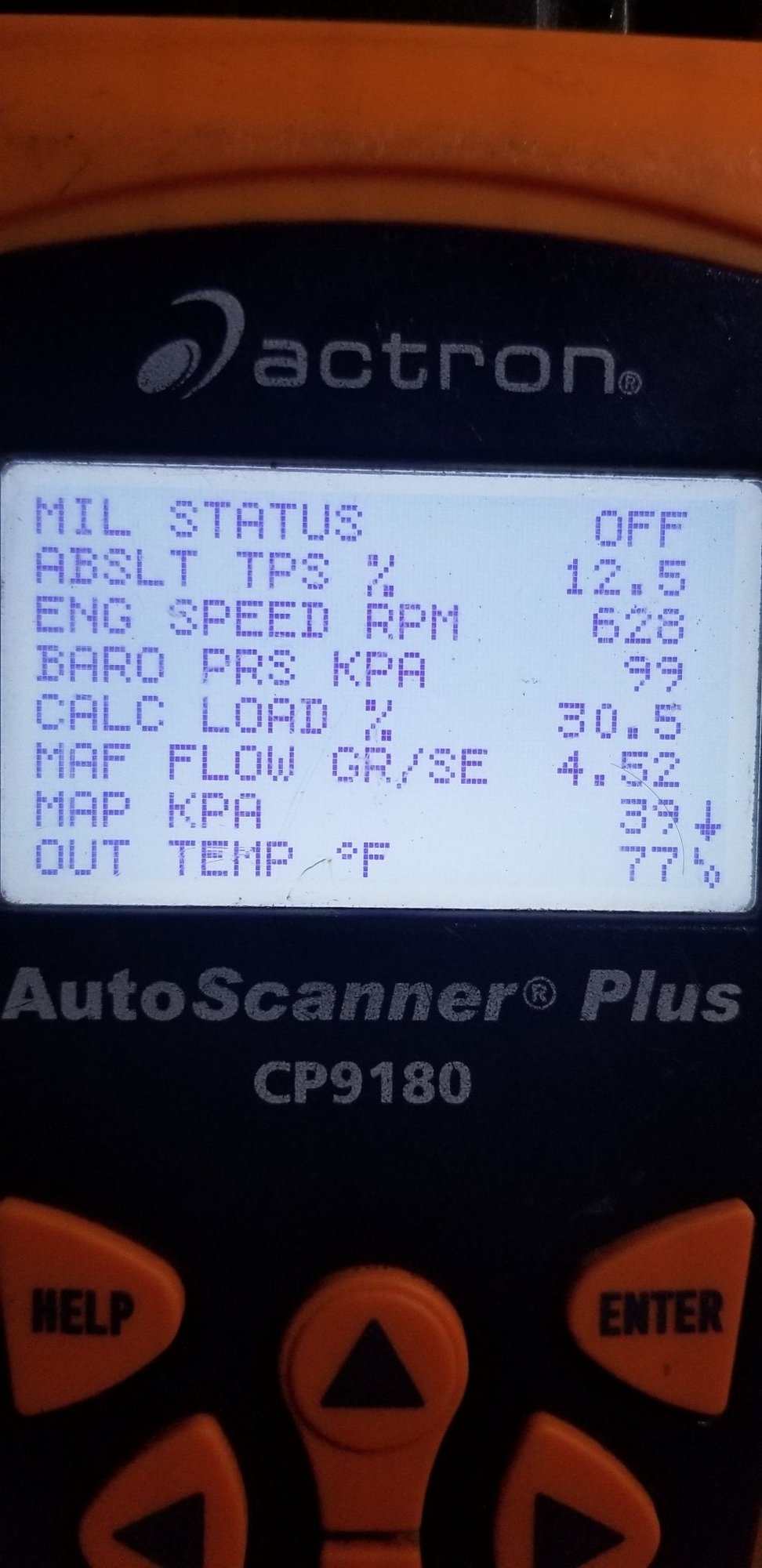

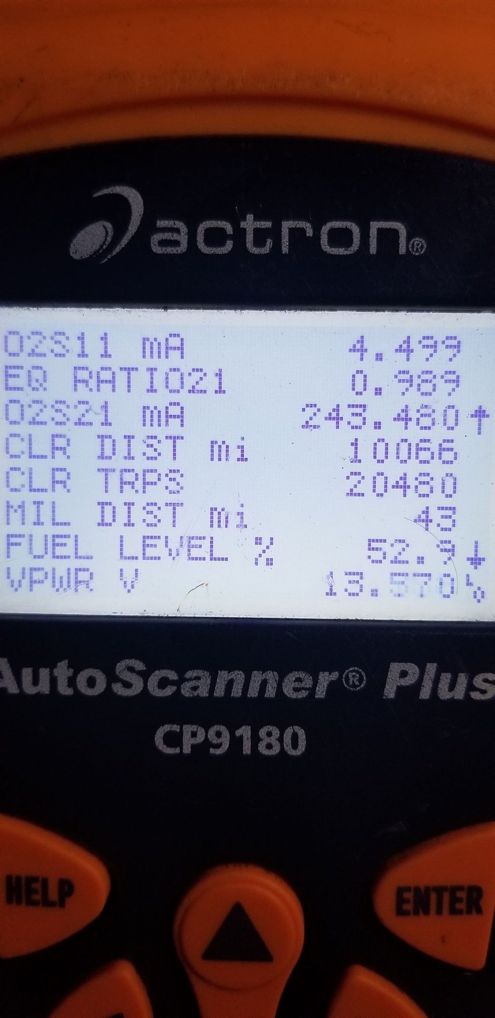

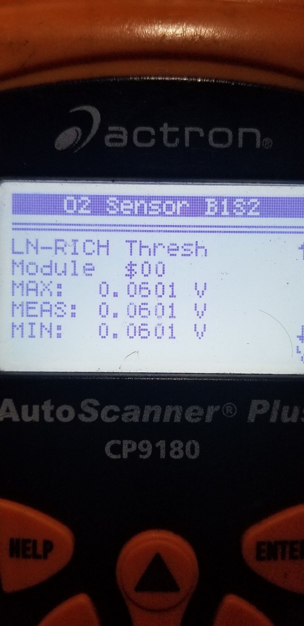

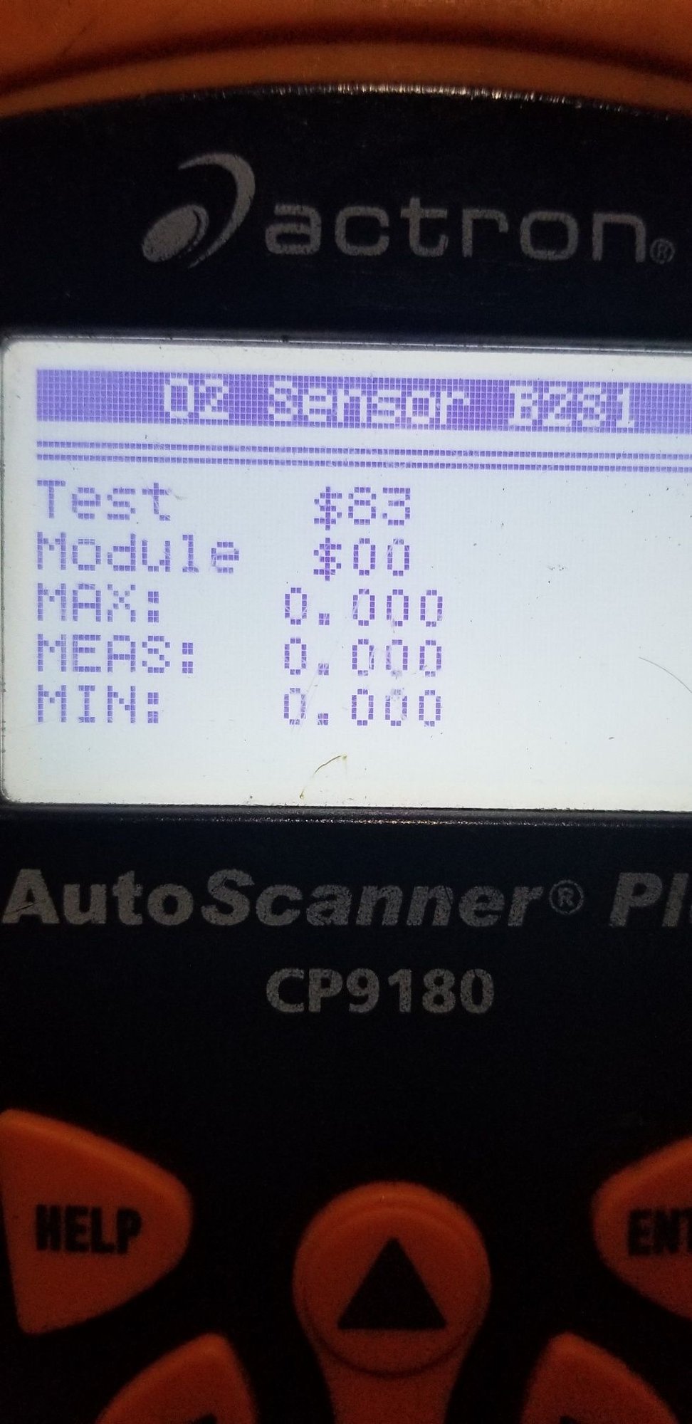

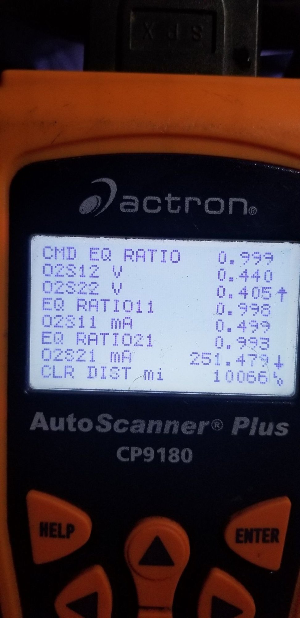

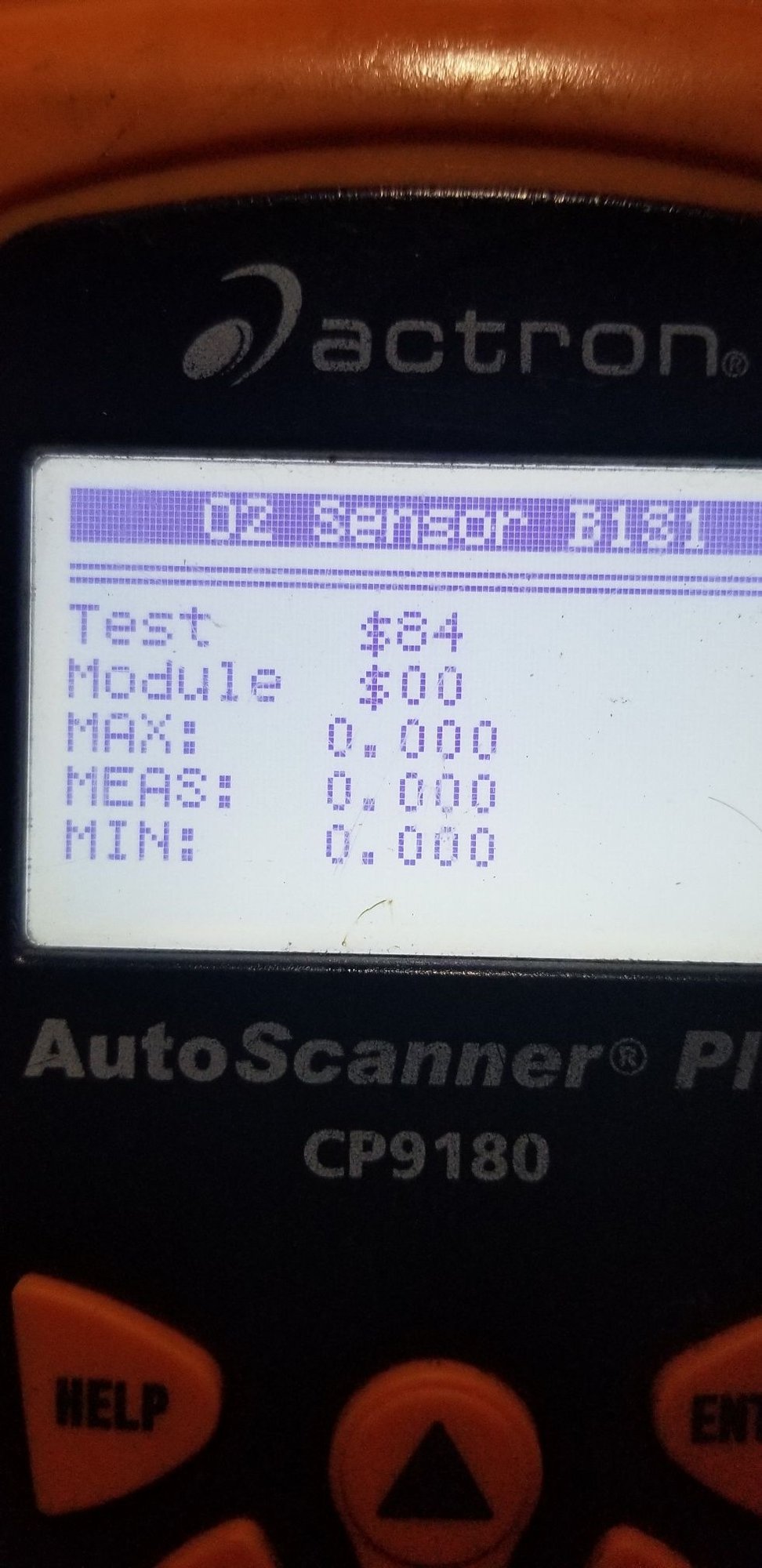

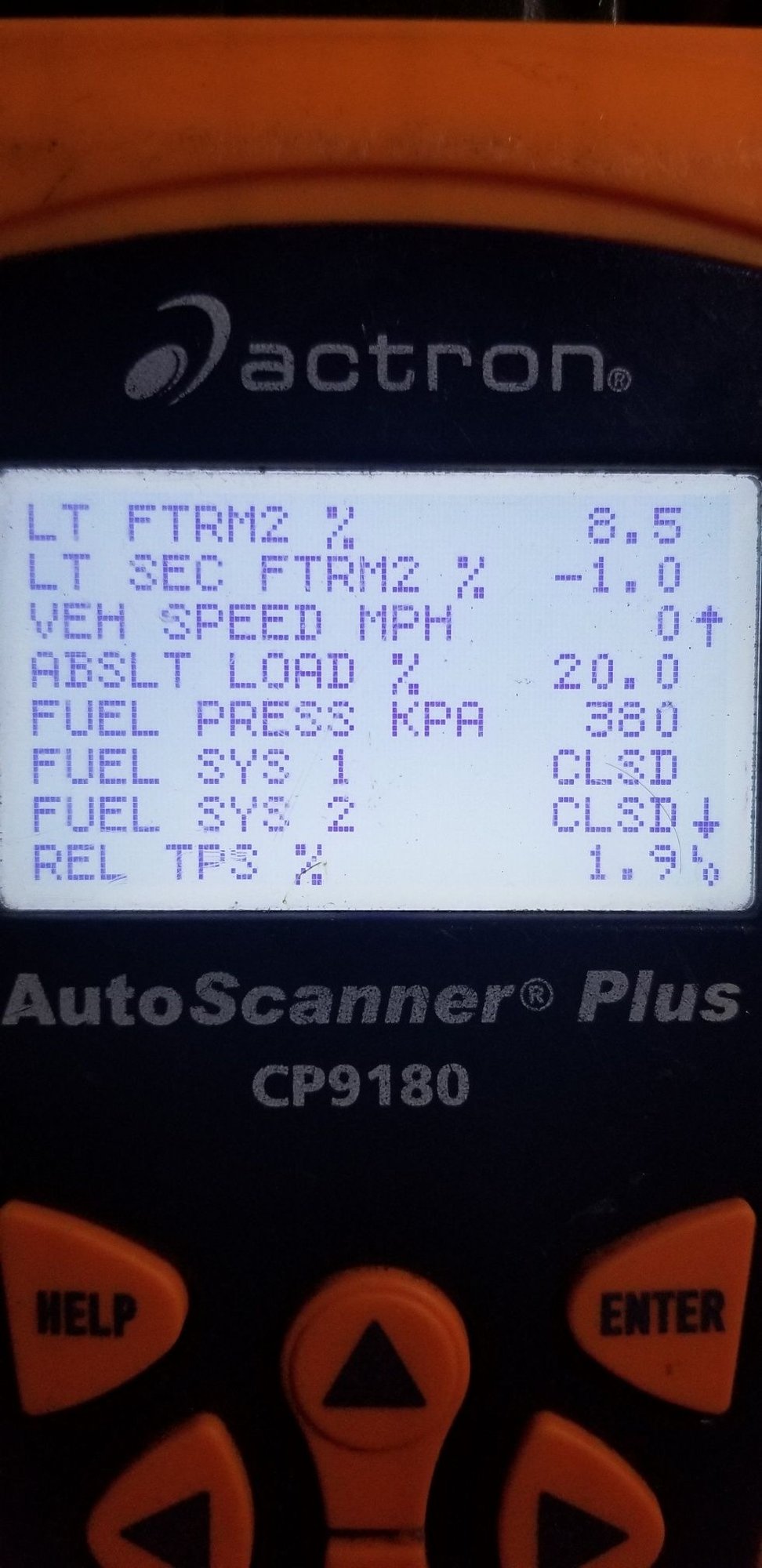

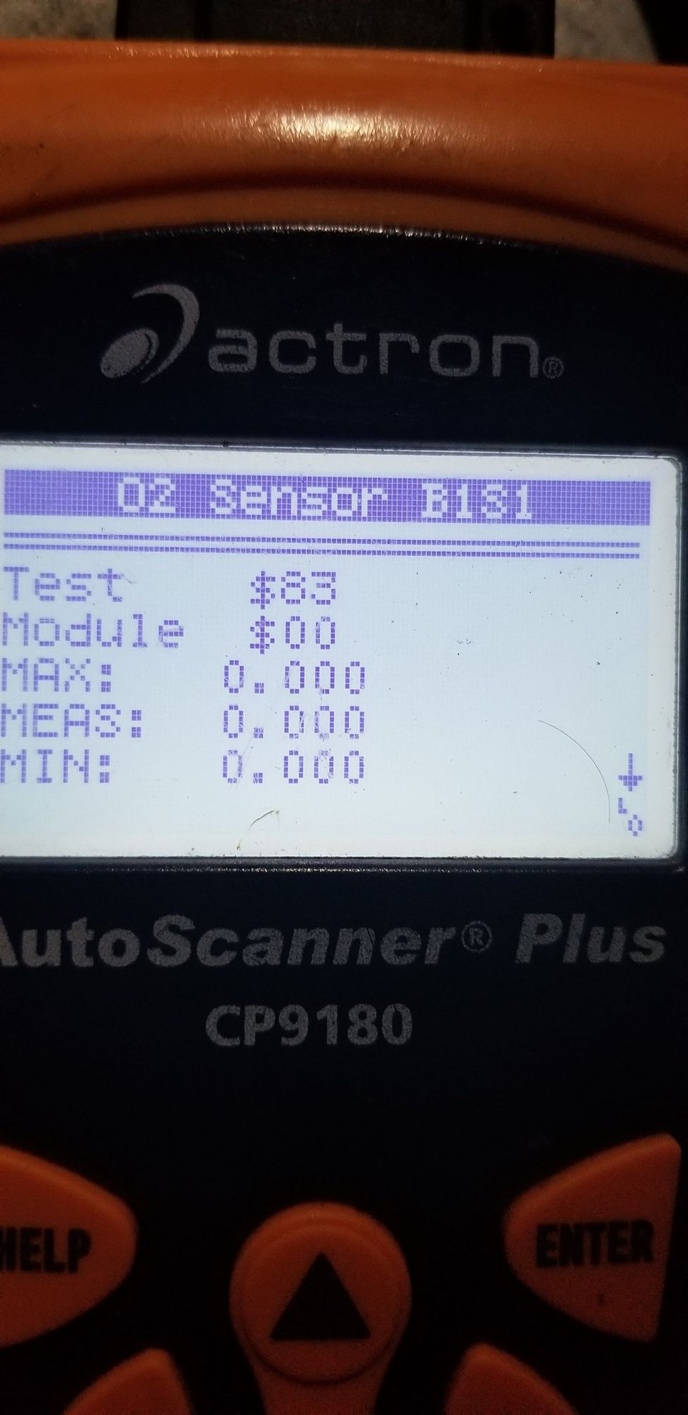

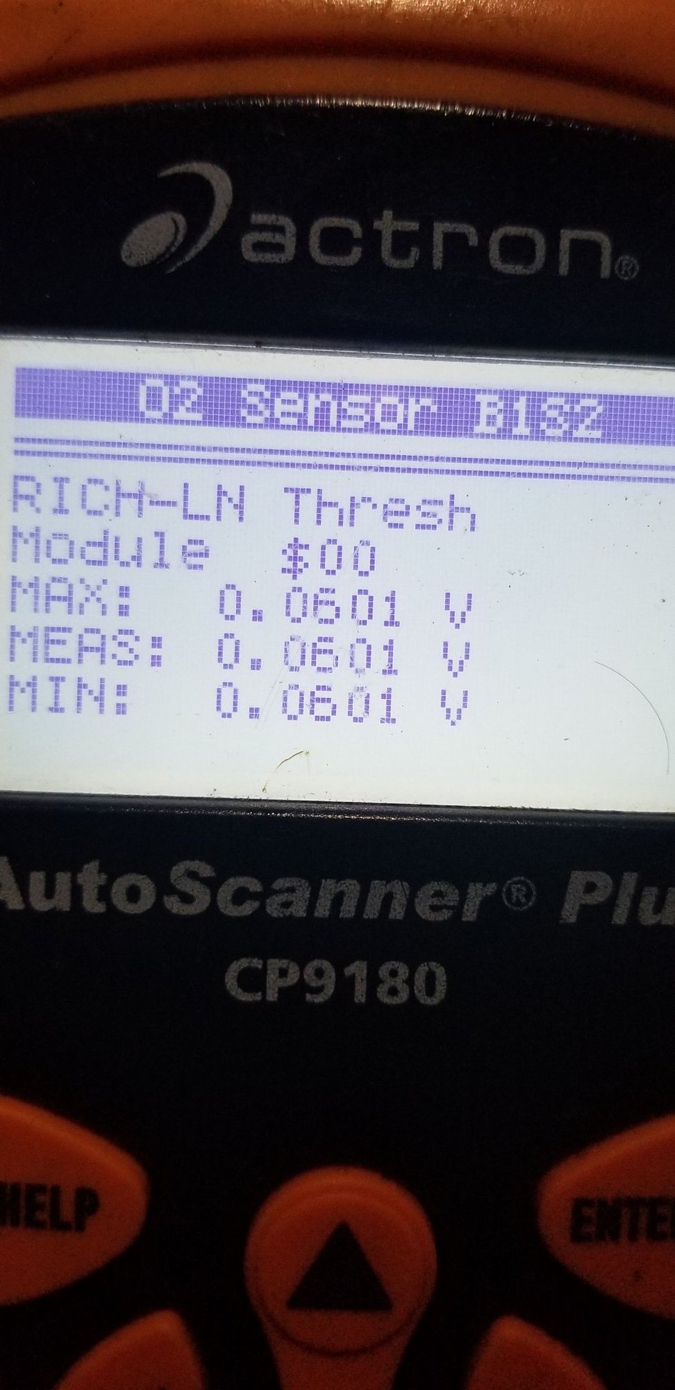

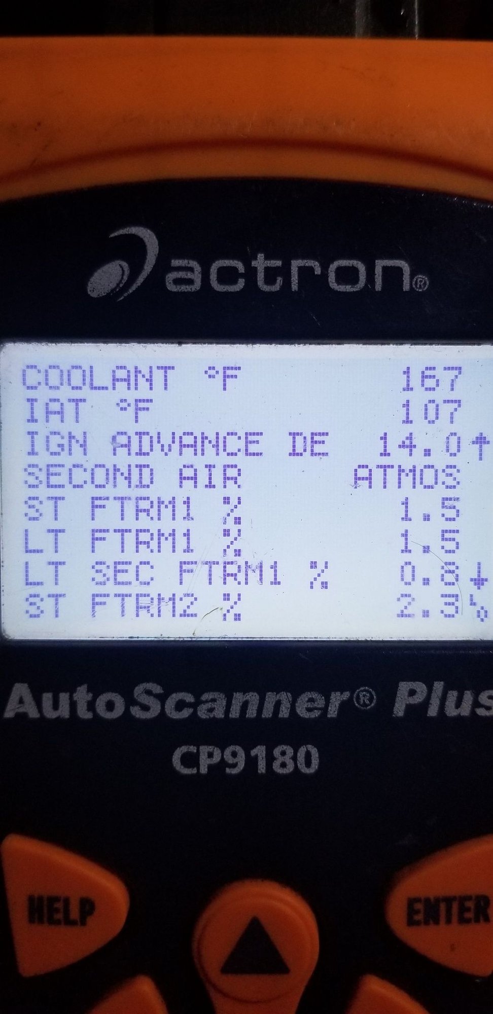

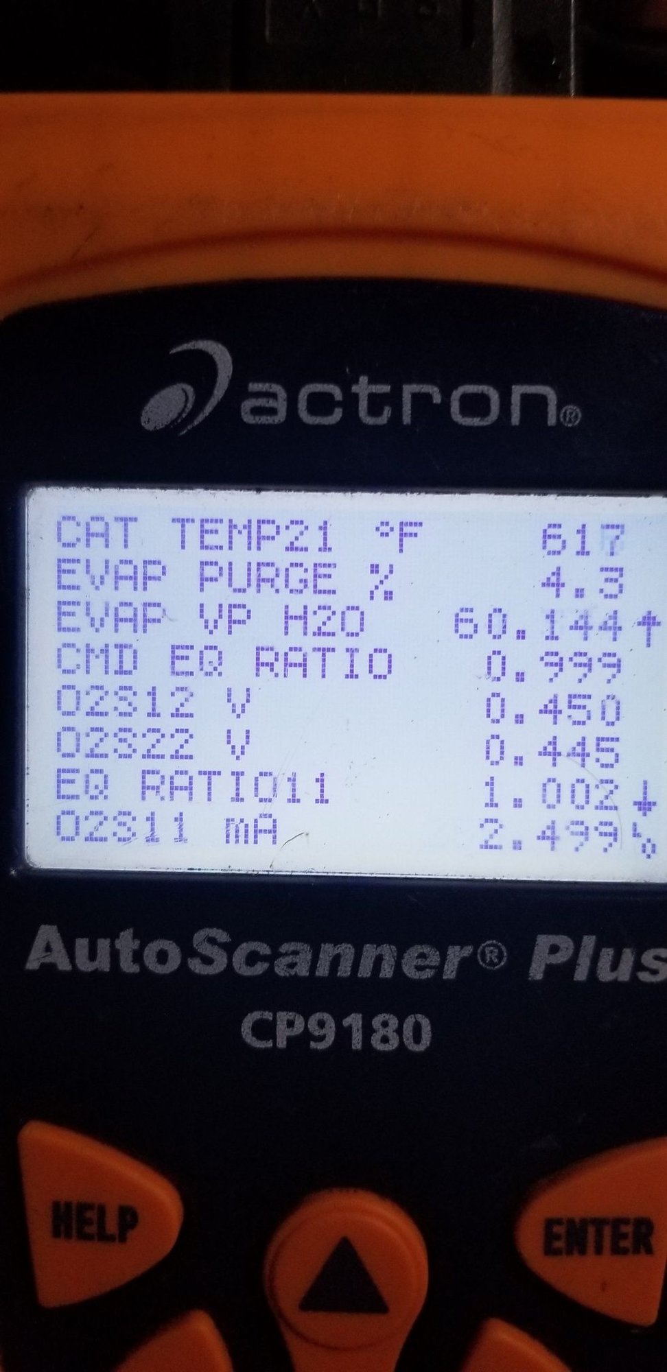

I scanned the car today with my scanner. Can someone look at the data and tell me if anything sticks out. Thanks!

I am not the best at reading this data unfortunately. I just pulled the data from mine and reading seems to match what you have captured. I was lucky that eventually a code popped up on mine as car would run fine and then all the sudden check engine would flash and loose power.
If you clear the code, does the same code come back and does it come back right away?

Is 12.5% tps value normal for these cars at idle?
The 02 values while the car is running should be sweeping from .1 to .8 after the car warms up ( that's 100mv to 800/850mv) if one is locked at lets say 490 then that sensor is fouling. The cat temps seem to be within range. Some of the other data my brain won't process at the moment. Fuel pressure seems low if DI unless it's reporting the feed pump pressure. I'll go run live data on mine to compare as my car doesn't want any of my money at the moment.
