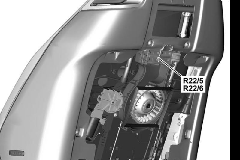

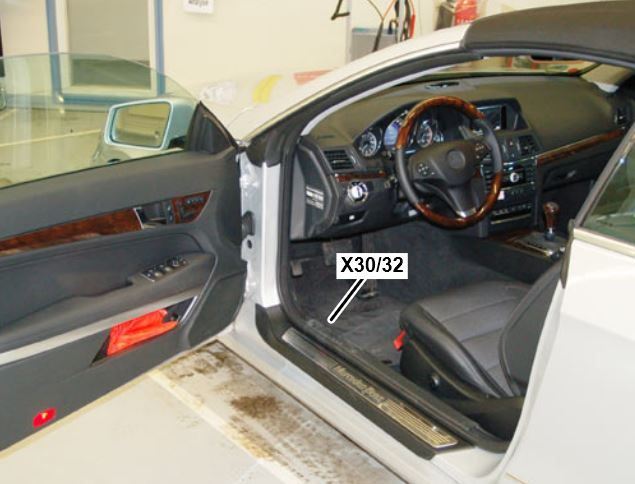

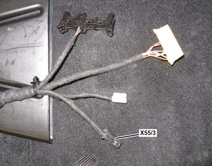

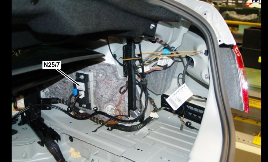

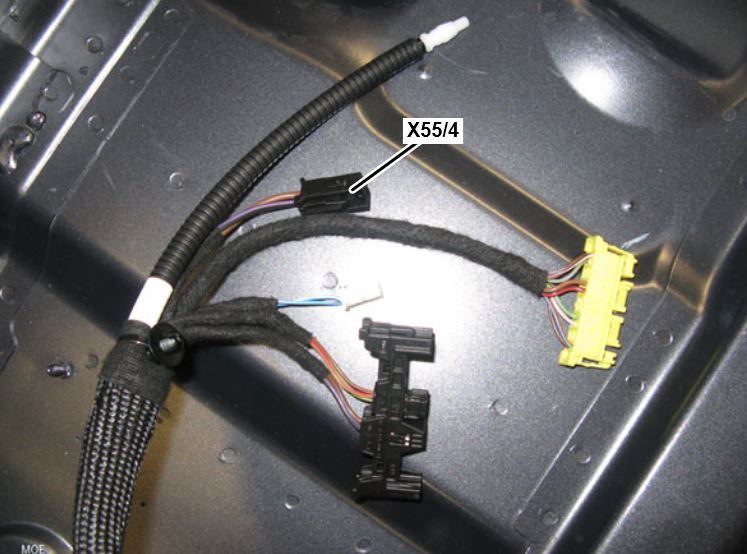

You have covered some but these would be things to check:
- CU
- Heating & fan in seat
- Floor wiring distributor (LHD - left, RHD - right)
- Under seat wiring

Wow I cannot thank you enough for this comprehensive information. I can see the airscarf controller you have shown its location I can see the white and Blue plugs I pressure they are for the left and right seats ? would swapping them over rule out or confirm if the controller is at fault ?

ok so I have managed to resolve my issue. it was after all the connection under the drivers seat its just 2 wires. the core of the wires had become exposed and shorting out. I removed the plug cut the wires and use heat shrink around the wires and soldered back together issue resolved.

I also had similar problem and I solved it by replacing Airscarf control unit that was in the trunk behind the trim
I
posted information about that on my website: https://blogpavel.com/2021/01/30/airscarf-fix/
Airscarf module part number is: A1729000402
