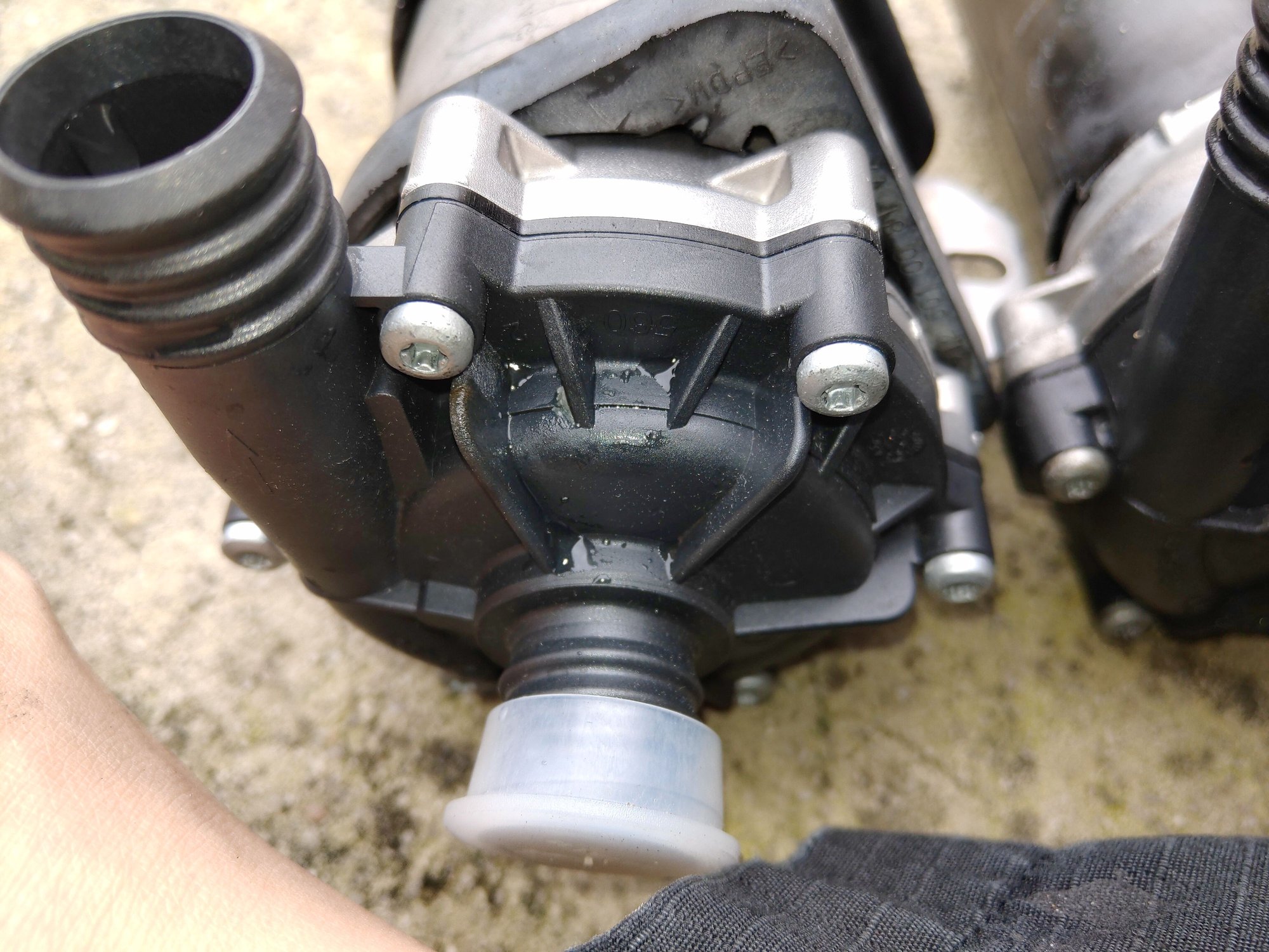

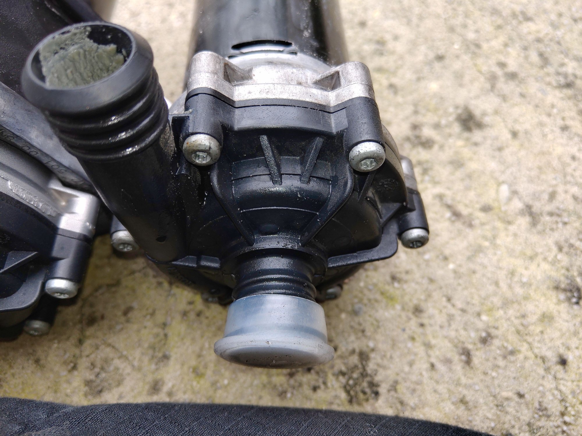

Well, got it out.
Surprisingly, the part number for the original pump looks the same as the AMG one.
There are some differences.
​​​​​The spacing of the ribs is wider on the new pump, and the color of the metal near the connector is darker on the old pump.
