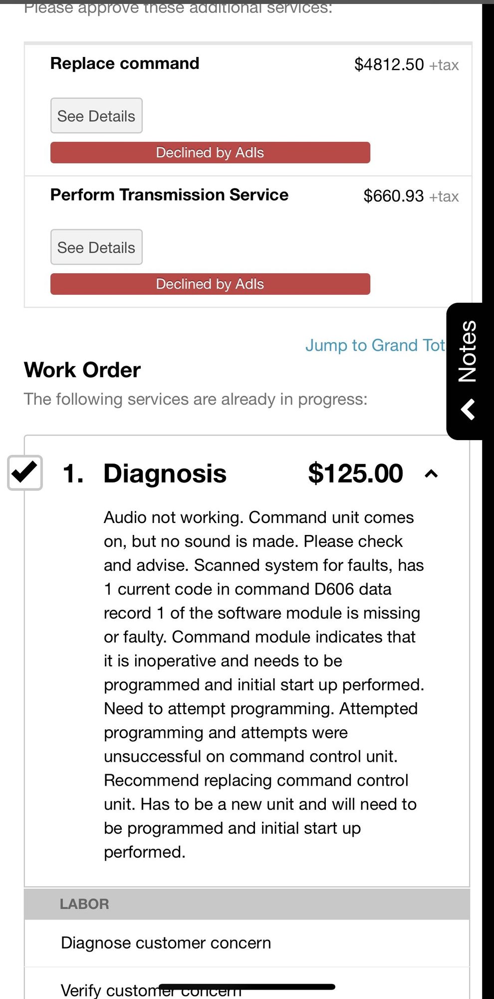

Does anyone know if I can replace my COMAND unit with a used one? I know Mercedes will most likely need to program it. But if you guys take a look at the price of a new one below, it’s insane to pay $5000 for one from the dealership to have it installed.

Alright, so I called 3 different dealerships and they all said you have to buy a new one. Once they’re added to the car by VIN they’re married for life. It’s supposed to be some type of security thing with Mercedes.
The head unit was working but was broken by Mercedes Benz of Manchester NH, and they obviously know they screwed but so they’re not willing to fix it. They even kicked me out of the dealership and said not to come back.
so I plan on trading the car in. It’s unfortunate because I still owe a lot and I’m going to be upside. Just goes to show that these cars aren’t for people who don’t have any money to waste when something breaks (me)

Thanks for the information man, at least now I know if they ask me to buy a brand new unit with a ridiculous price I will tell them to **** off.
Gonna take my car to MB dealership for a diagnostic in few days and hope they can just revise the unit software. Will post the resolution and result so that if anyone in the future has the same problem know roughly what to do.[/QUOTE]
I don’t believe your COMAND unit is actually dead or broken. Might just be something else on the fiber ring. Your AMP breaks? COMAND unit won’t work. Your emergency satellite box breaks? Your COMAND unit won’t work (at least for sound). This is because all of those devices are in an optical loop.
I would bring it to them and say you only want them to diagnose it for 1 hour only. Update you on what they find, and then if they say it might be the COMAND unit have them update it and or have them test the fiber.
