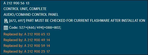

Here are compatible replacement part #s to shop used, current being 2129002517. BTW 207 should be posting here: https://mbworld.org/forums/e-class-c...brio-a207-141/

Try these guys for a replacement unit or repair: https://fastoem.com/index.php
Careful with used, you'll need someone with tools/software (MB dealer will not) to release the theft protection from unit and pair it with your vehicle.
