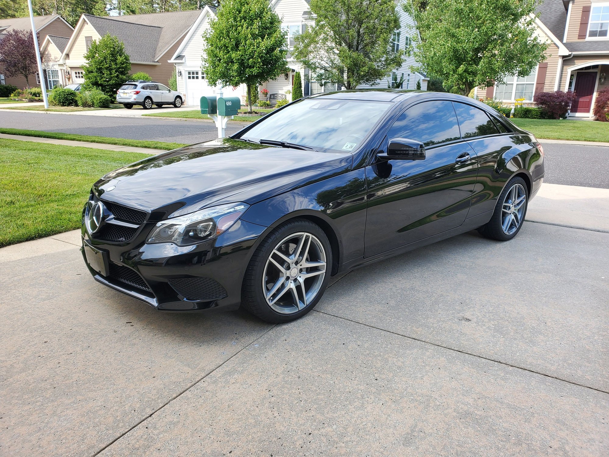

Each to their own aesthetically, but I think the ride-height on your car looks great. I'd love to have it on my sedan. It is lower than the sedans and looks very similar to an E63 to me. The gap below the arch is less than the gap to the sides of the wheels. It's low but balanced and elegant.

I have to admit that from what I have seen, the ride height is pretty balanced looking as you say. So I agree with you. It is lower than coupes I've seen with out this option. I am planning on going up to 19s in a few weeks and was looking for 3/4" lower ride height. But I'm ok with it stock if no one makes a kit. The fender gap is pretty respectable. The ride compliance is awesome. Sporty handling (almost flat in the curves) very little body roll. It rides better than any coupe I've ever owned and at the present time I need tires. The ride and handling will improve when I make the move to 19s and new tires.
