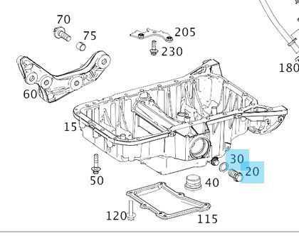

I have been changing oil on my cars for over fifty years. This is the first time that I can not locate oil drain plug. Is there one on 16 E350 4 matic, or must it be vacuumed out? Have removed all three road shields and even cleaned my glasses. At a lost .

Check side of upper oil pan: screw plug is part 1119970330, seal ring 007603014106.
