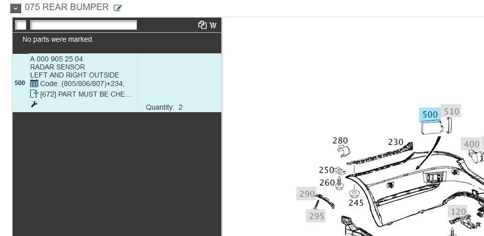

Check sensors/connections in rear bumper, see attachment.

Are you not getting any warnings on the cluster about it? My car recently gave me the "radar sensors dirty" and "blind spot unavailable" warnings on the cluster while I was driving to the dealership on an unrelated matter. They scanned the car and ended up updating the "A90 software" according to the RO, which lists this software as pertaining only to the radar units for BSM and CPA+
Just throwing that out there. Normally on the W212 what we hear is corrosion on the BSM sensors.
