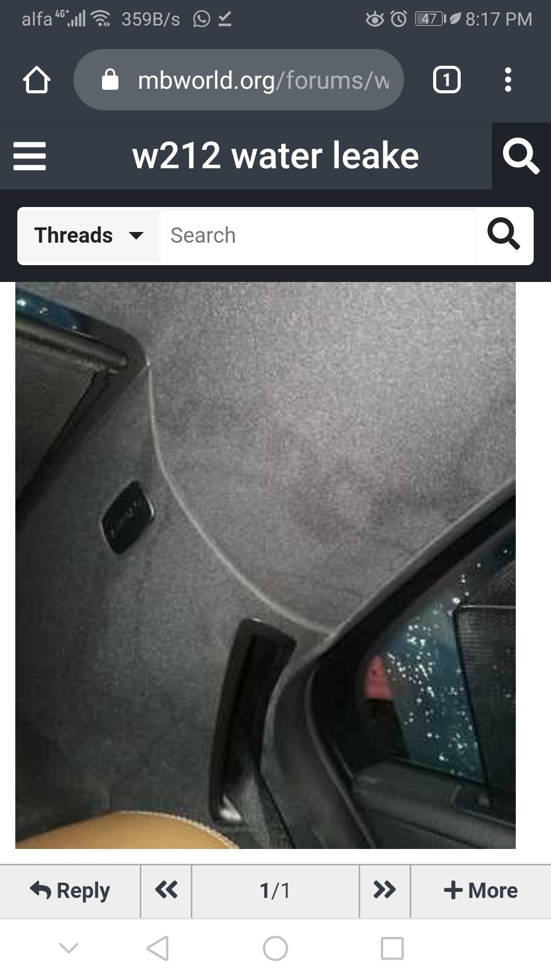

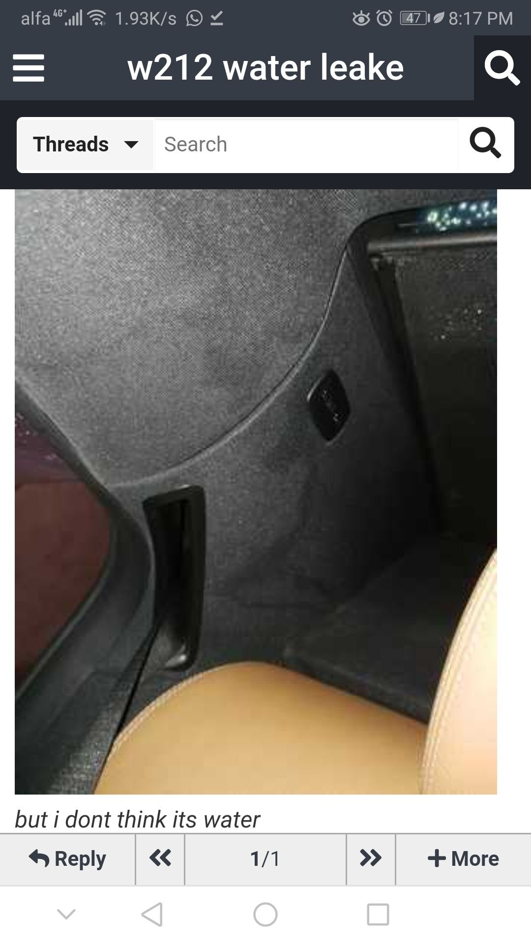

How to remove back interior pieces
He please can anyone mention konigstiger
I want to remove those and i don't know how
I want to check if there's a water leak

See attachments.
File Type: pdf
File Type: pdf

You might be able to find one on Youtube, also have you checked your sunroof drains? Might be a thought, they could be clogged?
What is the best way to check them?

I believe you open the sunroof and pour a small amount of water into the drain channels to see if it comes out the bottom of the car, if not you can use low volume low air pressure to blow them out, then try the water again, its my understanding there are four at the corners of the sunroof, that's my best guess and an easy place to start.
