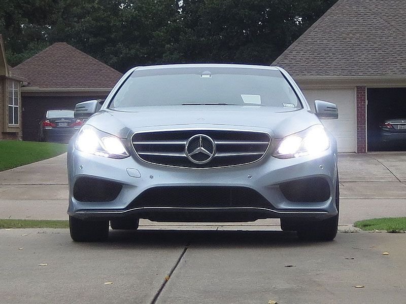

If you bought a 2014-2016 facelift, at mere minimum, you have 5K LED low beams and 3200K Halogen high beams. These can be upgraded to Phillips Diamond Vision H7 Halogens equal in 5K brightness to the low beams simply by replacing the bulbs.
Amazon Amazon
No faults, errors, etc, just white light. You can buy LEDs for the high beams, but there is no need to do so. The LED aftermarket beams available have huge heat-sinks attached to the back, for which you will need to make room behind the headlight housings. Not easy to do, and results vary wildly, so be forewarned.

My only goal was to eliminate the yellow light in the high beams, recognizing that I seldom use the High Beams, and really shouldn't care. The Diamond Vision solution noted above accomplishes this, as the light is bright white, matching the Low Beams. So I rate them as excellent.
This was the very first "mod" I performed on my car, almost 3 years ago. The lights have held-up well as High Beams, as I live in a Suburban area, and have very few occassions to burn the High Beams at all. The only trick to installing them is to be certain you handle the bulbs with tissue paper to keep your finger oils off the glass. Just $25, one and done.
Xenon headlights are nothing new... I could have bought them as new on my first Mercedes... in 2001. Yawn. The Intellignet Lighting system is interesting, but not remotely worth $4,000 to install them, and trouble-shoot unknown electronic issues that follow. An idea that's DOA to me.
