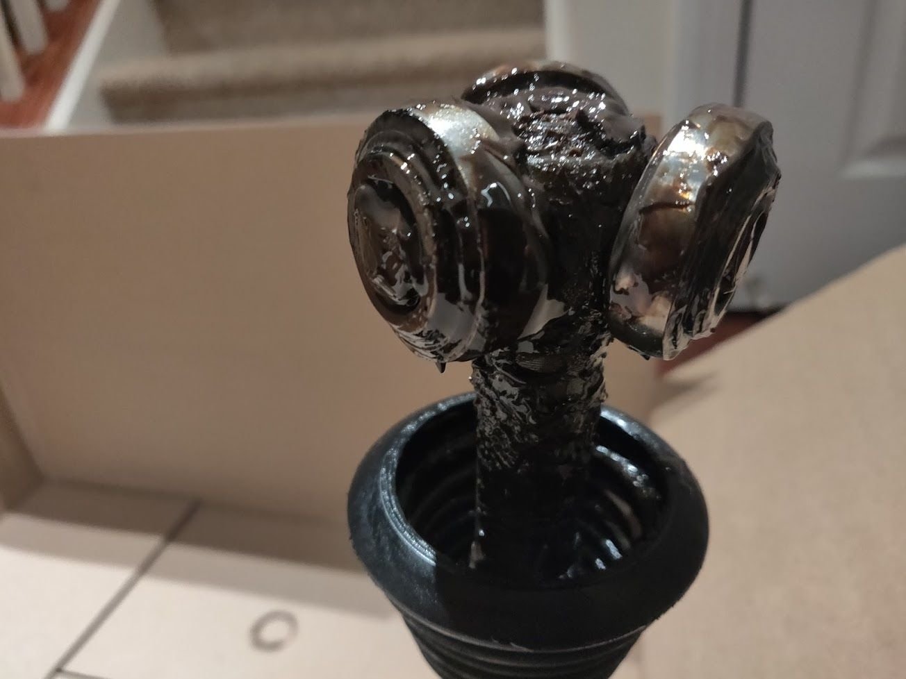

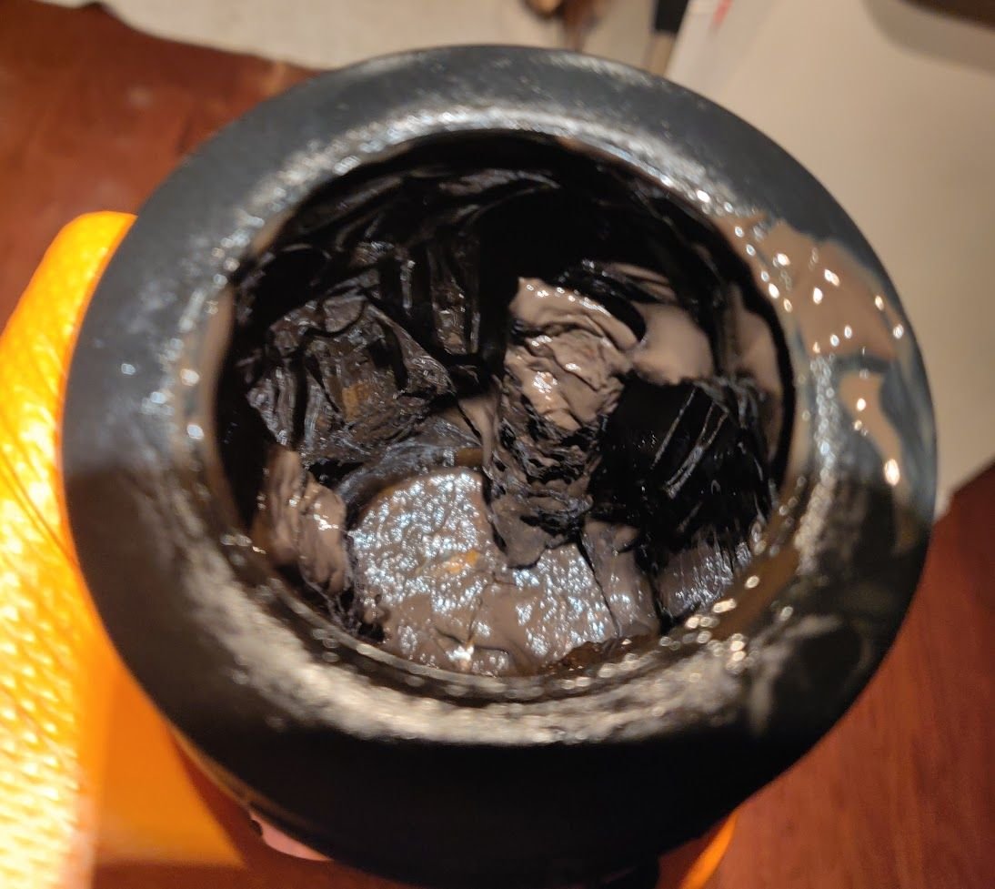

I was replacing my wheel bearing and while pulling things apart and about to put things back together, the cv axle fell to the ground. I'm assuming it's not suppose to come apart and this boot is one and not two piece? Do I need a new axle? If I do need a new axle, how do I get the other piece that is still attached to the car out? I cant seem it get it out.
Old Feb 8, 2021 | 10:19 AM
bmwpowere36m3's Avatar
Joined: Jun 2020
Posts: 1,363
Likes: 1,012
'11 E350, '11 E550, '98 M3, '95 E320
Looks like you popped the inner joint apart... common "mistake". The piece left in the engine just needs to be "pulled" or pried carefully outward. There's a snap-ring, which "holds" the splined end of the CV joint inside. As far as reassembly, you'll need a new boot kit which Mercedes sells, which will include the boot, crimps rings, grease, etc...

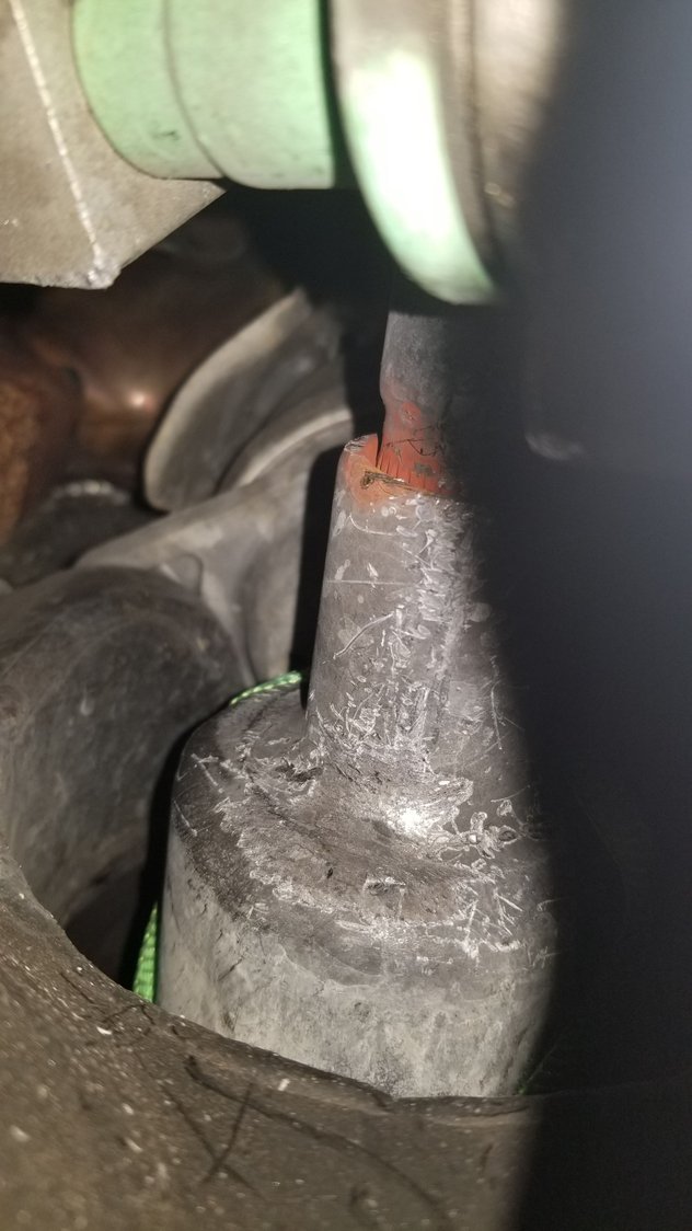

Old Feb 15, 2021 | 12:22 PM
0430usmc's Avatar
Joined: Feb 2020
Posts: 20
2010 E350

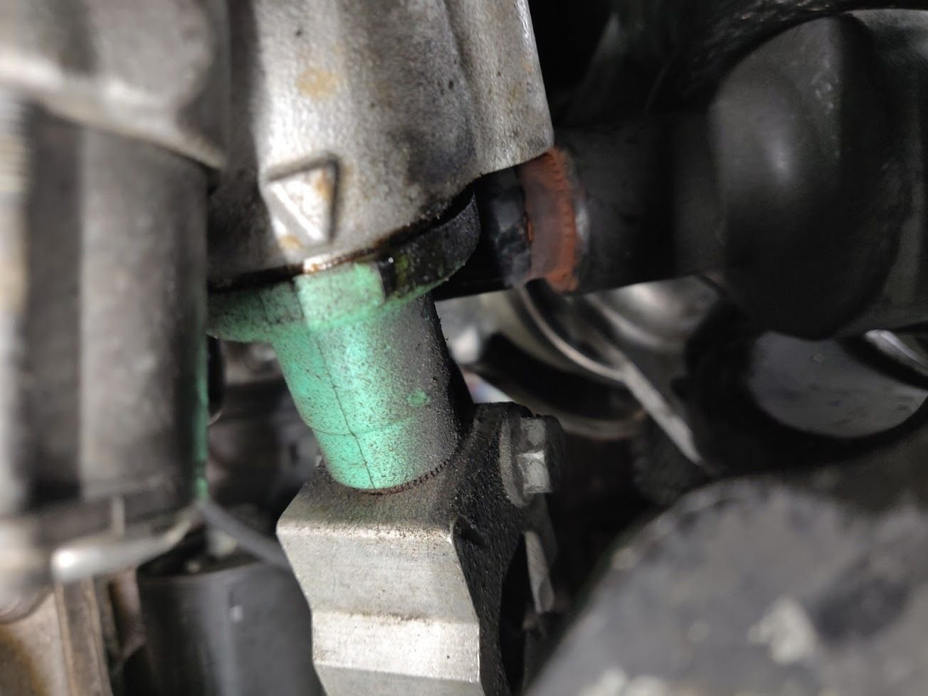

What am I doing wrong
What am I doing wrong. I trying to get this off with a crow bar and 3lb hammer and it's just not moving. Any ideas?
Old Feb 15, 2021 | 01:41 PM
Joined: Jun 2020
Posts: 1,363
Likes: 1,012
If the axle is seized to the intermediate shaft, then the whole assembly w/ intermediate shaft will need to come out. Try spraying penetrant at the splined interface and consider getting a slide hammer puller to "shock" it out. Take care, as you may damage the oil pan if overly aggressive. So if that fails, then the intermediate shaft and axle will need to come out.

The weird thing is, it actually moves about a cm back and forth by my hand bit I cant get it to move any further no matter what I do.
Old Feb 15, 2021 | 03:14 PM
cetialpha5's Avatar
Joined: Feb 2014
Posts: 6,190
Likes: 1,550
From: MA
2008 E350 4Matic, 2011 E350 4matic

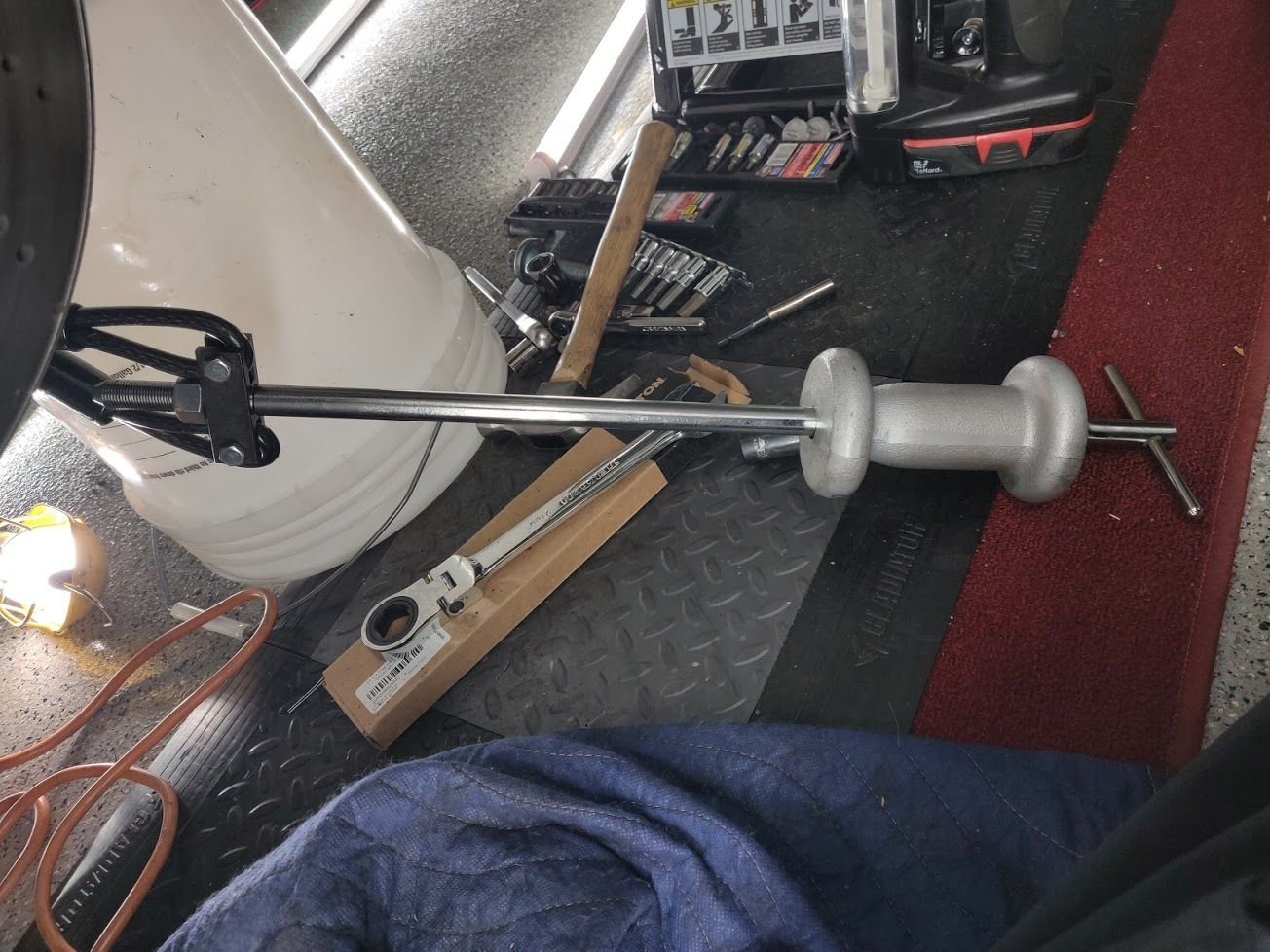

Time for a bigger hammer. Try that 5 pound slide hook hammer. Used that to take out the axle when replacing the axle seal.

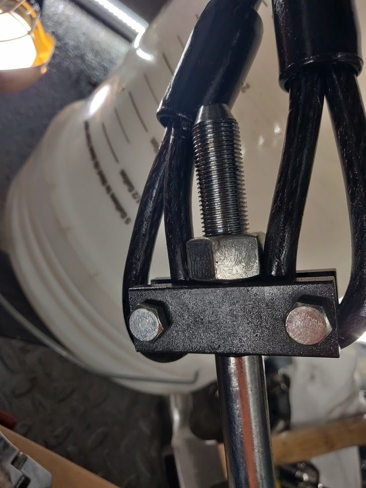

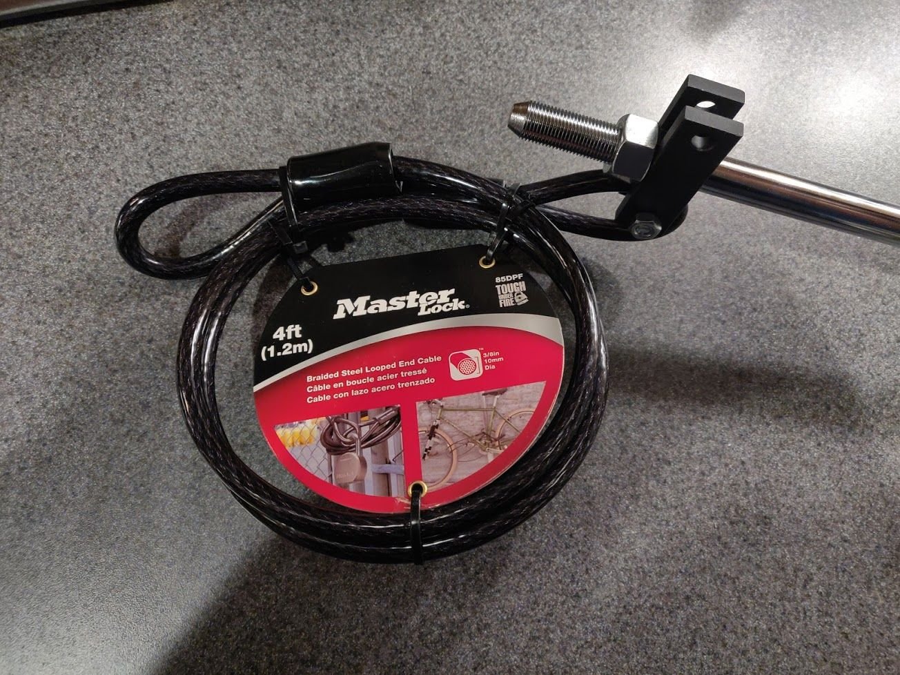

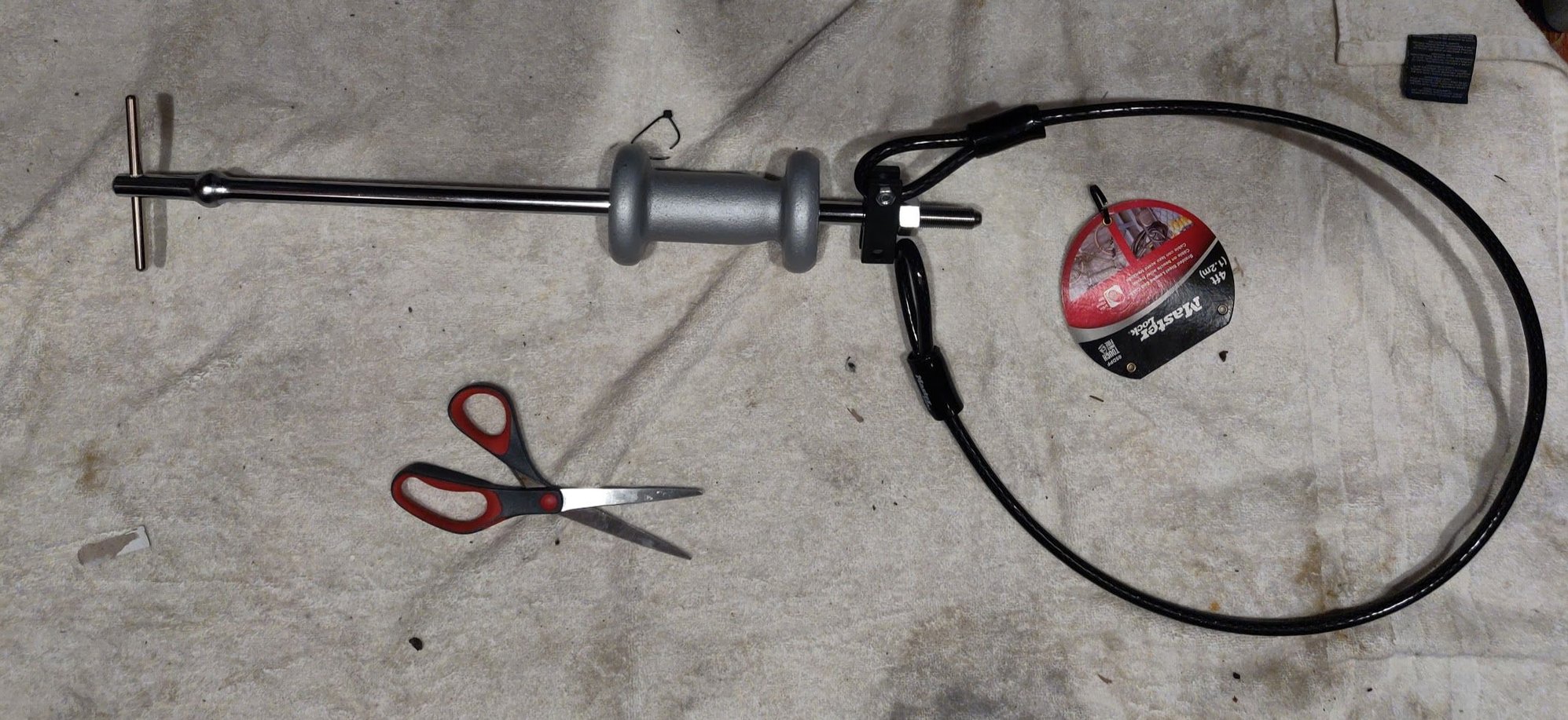

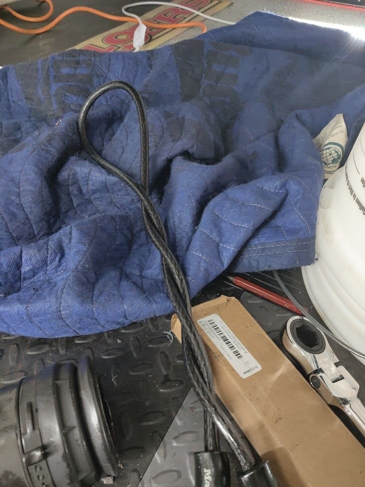

Old Feb 19, 2021 | 08:26 PM
retna7's Avatar
Joined: Jul 2006
Posts: 277
Likes: 77
From: Alexandria, VA
2000 E430 Sport

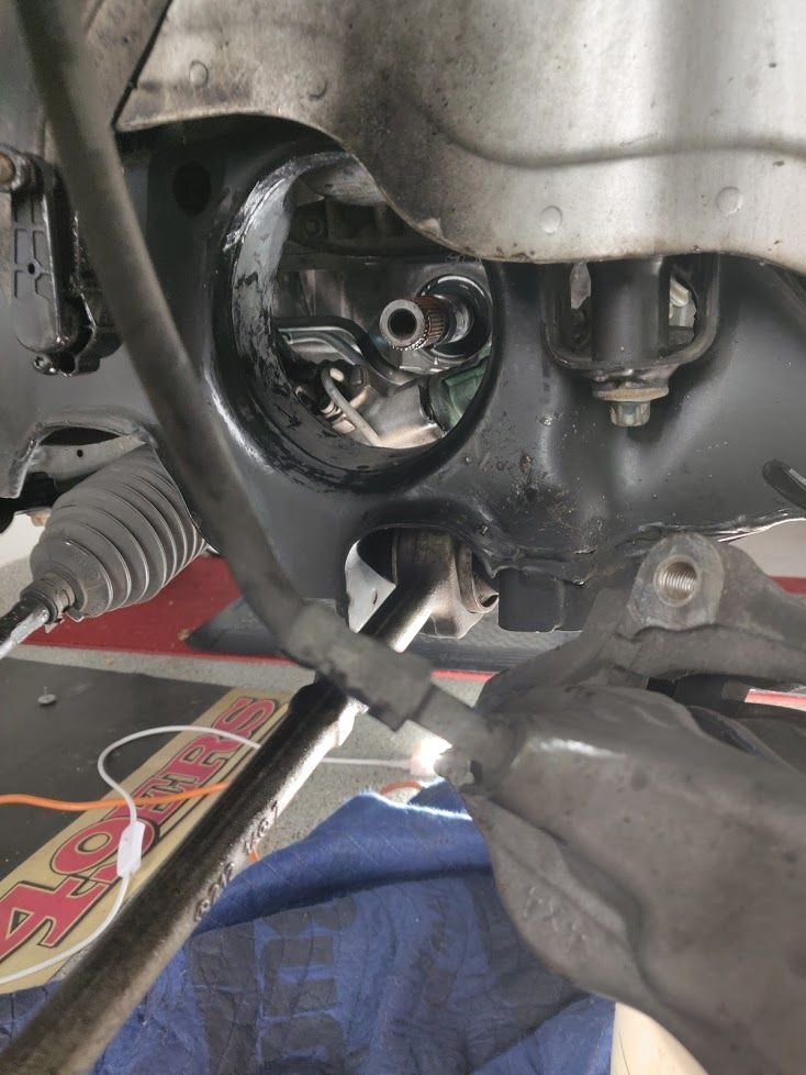

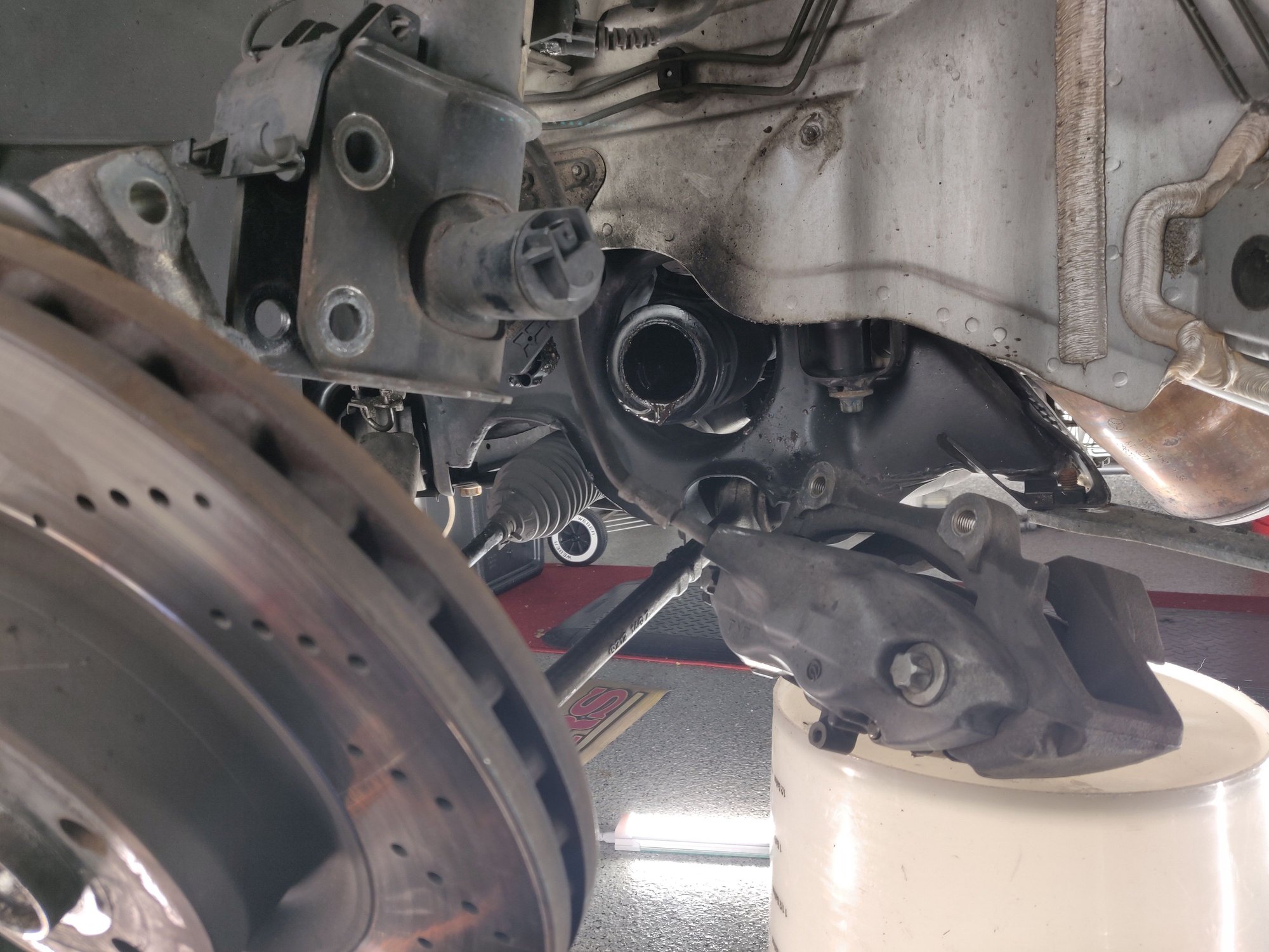

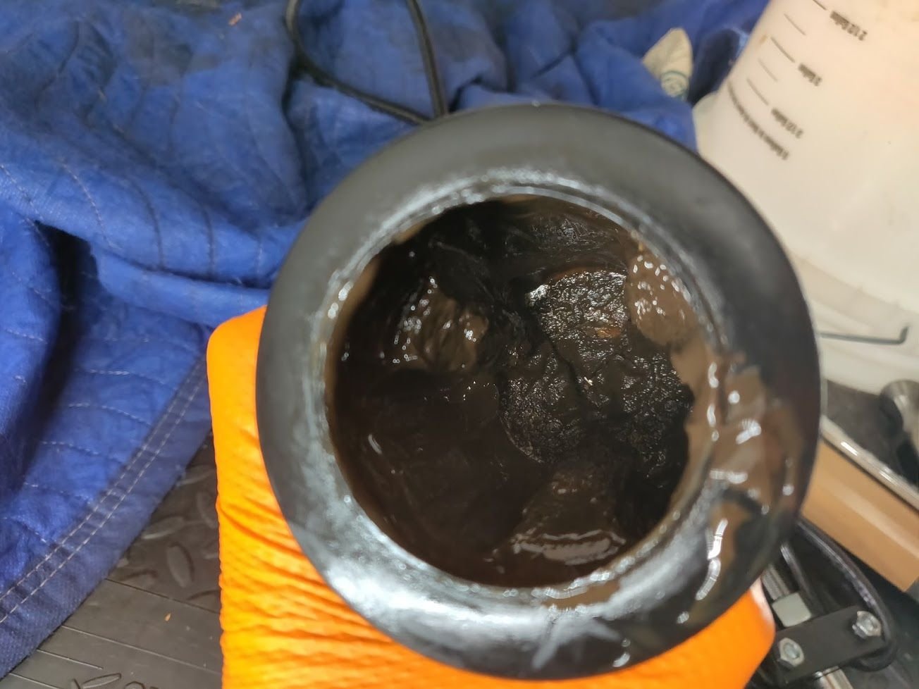

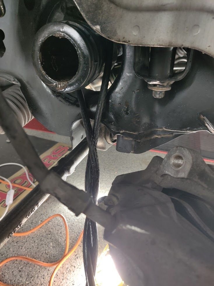

Old Feb 22, 2021 | 12:11 PM
retna7's Avatar
Joined: Jul 2006
Posts: 277
Likes: 77
2000 E430 Sport
Old Feb 22, 2021 | 08:28 PM
Senecan's Avatar
Joined: Feb 2021
Posts: 138
Likes: 67
1983 Nissan SHlTBOX
Love the ingenuity. All downhill from here. Congrats.
