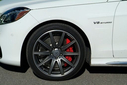

Hey everyone, I have a 2014 E550 4Matic. I also have the 19" e63 wheels as shown below: I have a question on tire size.
I was hoping to run size 245 35 19s on the front and 285 30 19s on the rear to keep the diameter as close as possible for the benefit of the 4matic system. I explained this quandary to the tire shop. The shop recommended just ordering the factory e63 tire size of 255 35 19 on the front and 285 30 19 on the rear (instead of my 245 35 19 front tire choice). The factory sizes result in a 1% difference between front and rear tires; whereas my selection of the 245 35 19s results in a smaller, .4% difference in diameter. I selected this size with input from others on here (thanks KEY08).
This tire size (255 35 19 front) and wheel combination was available on the e63 S AWD vehicles so I am wondering if in selecting the slightly better matched 245 35 19s, am overthinking it? Thoughts?
