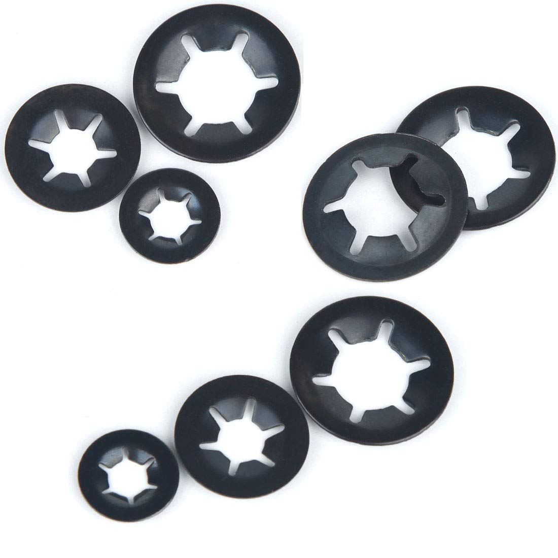

Superglue is useless for this. A good fix is to grind the ends of the three pegs under the cover and remove the star. Then open the holes slightly on the cover and then use good 2-part epoxy in the holes with the pegs. When you open the holes you get epoxy all around the pegs and then when you make a “blob” of the epoxy underside between the pegs/holes the star will not come out by itself.
Problem with the way mb makes these is they melt the ends of the pegs under the cover so the pegs mushroom and won’t fit thru the holes so the star is fixed in place but the melt ends of the pegs break off due to engine vibration and the star is free to fall off.
Good epoxy won’t break and even if the blob of it did come off there would still be epoxy in the holes holding the star in place.

Examining my engine cover on the underside, there is a rectangular tab on the star that sticks through the cover at the 12 o'clock star point. Thinking I could squeeze some epoxy into the area behind the tab, I gently pushed the tab in -- slightly -- and the star instantly popped off completely. Boiiingg!
The three pegs at the center of the star are about 1/8" long... not enough to hold the star in place by themselves.
So, I will now enlarge the holes as Arrie suggested and apply the epoxy as recommended.

Emblem should come with 3 plastic fasteners but I agree with DFW replacing them with metal star washes may be best.
