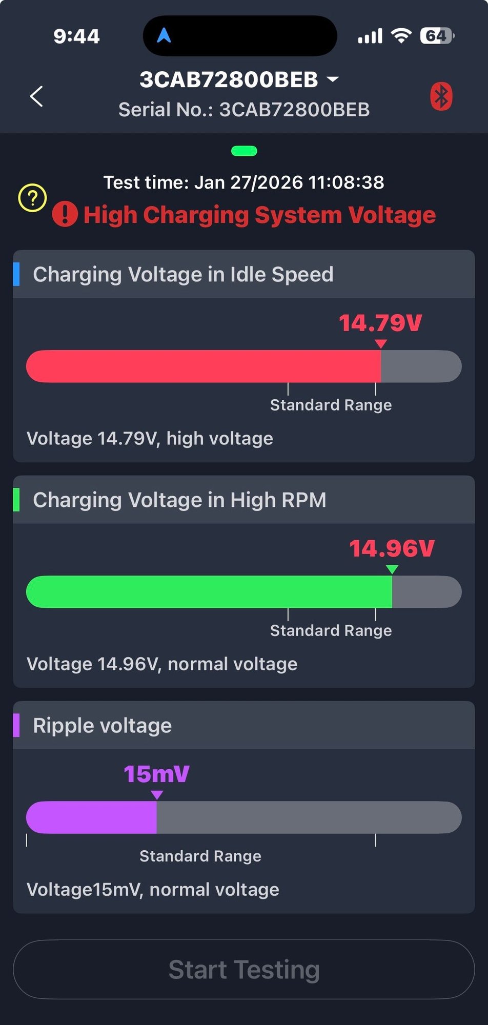

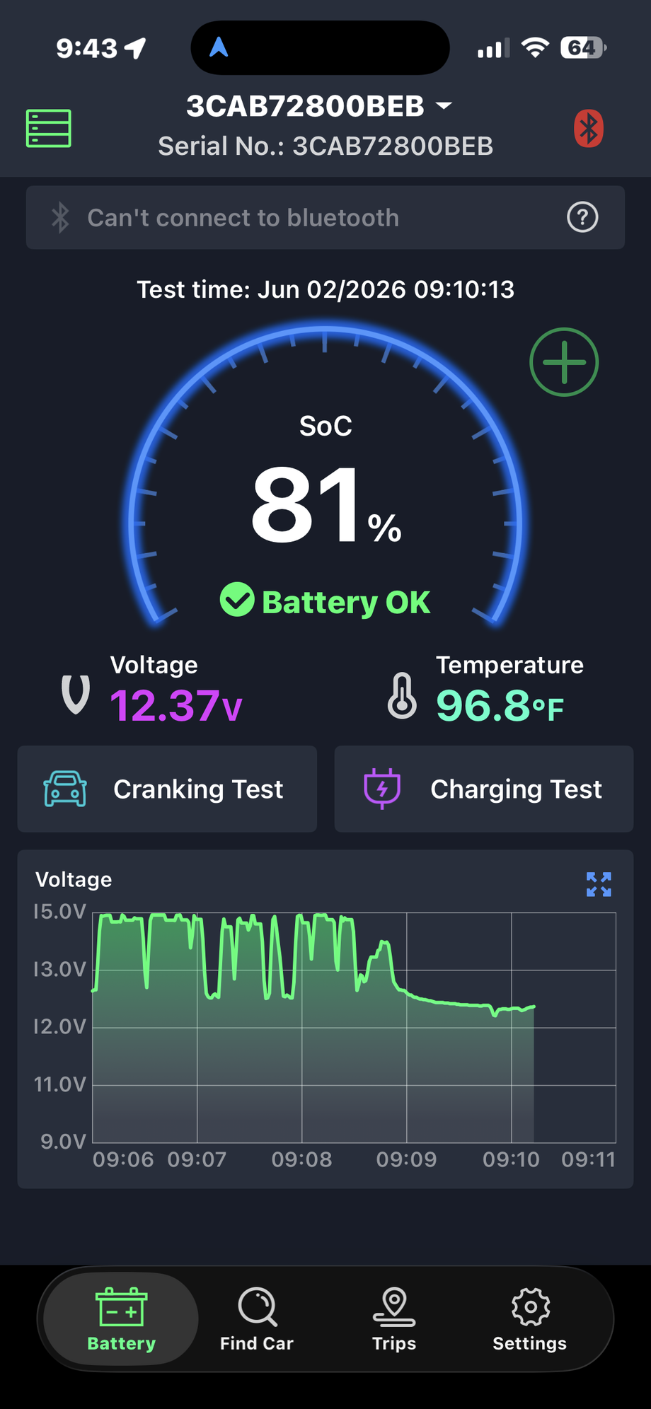

Battery AGM 5.5 years old. Charges up to 100% with charger CTEK. In a week not driving it’s at maybe 12.5v . But driving I monitor voltage with a battery monitor, it won’t charge to 100% easily and I see battery voltage jumping 12.5-14.5 over and over . Regulator is a few years old . Alternator and battery test ok. Is it just an old battery ?

Seems normal charging and non-charging voltages. If you're concerned, have the battery load tested at an auto store.

I can see that the voltage output of the Alternator is switching between charging and off. If the START/STOP is enabled then it will do this. Also the Alternator may be turning on and off so that it is running when decelerating or going down hill and then turning off when accelerating or climbing a hill.
To know what is really happening you need disable START/STOP and run a test with the cruise control on a flat section of highway.

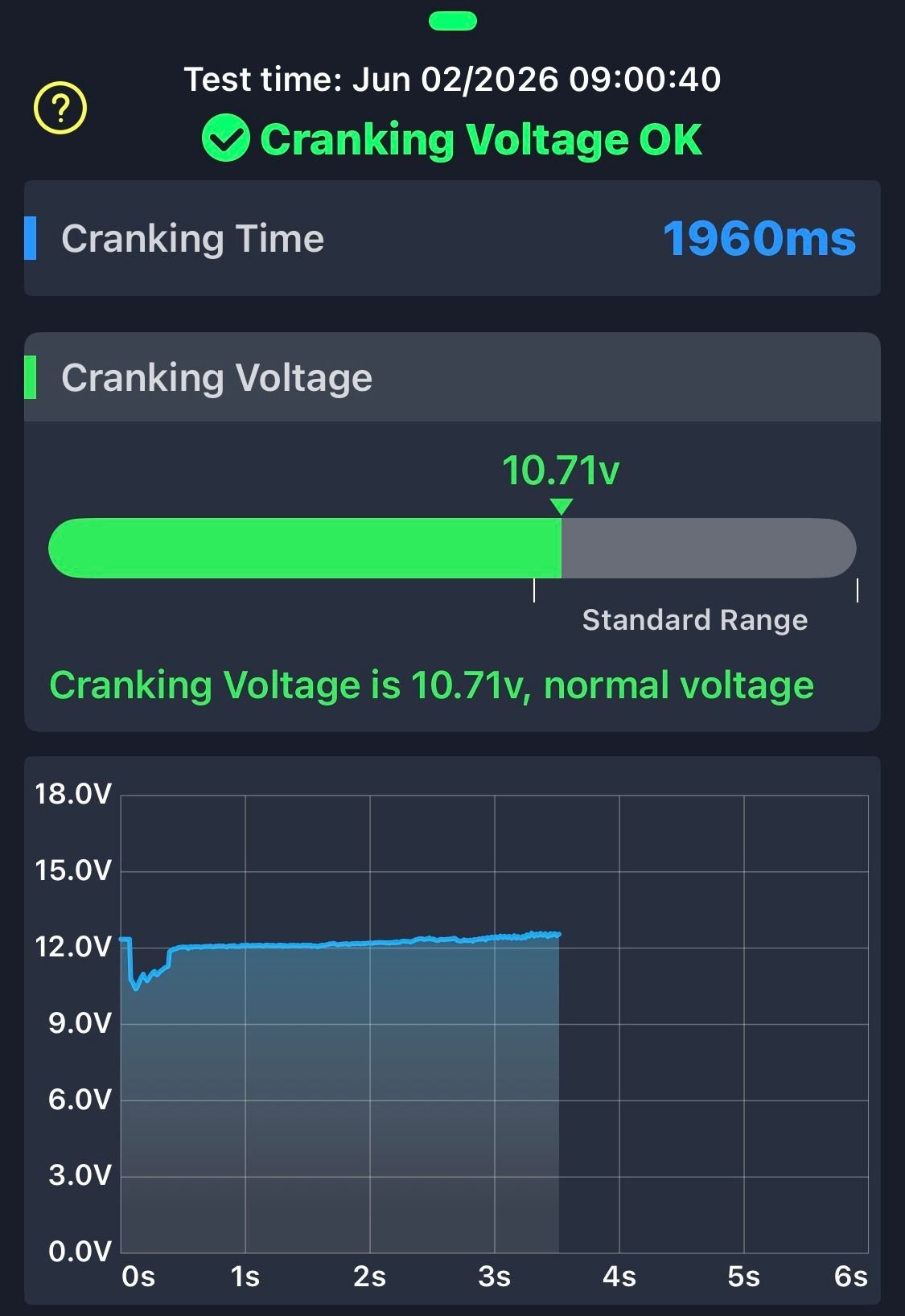

The VOLTAGE DIP when starting looks good
The voltage at idle is slightly higher than the range that your app is looking for. The actual target voltage will vary depending on the temperature of the battery.
Based on your data I wouldn’t be concerned about the battery or the Alternator.

Following up with some data for reference
This data is from a post I made on a different forum 5 years ago
LR2________11.07 Volts (New battery)
A4 2.0T_____10.64 Volts MFG --> April 2019
328i________10.20 Volts Original battery from 2015
Jetta 1.8T____10.53 Volts Original battery from 2015
S80_________10.52 Volts MFG --> May 2017
