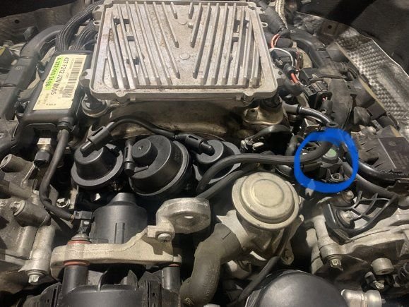

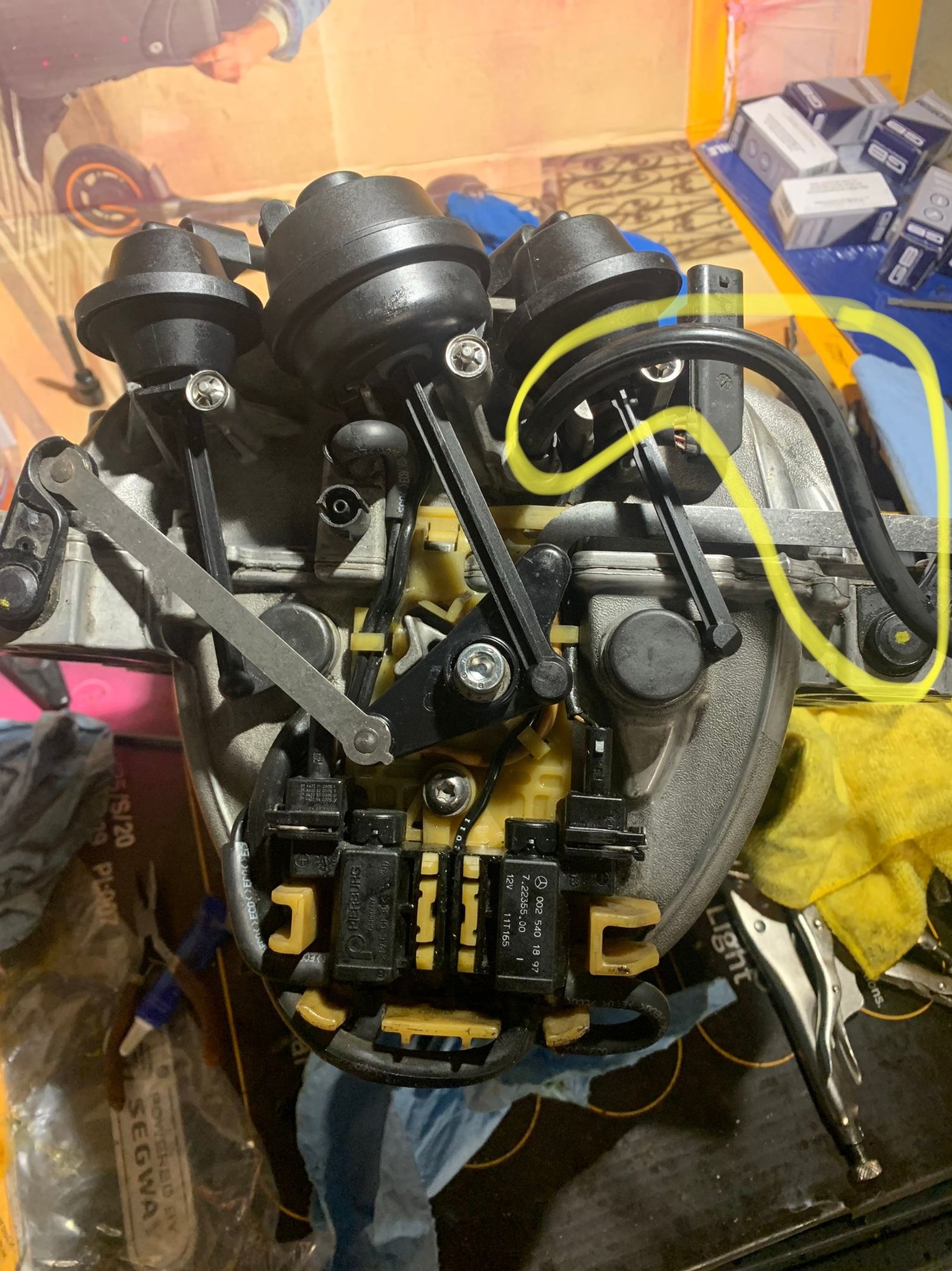

I have repaired the intake arm on my intake but haven’t been able to remember where this vacuum line goes. Any suggestion?
Vacuum line marked in yellow. Where does it go?

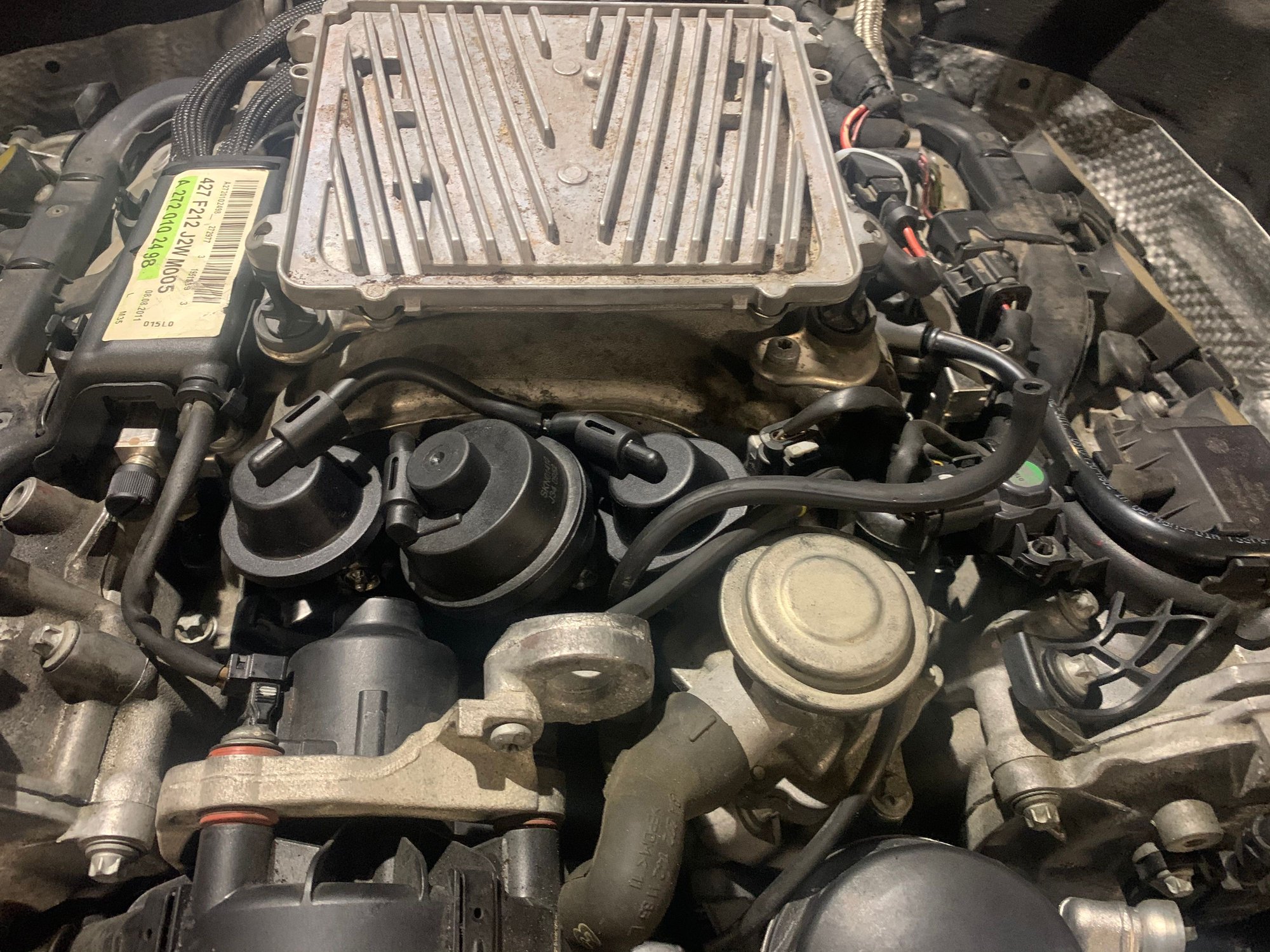

You can see the extra line at the bottom of the ecu

Check the underside of the sensor with green sticker
that was it! You are the best thanks!

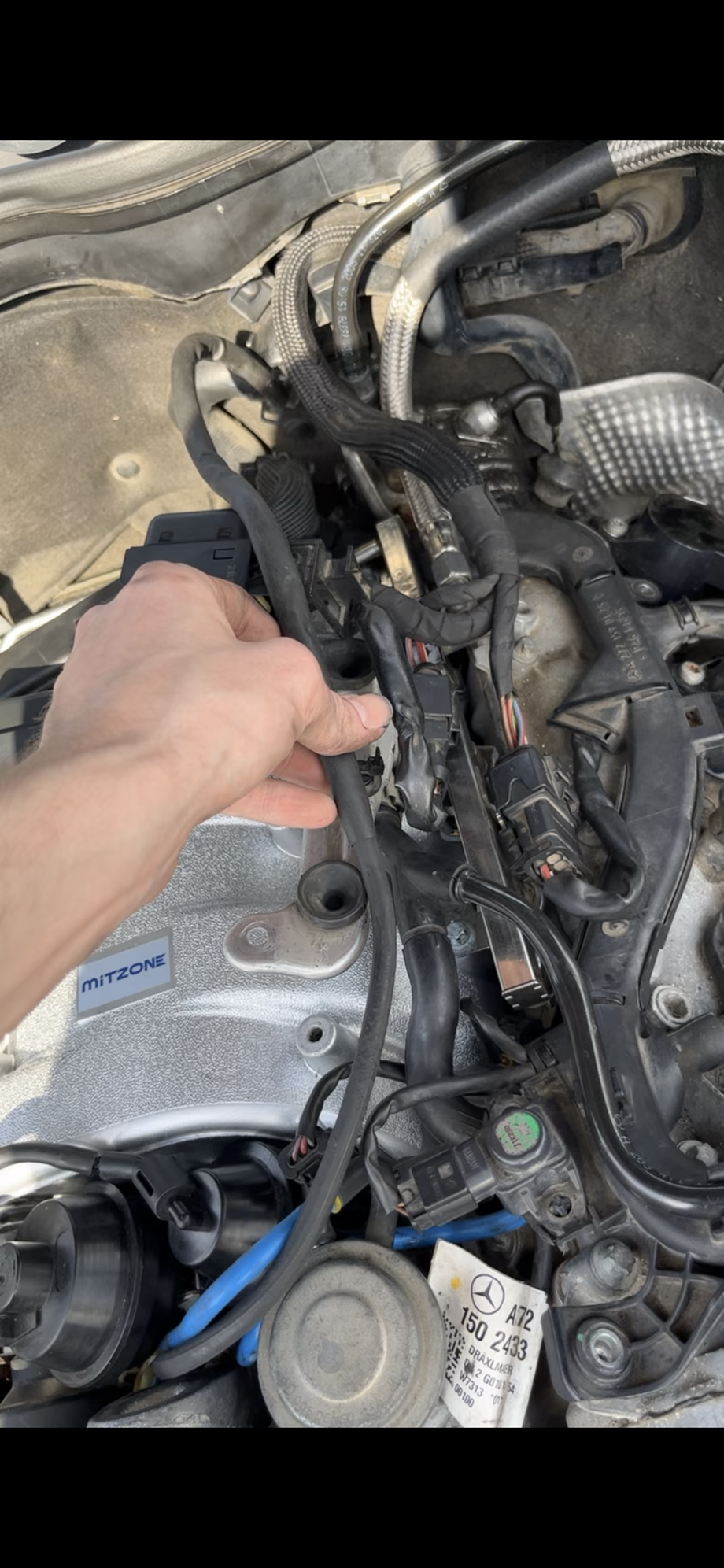

M272 vacuum line
Does anyone happen to know where this vacuum line goes in the m272 engine? I did intake manifold and this is the only line I forgot to take a picture of before I took it apart
