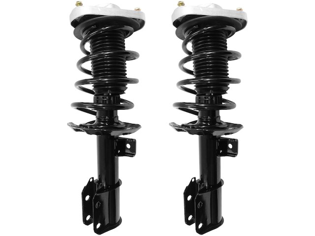

The difference is the front... 4matic struts have a different attachment to the knuckle vs. 2wd models. The typical macpherson arrangement with the 2 lower bolts and 1 upper pinch is not the case for 4matics.
which of those would be the 4matic?

in theory
In theory wouldn't these work? I'm just curious as all hell now, theres tons of them for the rwd models with the standard 2 spaced bolts and pinch and tons of these also but why can't they fit the 4matic sedans if the mounting points are the same as the ones pictured?
Not asking to be a pain in the ***, just want to understand and gain more knowledge. I'm sure the whole issue is with the fronts,, I believe the rears shocks are the same for rwd and awd if im not mistaken.

They look similar, is all I can say... but there's more to it than that.

the non-4matic front looks like this...
