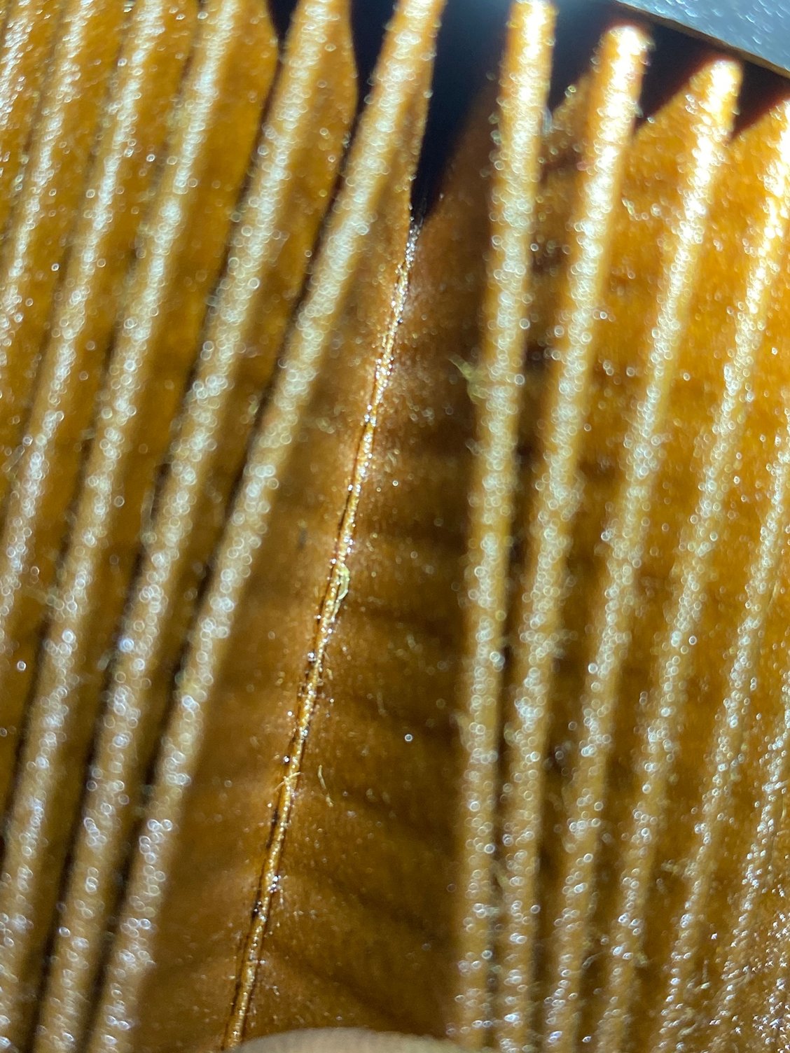

Hello Everyone,
Recently just purchased (2 weeks ago) a 2013 Mercedes e350 4 matic from a dealership with only 93k miles on it, I am the 4th owner and the car is in nice shape with only minor damage shown on the car fax. Before purchasing it I had taken it to my mechanic for a safety check and also to get his opinion before buying it. I end up buying it and the day after I purchased it I had heard a noise in the engine. The best way i can describe the sound is that it sounds like when you put a deck card on your bike and let it hit the spokes as you rode around on your bike. It only last about 5-7 seconds after the car has sat for a bit. I ended up taking it to the mechanic to check it out and doing so i had him change the oil just for good measure. Upon him doing so he had informed me that there were metal shavings in the oil filter which means it had to be in the oil. Also he stated that the oil filter is brand new and someone probably changed it recently (possibly from the dealer?). He also said that the oil was a weird shiny color as if there was water in the oil because of how it looked. He told me he thinks it possibly be the cam shafts that are broken and throwing metal into the oil. I have the oil filter that has the metal shavings in it. Any idea what this can be and what are my options as of right now? Any help would be greatly appreciated.

I'm not seeing a terminal engine problem from your photo... that's not to say there isn't one. Hard to say based on your description. Let your mechanic figure it out. Of the bat, I'd think tensioner if it sounds like cards in spokes. As far as recourse... that's state dependent.

what about the metal found in the filter along with the discolored oil?

Not sure if you think this is a low mile car or not with this comment. That is a lot of miles and right in the sweet spot of when lots of unattended issues pop up. Do you have a full service history (VMI) ?, since you bought from a dealer. They should be able to supply you with that to see just what kind of service this car was accustomed to. You could send the oil to Blackstone for analysis.

Yeah, leaking down lifter or possibly timing chain tensioner. My wife's ML350 has the same engine and sounds just like that for the first few seconds after start-up. I'm not concerned about it

No, meant to say it has less miles than it should for its year. Really more concerned with the metal shavings within the oil and oil filter. Thought the sound could be a contributing factor to why there was metal shavings.

Also I don’t have a sample of oil the mechanic was too slow to act by the time it popped in his head to do so. I do have the oil filter but do you know if they would be able to get enough of an oil sample from that?

the oil sample you really want is whatever was in the engine BEFORE that filter was installed.
