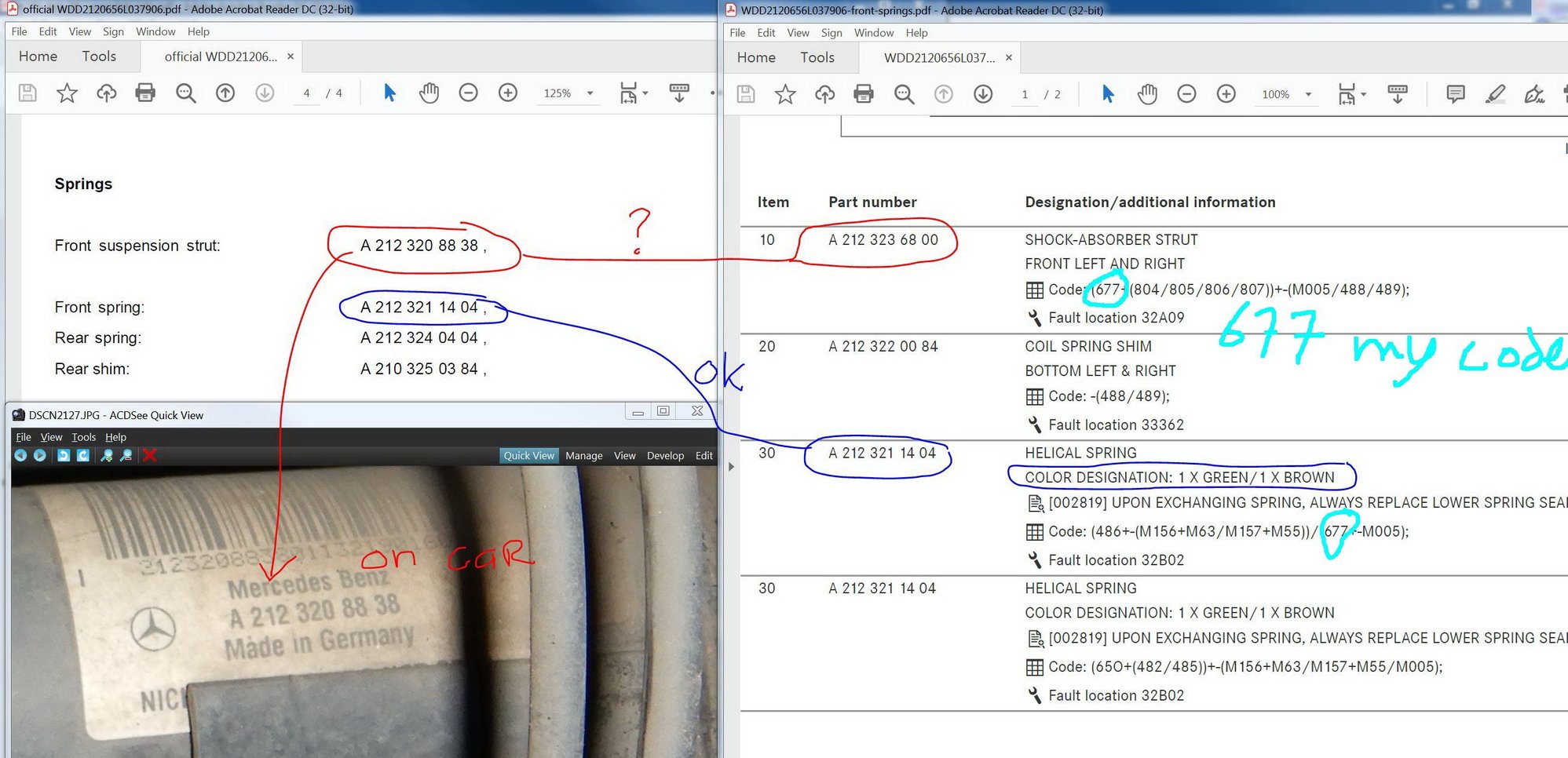

Can you check mine please : MHL212065EJ004768 / WDD2120656L037906 , I am curious if Indonesian locally assembled cars are in that mothership database.
My springs :
thank you.
ADD : https://xentry-shop.mercedes-benz.co...=8796716040334

note that there's two springs listed, for instance, one of them on the rear says "Code: (65O+(482/485))+-(M156+M63/M157+M55/M005)"
you need to look at your data card, that spring is for a car with option 650, and either 482 or 485, but NO options M156+M63 or M157+M55 or M005... the alternative rear spring says 486/677, which means either code 486 or 677
edit: and then, oh geez, both those springs are the same P/N, hah hah. why they do this? who knows.

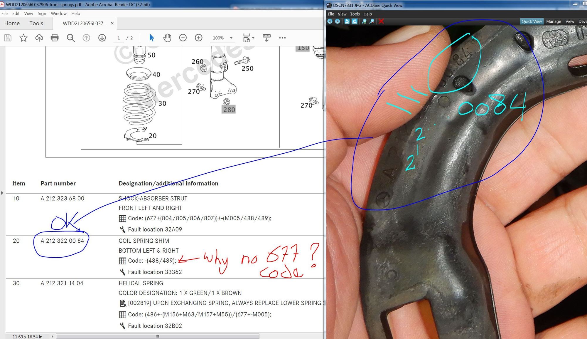

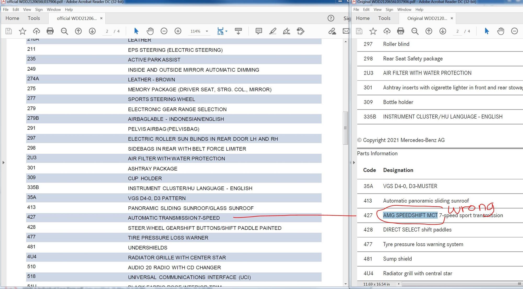

Okey dokey.
Let see. I got Data Card from our guru Mr K a year over ago. I titled it OFFICIAL.
The one from you, I titled it ORIGINAL.
Here are the differences.........
ABOVE. It is true that the rear door blind is manual hand operated and not electric version.
ABOVE. Mine is surely not AGM Speedshift MCT which supposedly has no torque converter.
The way both data cards described the options, the one from Mr K averagely has more product information.
ABOVE. Your data card version I think showed serial numbers... nice, the one I circled cyan, right side one. While Mr K version has suspension data, left side one.
I never pay attention to the rear spring shim, so I do not its actual number.
Front shim is correct P/N, but I wonder why no code 677 included ?
Allright. Thanks again LCG.

re thje speedshiuft thing, I believe there's two versions of the AMG Speedshift, the MCT one is the normal one with a torque converter, while the other one, can't remember the TLA (three letter acronym) has the dual clutch and no torque converter, and is used on the real AMG cars.
my E350 US model 'luxury' has the AMG Speedshift MCT too/ not 100% sure, but I believe the AMG Speedshift part of it is a faster shifting automatic, with the E-S (Econo-Sports) mode button and paddles for manually shifting

if you don't have EPC access (actually, its now called XEntry Parts Information, EPC was the old system), feel free to post your VIN here, and one of us with access can look it up for you.
Hi, sorry for jumping in the thread.I just found my car tilted to its side because a spring probably broke, and I cant order the spring because I don't know which variant it is...could you please help me? The VIN is WDB2110081B09358 I also got installed the ones that raise it's back by about an inch more than the factory ones, should I change those as well?
