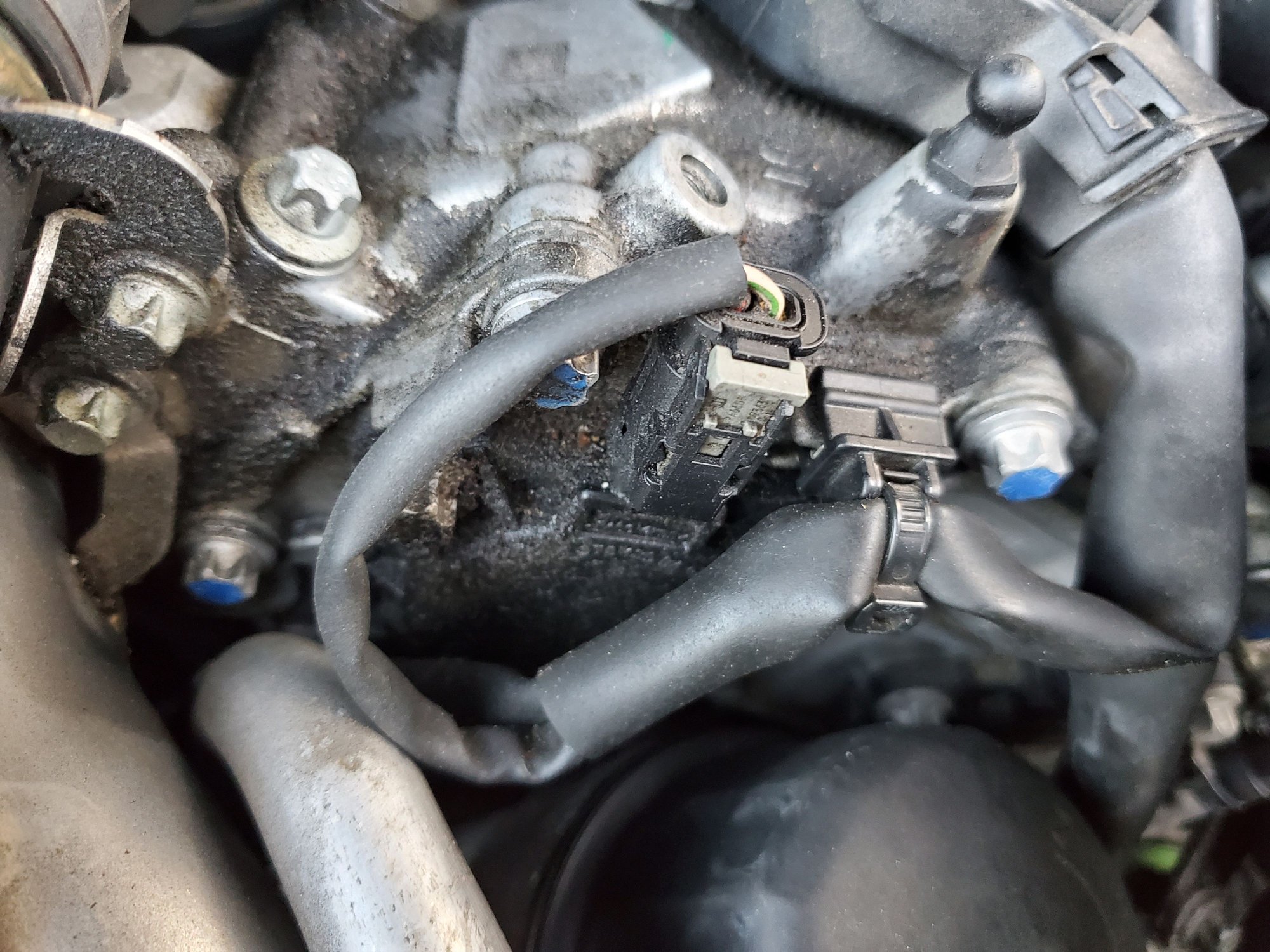

Originally Posted by cleanerPA
I wonder what changed between 2012 and 2014- I can take some photos, but there are two A/C hard lines, the oil filter housing and the charge pipe in the way in my car.
I believe that you are correct to say that 2012 and 2014 are different.
2012 E550, driver's side. Oil filter housing is bottom right.
Notice the AC pipes don't have the bolted connection in the way.
But still tight and required a closed end gearwrench to access bolts.

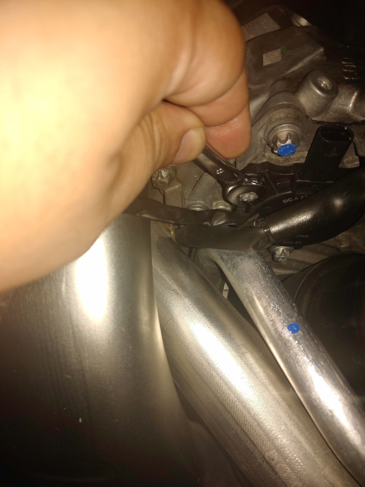

I had the wiring harness pulled back- I took those pictures after I buttoned everything back up because I could not access that bottom bolt. I also had the oil filter housing removed.

If you mean an E8 ratcheting wrench, no. There isn't enough space to put it over the head of the bolt and if I could, there is no way to unscrew it and have clearance to remove the bolt or the wrench. It's that tight.

That's the passenger side- there's less clearance on the driver's side, but I will see if that works- I never thought to try a regular hex wrench on an E-Torx head. All else fails, I can pull all of the stuff as per the WIS.

It will work the were not too tight on my older motor. Do make sure you get new ones, as they will come with the loctite on the threads. Do not reuse the old ones.
The wrench hugs the bolt pretty good.

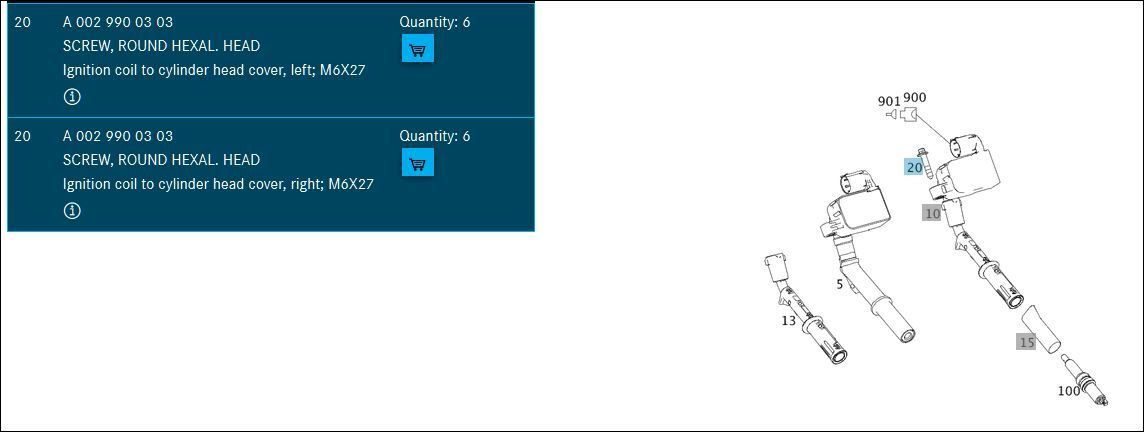

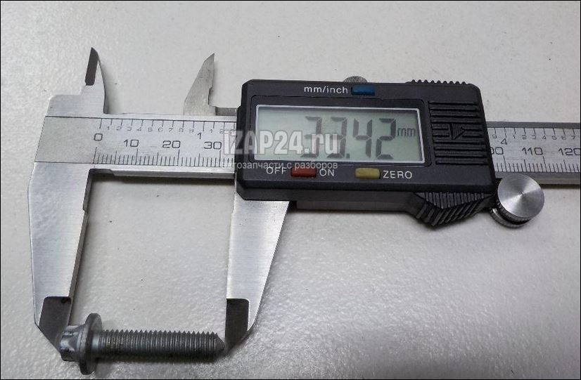

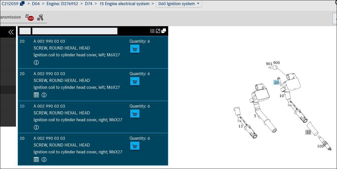

I replaced my ignition coils today and dropped one of the e8 bolts and cannot locate it. Does anyone have a part number? Looked everyone! Thanks in advance
Old Jan 18, 2023 | 03:20 PM
  #45
konigstiger's Avatar
Posts: 15,901
Likes: 4,630
From: North Scottsdale, AZ
'71 Pinto
  #46
anglil22's Avatar
Joined: Oct 2021
Posts: 41
2016 e350 W212
Thank you very much! I have a 2016 E350 and this part on MB Parts shows 2019-2021 only
Old Jan 18, 2023 | 03:29 PM
  #47
Posts: 15,901
Likes: 4,630
'71 Pinto

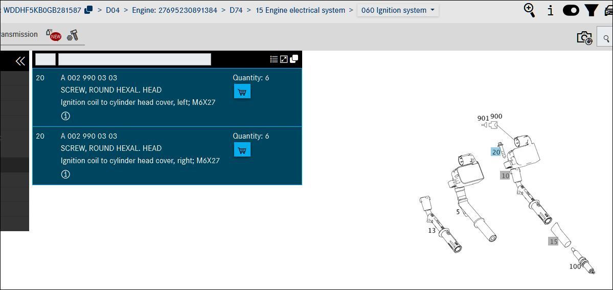

VIN?
  #48
anglil22's Avatar
Joined: Oct 2021
Posts: 41
2016 e350 W212
WDDHF5KB0GB281587
Old Jan 18, 2023 | 03:37 PM
  #49
Posts: 15,901
Likes: 4,630
'71 Pinto
Confirm part # with local dealer parts.
