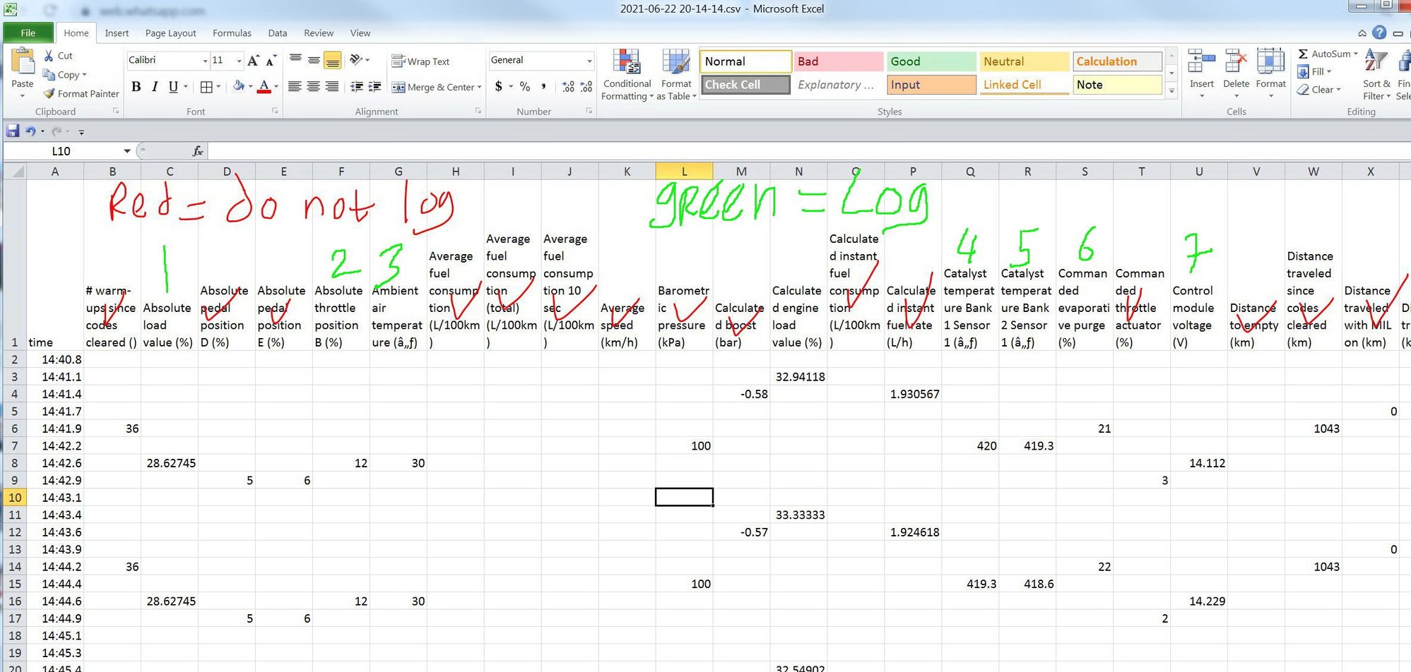

Since you have the OBD2, why dont you log these parameters and we can help see what's going on :
01. Short Term Fuel Trim, both banks
02. Long Term Fuel Trim, both banks
03. Fuel Rail Pressure
04. Manifold Absolute Pressure
05. Both upstream oxygen sensor
06. Both downstream oxygen sensor
07. Boost (psi)/Vacuum (inHG) Pressure
08. RPM
All above while : While in PARK
A - Idling
B - 2,000 RPM 15 seconds
C - 3,000 RPM 15 seconds
Log them in CSV file and post it here.
I have the same engine, so I can help compare those values .

Can you do a regular CSV file arrangement like below : Me excel and CSV stupid when it come to having sort its data ... LOL
I think yours originally is TEXT form.
Yours
Make it like below please...
Take ur time, no rush ...

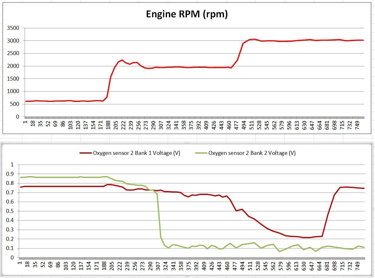

Kim,
01. Reduce to logging rate to 1Hz or 1 data per second. Now you are at 8Hz it seems and that made many missing data per Hz recorded.
02. Tomorrow morning, from COLD engine, start the logging and keep logging until your engine hit operating temperature 85C or hotter.
Within the same logging period do the 2,000 and 3,000 RPM hold, minimum 30 seconds, longer will be better.
Anyway our engine at PARK is locked to approx 4,100RPM even at full throttle, do a log for that 4,000 RPM too please, 30 seconds.
All these will need at least 10 minutes of engine running.
Today's data is too short a period.
01 and 02 is to confirm the possibility of your Wide Band 02 Sensor , the upstream one and the downstream one, the narrow 02 sensor..... are good or bad?
It is a high suspect at your mileage. 125,000 KM is already a good service life for those 4 units 02 sensors, BTW.
Please confirm that your car only have 4 oxygen sensors .

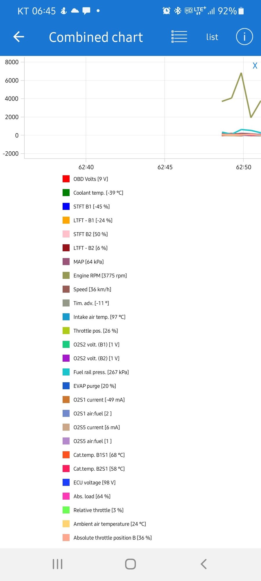

thanks I will make log data within 30 minutes. ^^

nope, coolant get hot up to 85C now, attached file is logging data.
Can I wait to cold coolant condition?

Kim,
I am repeating again.

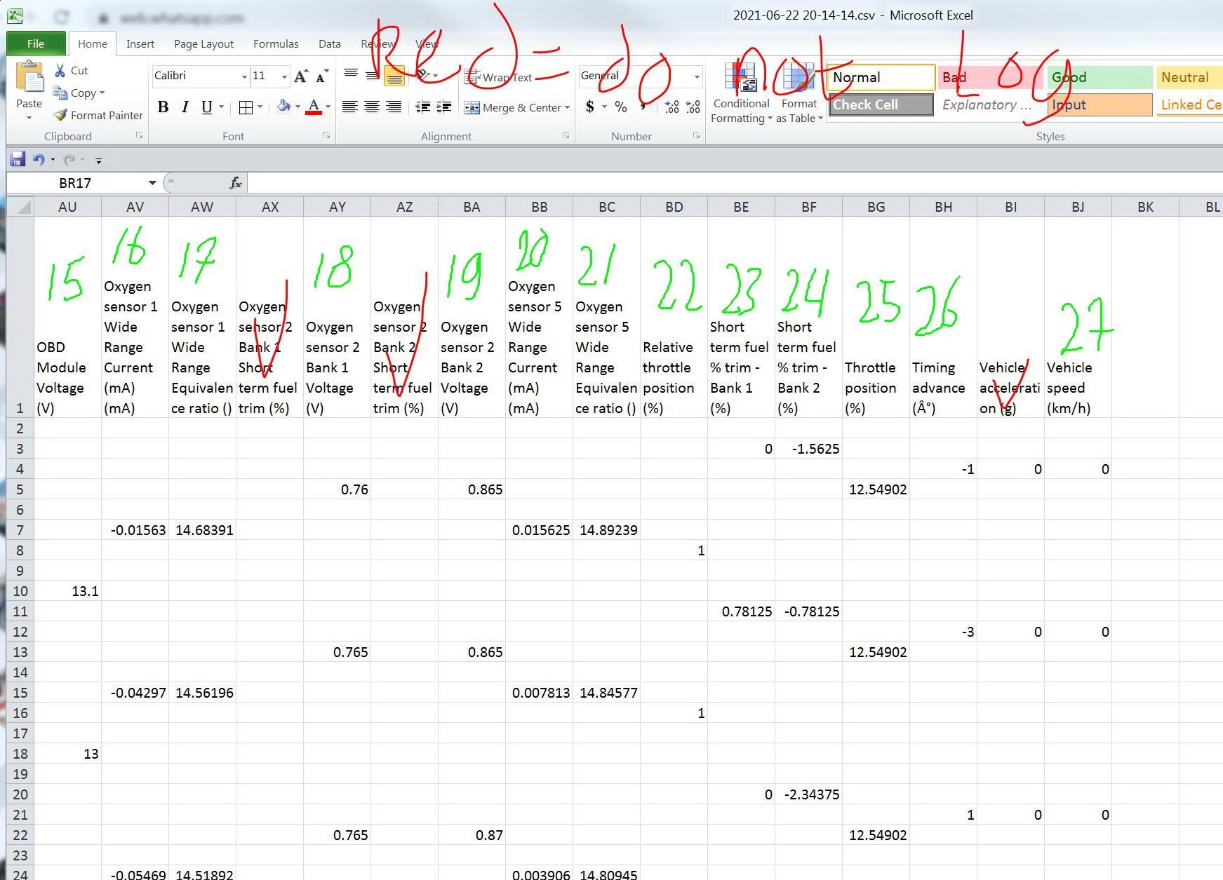

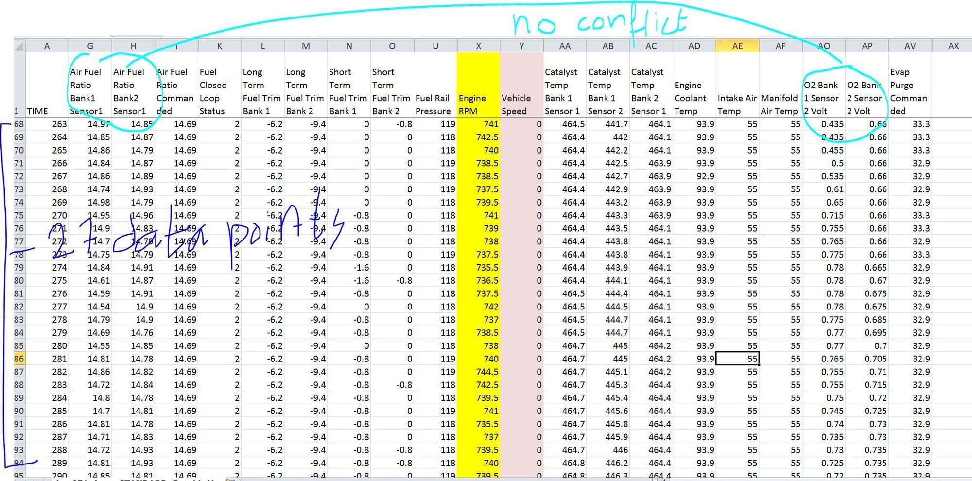

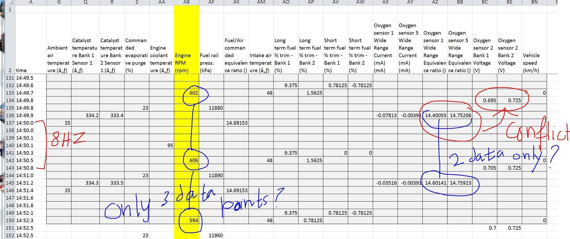

01. Reduce to logging rate to 1Hz or 1 data per second. Now you are at 8Hz it seems and that made many missing data per Hz recorded. Stop logging for now what is not needed.
I need better resolution and longer period to see why the upstream Bank 1 sensor is in conflict with its downstream one. One is a bit Rich and one other a bit Lean. Assuming the data are accurate.
ABOVE : you are overloading your logger system.
The data density of true 1Hz will be good enough if there are no data holes, like below.
Please verify.
Kim Wrote : My car shake at idle repeatedly. this symtom is not regulary.
- Is this from cold start or warm start too ?
- What is current ambient temperature on average where you are now ?

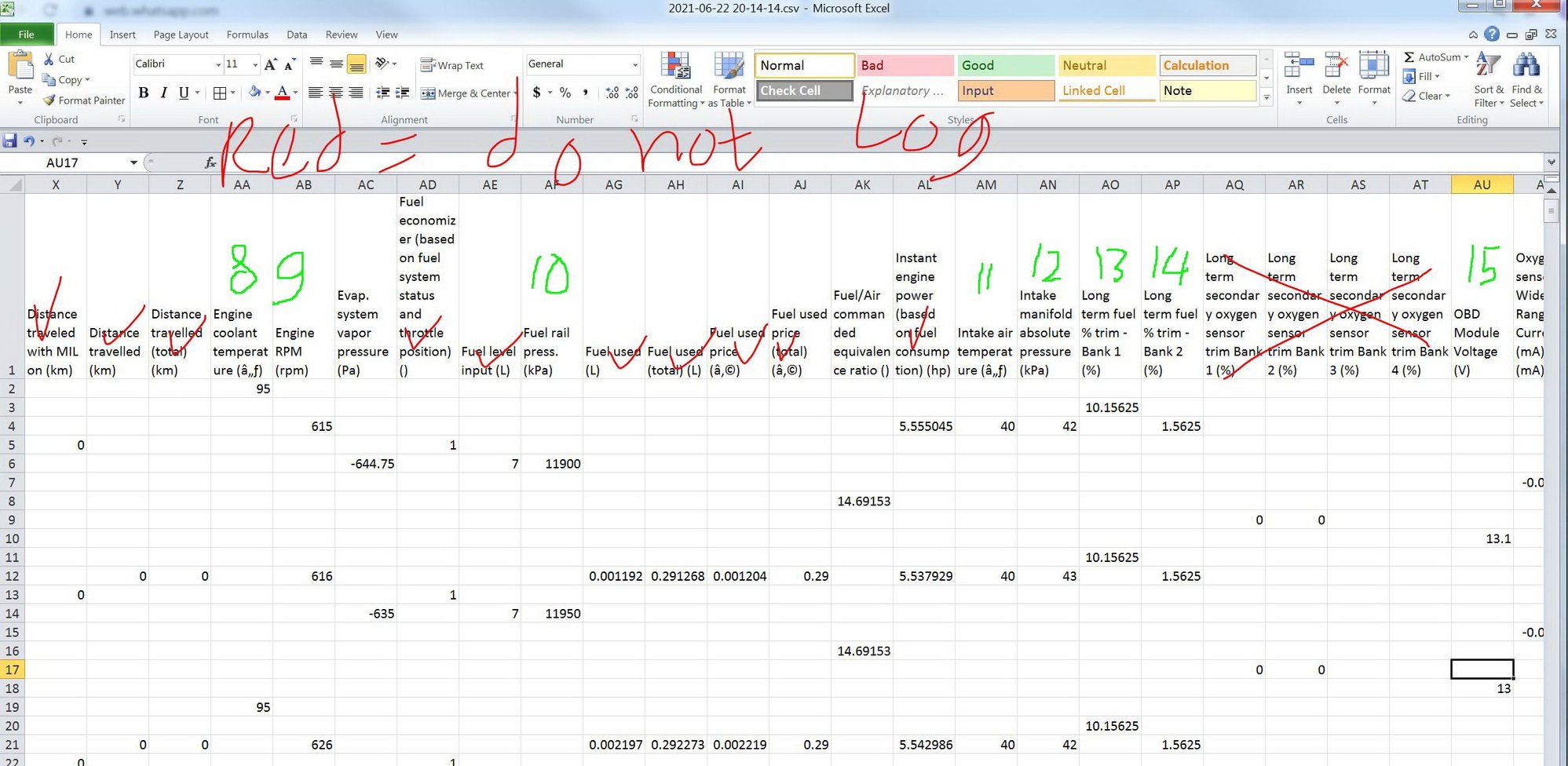

02. Tomorrow morning, from COLD* engine, start the logging and keep logging until your engine hit operating temperature 80C or hotter and then you rev up.
*I want to see if you evap purge is kinda stuck or not.
Within the same logging period do the 2,000 RPM and 3,000 RPM and 4,000 RPM hold, minimum 60 seconds yah. Longer better, less DONT.
Today's data is too short a period and the data holes in your file , made my migrain re-surfaced.
DO NOT LOG THOSE IN RED THIS TEST. We keep you logger light and fast. I want the green ones.
I am still messing with ECO charging algo , that is why my RPM at idle is higher than yours.
Tomorrow I will get it back to the same idle RPM as yours and I will also do the SAME test I wanted you to do.
So that we can compare notes apple to apple.
I am at 30-32C ambient temperature .
Later...........

Originally Posted by S-Prihadi
Kim,
Please verify.
Later...........
Sorry for logging rate, currently I cannot found to change logging rate yet. I'm using Car scnner app with connecting blutooth ,but I do not know where chaging logging rate yet.
Please verify.
--> yes, shake are occured from cold start and warm start on everytime but irregulary.
- What is current ambient temperature on average where you are nowar
--> I tested my car in basement garage. ambient temperature on 30C.
I will log with some sensors you selected within 12 hours. thanks thanks.

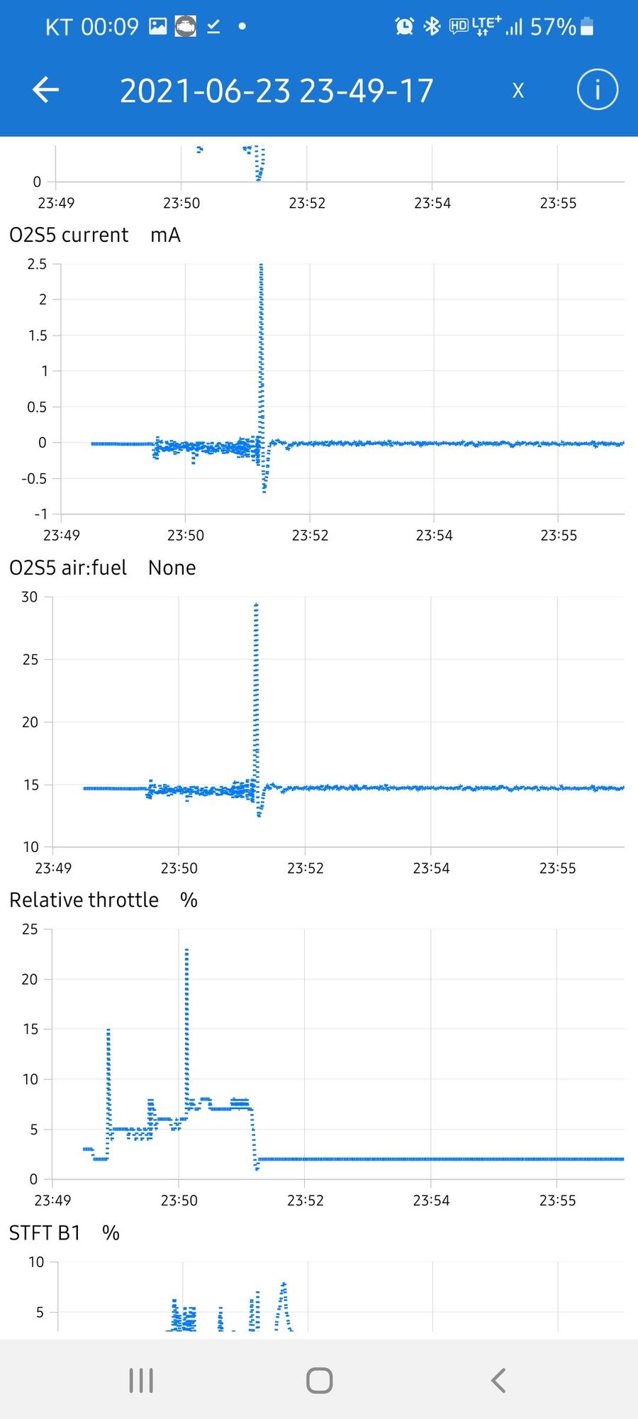

Hi Kim,
After revving up the engine to 4,000, let it idle back for 5 minutes please. Let sensor reading stabilized.
I need to see the 02 sensor past 650 Celcius. Upstream 02 sensor need proper operational temperature. Hopefully after the 4,000 rpm it can hit 650C at least.
Maybe this will help with logging frequency adjustment
https://www.carscanner.info/optimizi...nection-speed/
I am only familiar with Torque App sorry. Torque can only log 8 parameters to CSV file, that I find too little.
Also try :
01. Remove all fuel economy monitor/tracking feature and the like.
02. Remove all TroubleCode tracking.Distance traveled since codes cleared (km)
Distance traveled with MIL on (km)
Distance travelled (km)
Distance travelled (total) (km)
Good luck
ADD :
Becareful please with basement garage. Is the ventilation good enough ? I dont want you to get carbon monixide poisoning.

I've not logged either of my E400s, but I have analyzed lots of other cars. Those LTFT numbers do not look right to me.

Our basemment garage is big, thank you for comcerning.
attached file is logging data that you requested. thank you for help me!!
during logging, shake is coming every time.
