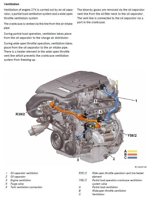

W212 facelift with M274 engine has faut code show: The vent line for the crankcase is leaky. Leaky or a defective seal was detected.
Please help me locate the vent line or valve on M274. I've check but no one show leaky.
Thanks

thanks. But on M274 for w212 facelift, on B has a valve, I’ll check and feedback soon
