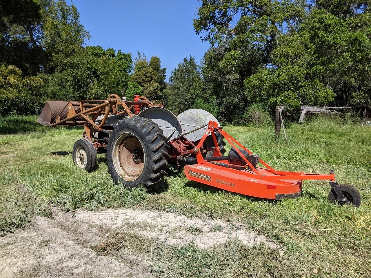

I like the idea that works for millions of farmers for lot of generations.

On my tractor, a 1948 Ford 8N, I put one of those flaps on the vertical exhaust that cap it when the engine is off, and I put a cheap 10 watt solar panel on top direct wired to the battery to keep it fully charged. When I switch that tractor off, there is NOTHING connected to the battery anyways, so disconnecting it would be redundant (it has no lights or other aux stuff, just the ignition coil, and the alternator, and I wired the switch to disconnect both of those on separate poles).
(jonsing for a kubota L)
but, a 2014 E class is NOT a tractor, not by a long shot. For an E that sits for a month plus, I would want a quality battery tender like a CTek or NOCO, and plug it into the battery when I park it for more than a week. If this car has eco start/stop and the 2nd battery in the trunk, I might even want a SECOND 1-2 amp battery tender connected to that second battery since its isolated when the car is off. My Ford diesel F250 4x4 truck can sometimes sit for a few months, so I wired a connector for a battery tender. its parked outside, so I have a solar battery tender on it that I put on the windshield or cab roof. Thankfuly, it never freezes here on the California central coast, so I don't have to worry about bringing batteries inside in the winter..
