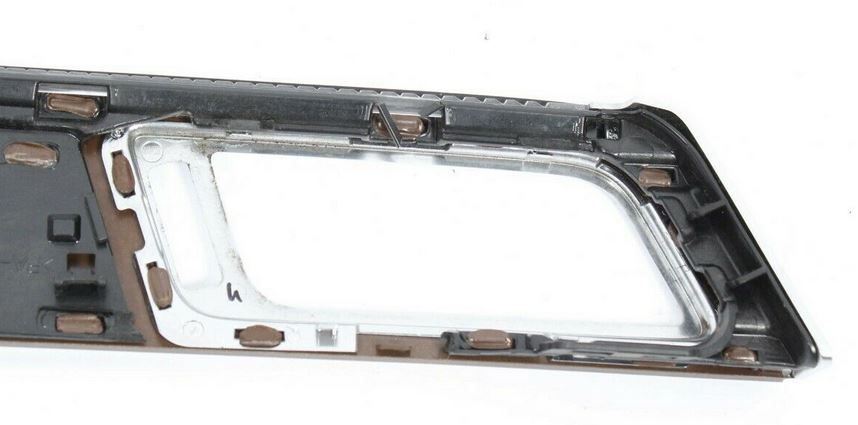

I have some minor damage to the silver trim ring on the far passenger side dash vent on my 2015. Looking in EPC it seems that Mercedes does not sell this trim individually but rather only as a part of the entire wood trim assembly that spans the dash.
Does anybody know if the trim ring can be removed from the wood trim assembly and replaced? If so I will probably try to purchase one used to do the swap.
Perhaps somebody who had their faded trim replaced still has the old parts? Any help would be greatly appreciated!

Can be carefully manipulated off if you can find sacrificial, replacement will need to glued. Here is underside.

Now to find a suitable donor... Anybody have trim leftover from replacing their faded walnut?
