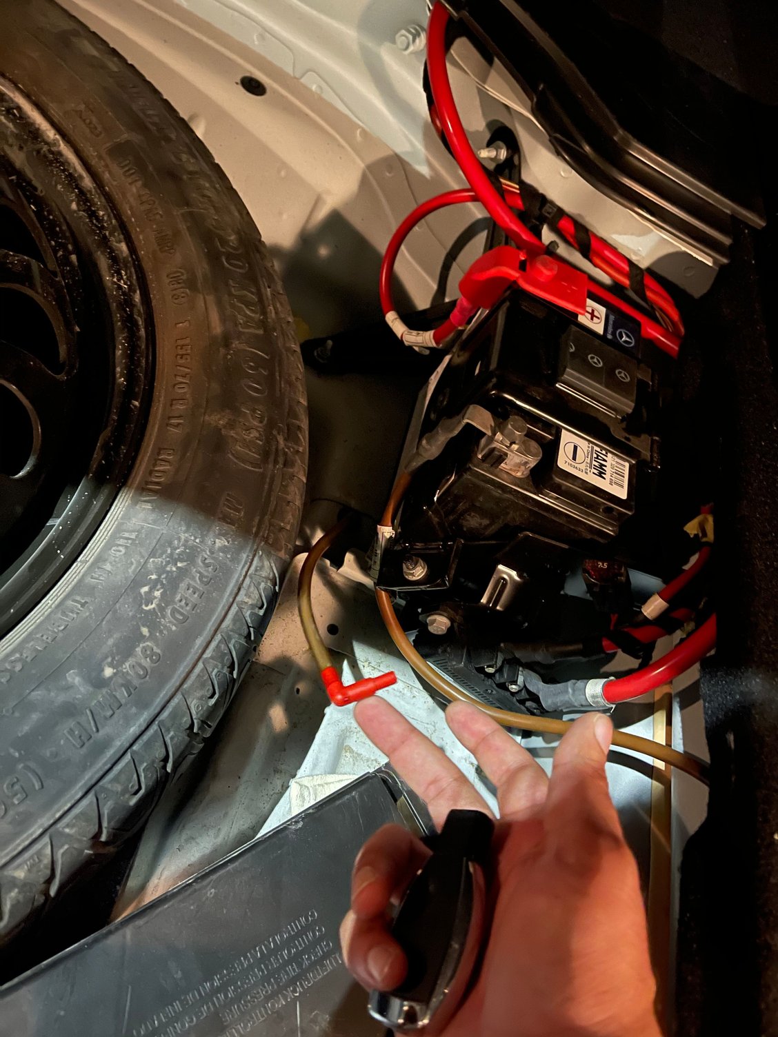

Hi
I recently discovered this red wire hose type of a thing.
Any idea what is this from and where should it be connected?
thanks!

Vent. You can see the hole it plugs into in that picture.

Been trying to figure it where’s the right place for it but no idea yet. What is this hose for?

This hose is the hydrogen VENT tube to remove explosive gases from the OEM battery.
Some people use a sealed battery as replacement. SLA do have rubber caps to vent high pressure.
AUX Batt sees currents in the 50Amps range... stick with a vented style ✌️
AUX batt sees high currents, stick with a vented style... $100.
so i found out it plugs into the right side of the battery very light though i would expect something so dangerous to be a lil more secure

Wrap some tape around it until it fits snugly in the hole

that IS a SLA* (more properly, a VRLA** AGM***) battery, its just one with a vent hose. they NORMALLY don't vent, they will only vent if they are overcharged or develop an internal short, these Mercedes specified VRLAs have a vent hose fitting for that abnormal condition.
* - Sealed Lead Acid
** - Valve Regulated Lead Acid
*** - Absorbed Glass Mat
