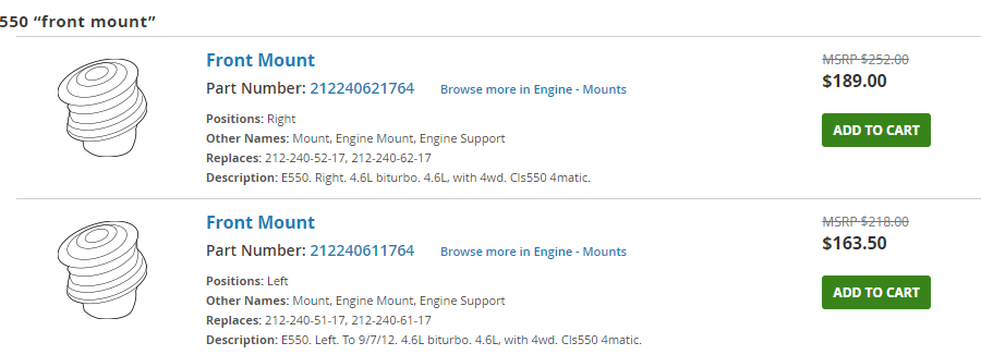

It's 5 hours of labor at the MOST. Recently I wrote an RO for $450 for the front mounts, $150 for the trans mount in the back (4hrs), usually that one goes out before the front mounts, it's a cheap part that should be replaced every 5 years IMO, front mounts every 10. $1000-1200 is a fair deal in most markets. I can help you order parts if you want to shop labor around you. Recently W212 mounts of all types took a price drop from MB so its a good time, and I just recommend a Rein or Lemforder transmission mount which costs $20.
The technique I've employed is to disconnect and hang the steering rack, and uncouple the exhaust. It sounds invasive but its like 30 minutes of work with a lift and Milwaukee. I've seen both vehicles get replaced with nothing more than the right exhaust removal and some lucky hands. I was recently completely unaware of the heat shields covering the late M273's, but now we're good. We just do both the rack and the exhaust and if the technician has a better way he just saved himself half an hour on his work schedule.
Consider replacing the starter while youre in there, its also covered by the right exhaust. Make sure you get credited somewhat for overlapping labor though, it's just another 15 minutes to replace this thing, maybe agree to half an hour?
M278's are a little new to need mounts, how do you feel about it? I recommend them around 120k, the trans mount craps the bed pretty frequently and youll know when it shudders on a cold morning on the first acceleration

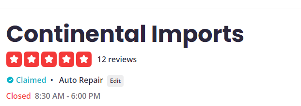

I did a little research for you, looks like this could be a decent lead. Call three places and go with the one who makes you feel the best, not necessarily the cheapest. I have a local indy colleague who does M278 mounts for $450 labor in a cheaper part of town, I'm $750. You'll find someone who will not consider this a tough job, I hope we're able to save you a couple grand. You can PM me if you want a briefing of the job so you don't get taken by someone who makes it sound harder than it is.
So this is to prepare you for the parts bill. They're going to charge you the list price, not this wholesale price. Last month a 2014 CLS550 was in for engine mounts at 110, so that seems to be the magic number when you just start noticing engine rock at idle. Was the case for my W221. So if your indy wants say, 5 hours at $150, with parts it'd be $1220. I'd negotiate some additional stuff for a good deal, you're already into them for decent money, sway bar links, starter, crank position sensor replacement (its 5 minutes), oil change, etc. The transmission mount is like 30 minutes once youre down there and the pans are off. The Lemforder or Corteco part is $60, and the OEM unit is $150 from MB, this is assuming I just guessed yours was a 2013, but they should all be in the right ballpark.
