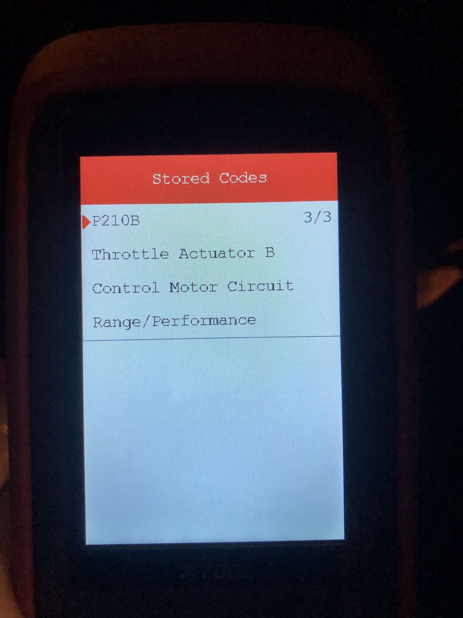

Anyone know about this code? Is it the actual throttle actuator or just TPS sensor? On m156 e63.

That's one of your throttle bodies getting flagged by the ECU for discrepancies between ask/get positions. It's the counterpart of what the TPS is asking.
I would discount that as a fluke unless ECU is going to reliably fail with this DTC
Have you done a "BATTERY FLOAT + RESET" lately..?
I did not say... your throttle bodies are mint, I said troubleshoot first unless you are rushed.

It is stored codes, meaning unless you noticed other problems it could happen 3 or 5 years ago.
Clear it and recheck after some driving.

it continues to pop up after clearing…
probably an actual issue as it continues to throw intermittent check engines even after clearing the code…

So... What are the other two codes?

it was 3 of the same code. All stored.

narrowing things down...
Something is really getting suspicious about that circuit... not so random.
> Take a look at the TB harness for signs of crusties and oil.
> After that I'd look at Throttle body live data with KeyON engineOFF: press accelerator pedal from 0 to 100 and what the response.
> back probe connector..?
(> look at ECU for legendary oil flood)
Make sure your voltages are not marginal.

That would be indication your scanner is not having capabilities for MB codes clearing.

or that a problem actally exists...

Existing problem would be pending code and it would not show after clearing before engine will run for some time.

the life of DTC flags
There are different type of codes in different modules. Some codes are pending, current, stored and some VIP just earn instant limp mode.
Few of the DTCodes are a reliable call for parts - You always need to wear your thinking cap to trace the issue unless you can tap prior expertise.
Here the fact one throttle body keeps getting flagged says something is truly up with its circuit, not a generic Benz glitch...
[ECU > wiring > connector > device]
I don't think complexities can be successfully worked out with ignorance. What's causing this issue may well be a $1000+ question.... how fast you get to the cause determines the outcome.
If the throttle body can be tested defective it'll be a successful closure.

Im definitely going to have dealer look at it as that is the easiest solution for me with the time I have. Just confusing how the car doesn't have a check engine light about 60% of the time. Havent really figured out the reason why it sometimes throws codes but it is seemingly random.
