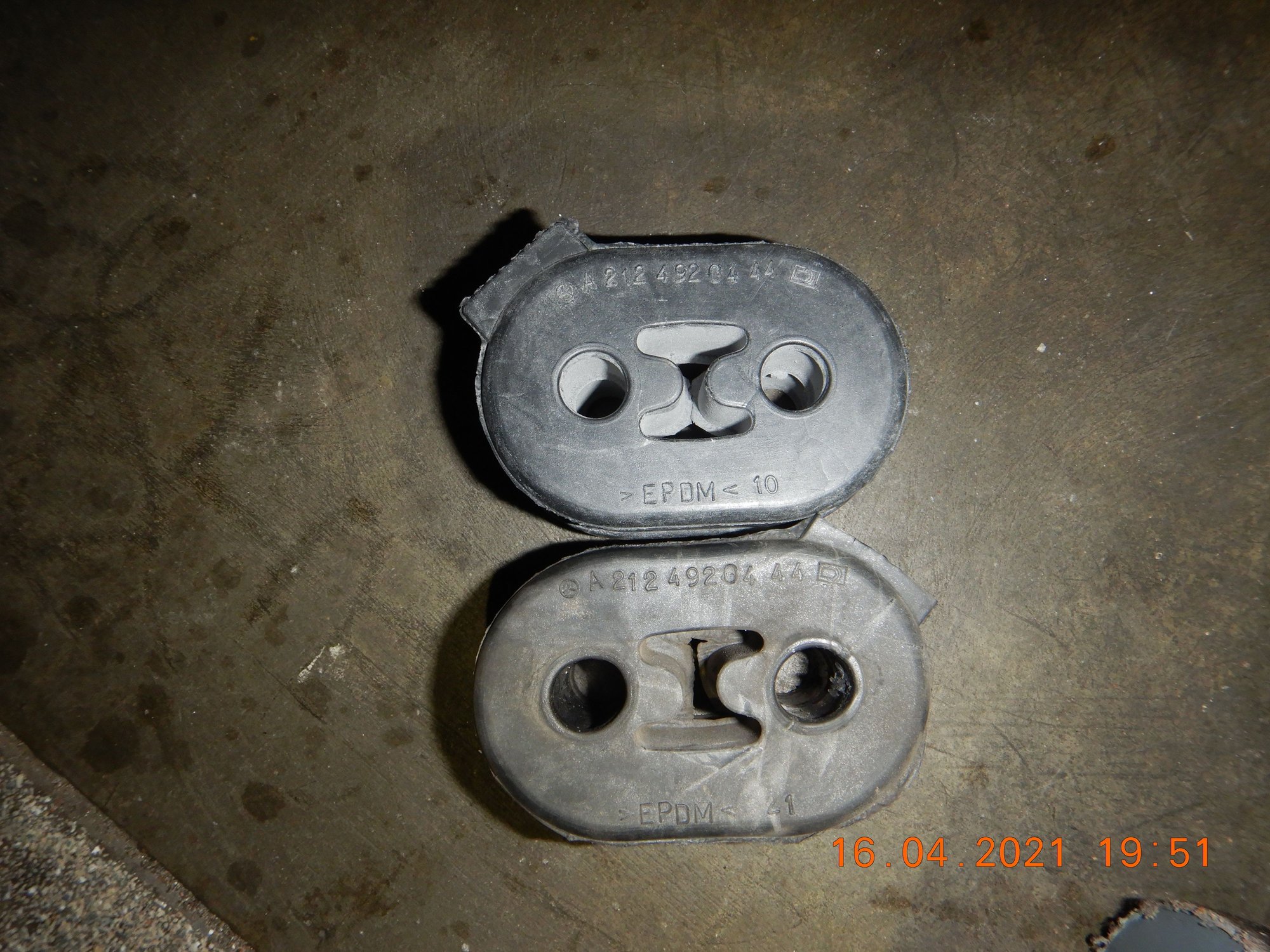

It is very cheap, US$10 each or so, genuine. V6 will need 4 pcs. 2 per Bank/Exhaust pipe.
These rubbers work hard and if harden can add vibration transfer.
If they snap, the exhaust manifold may suffer carrying the load/weight of the entire exhaust system. Hopefully the exhaust manifold won't crack.
Below is from my engine M276 3.0 TT and it is not yet the entire exhaust system, only 50% of it. There is another 1 of middle muffler and 2 of rear mufflers left and right side, still on the car.
I believe the M276 3.5L or M278 would be near identical layout to mine. Imagine the TOTAL weight of the system suported only by those poor 4 units of rubbers.

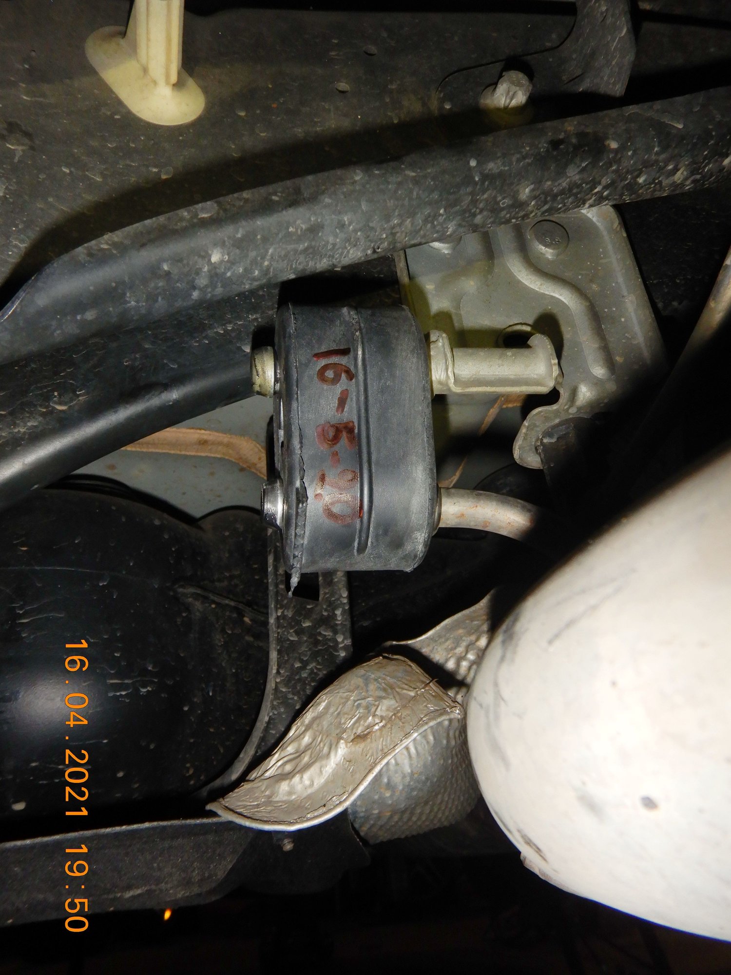

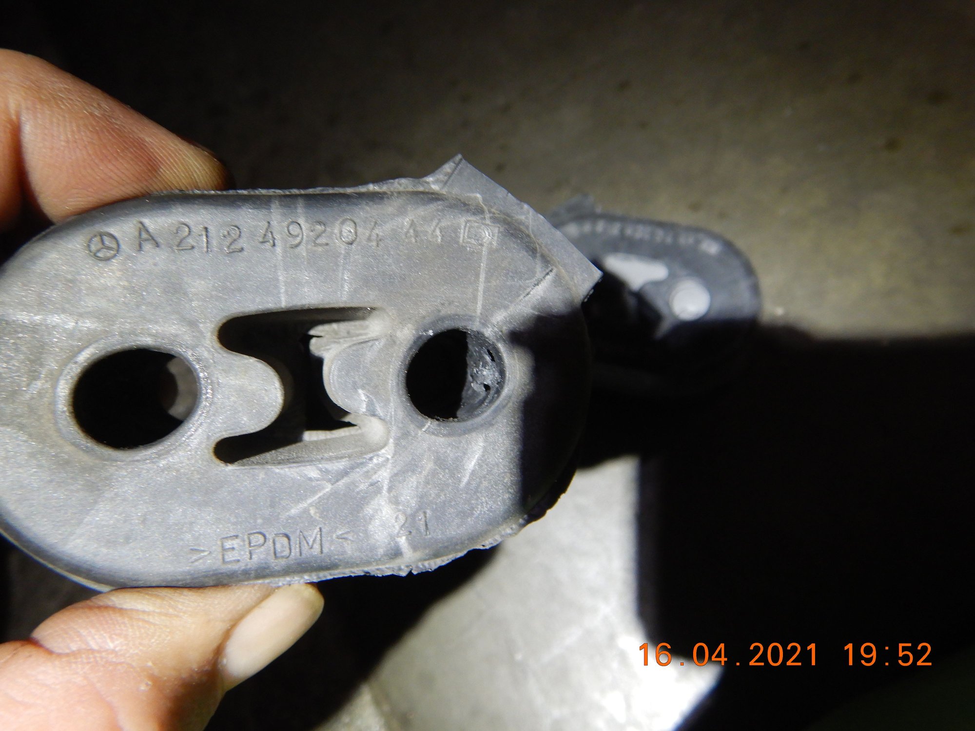

Approx 28,000KM. 7 years old. Below: Old vs New
The hole which get ruined is the body side
I lube them holes , so that it allows smoother movement
I always date print them
And it is supposed to be 2021 , not 2020 .......... DAH !!!

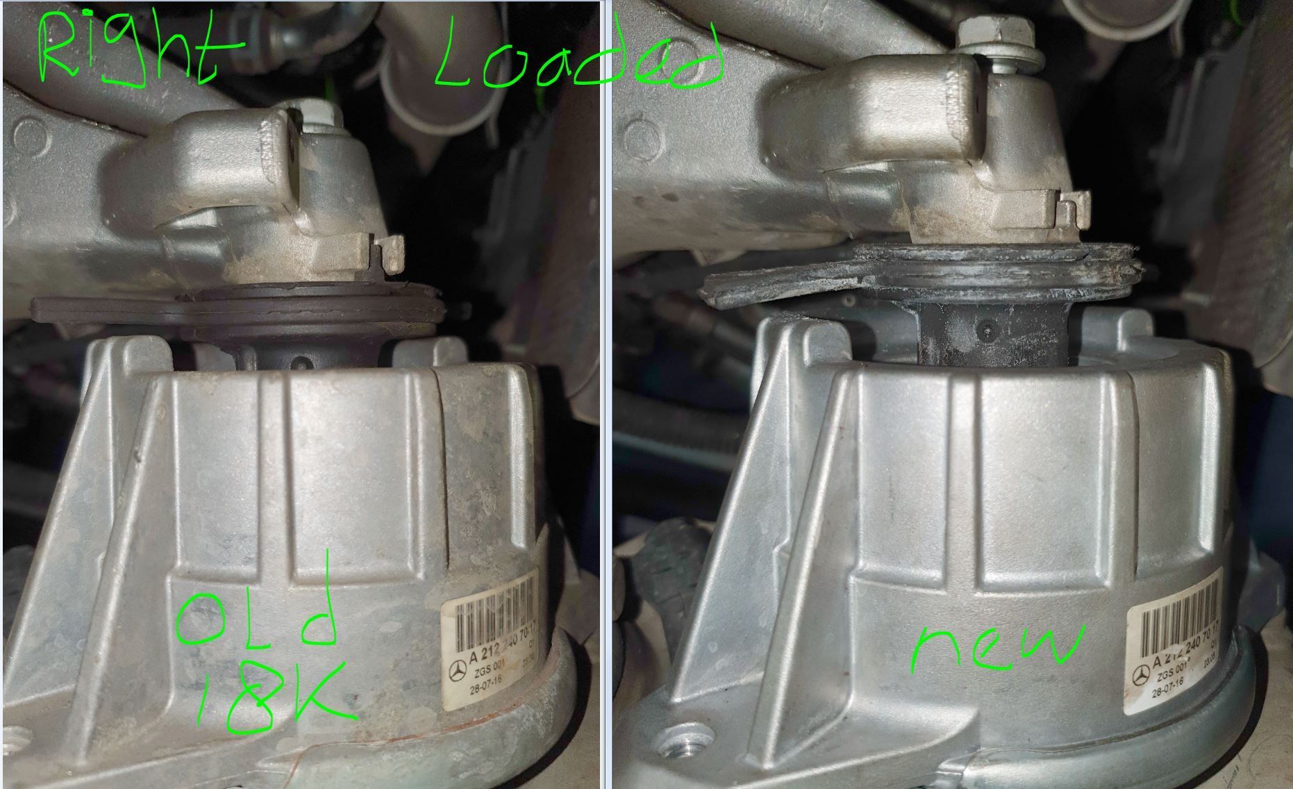

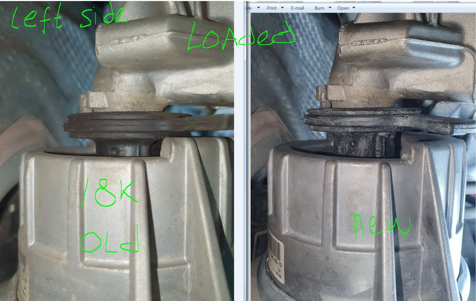

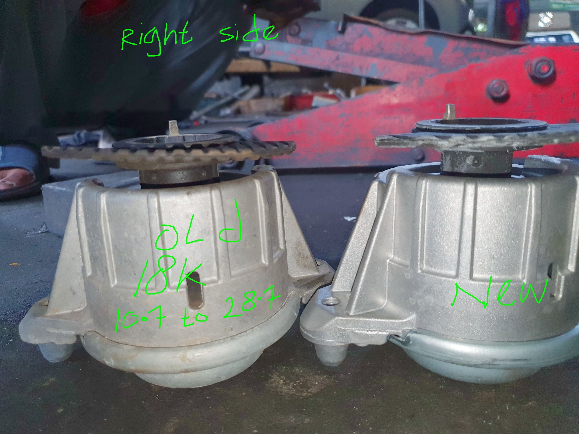

Actually we can tell engine mounts health at static engine OFF rather easy. It is height based, what's left of it. The elephant ear like rubber can be used as height control.
Here are my engine mounts height drop related to its mileage.
NO LOAD. 18,000KM ( my 2nd set ) vs NEW ( my 3rd set , currently installed ). New from factory is the 1st set, in 2014 when car got assembled.
LOADED, installed.

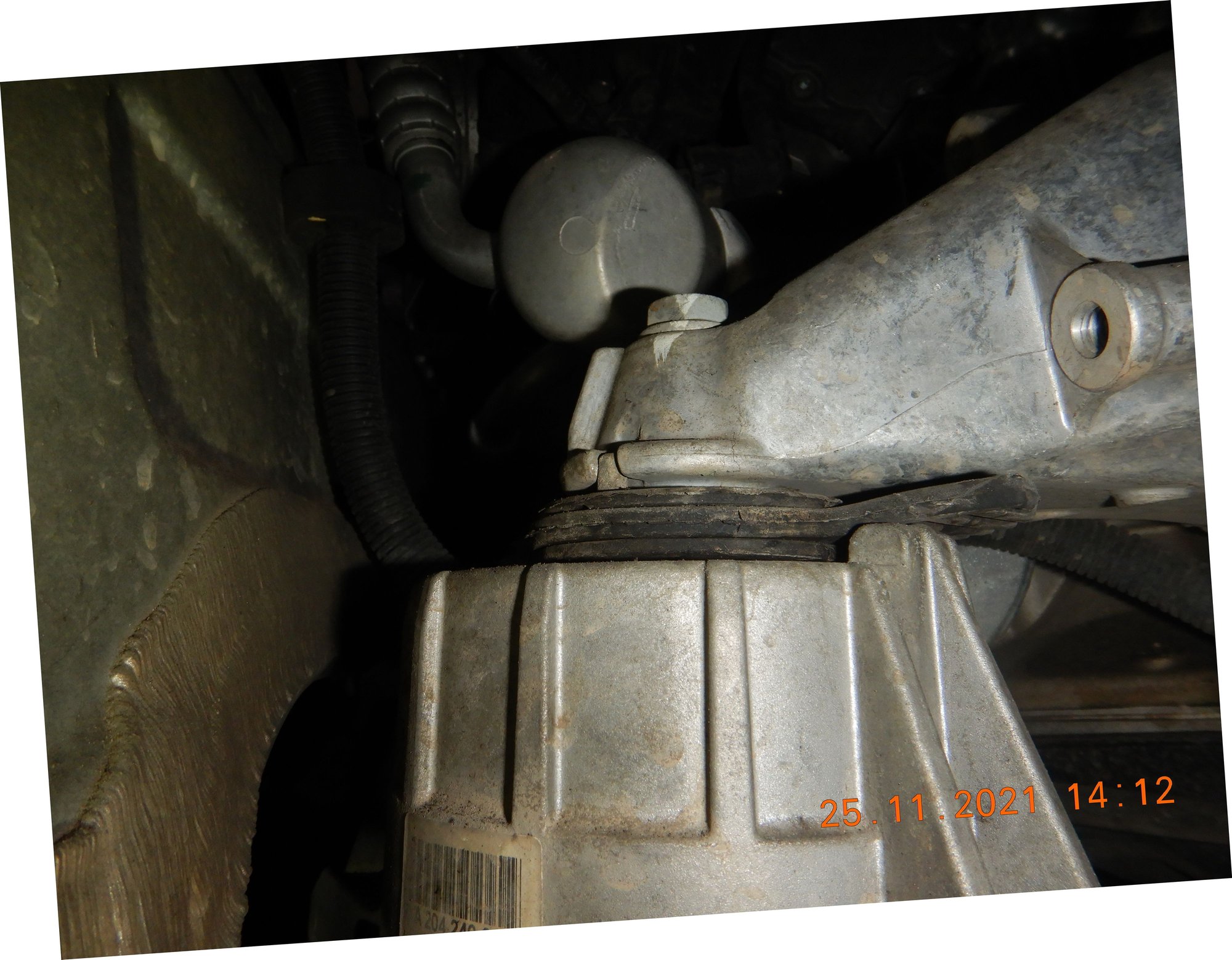

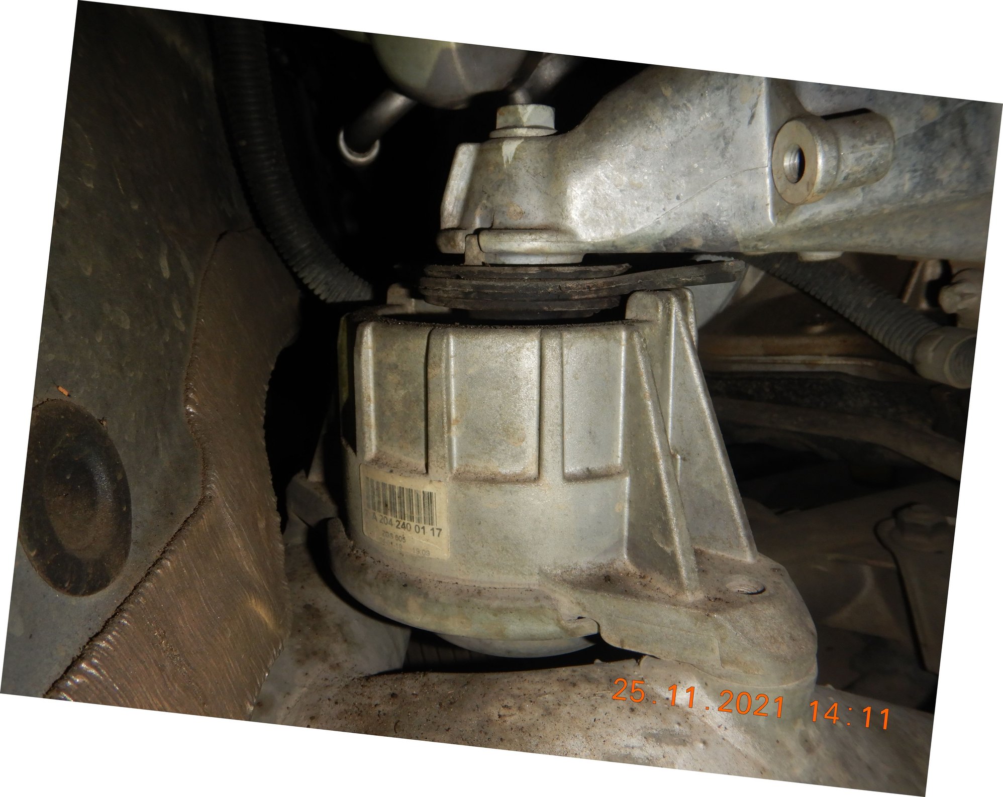

BELOW : My friend's 2010 C200, 70,00KM, never replaced since 2010. Only the left side one easy to take photo, as this is Inline 4 and exhaust system + turbo is on the right side.
This is a RUINED engine mount. A bit more use the engine bracket will kiss the engine mount under hard acceleration and braking and whatnot. These mounts is sending vibrations to the steering wheel already.
Its vibration isolation value has probably gone more than 60%.
My style of driving and super sensitive nature to degradation of suspension/mounts components, 25,000KM is probably the time I need to change engine mounts (2) and the tranny mount (1).
Granted the 18,000KM old 2nd set engine mounts has 20 laps of fun drive at circuit and say we put it as 10,000KM worth on street use ( my style of driving ), max 30,000KM is about as far as it can serve me for
its creme de la creme state of use.
It is easy to detect out of tolerance engine mount at idle in Neutral and Drive or Reverse but brake is held. The amount of vibration at the steering wheel is the give away and more so
in D or R, brake held. All one got to do is be vigilant.

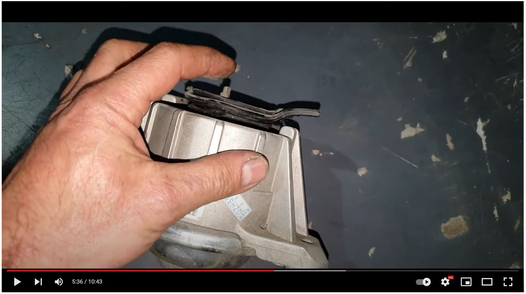

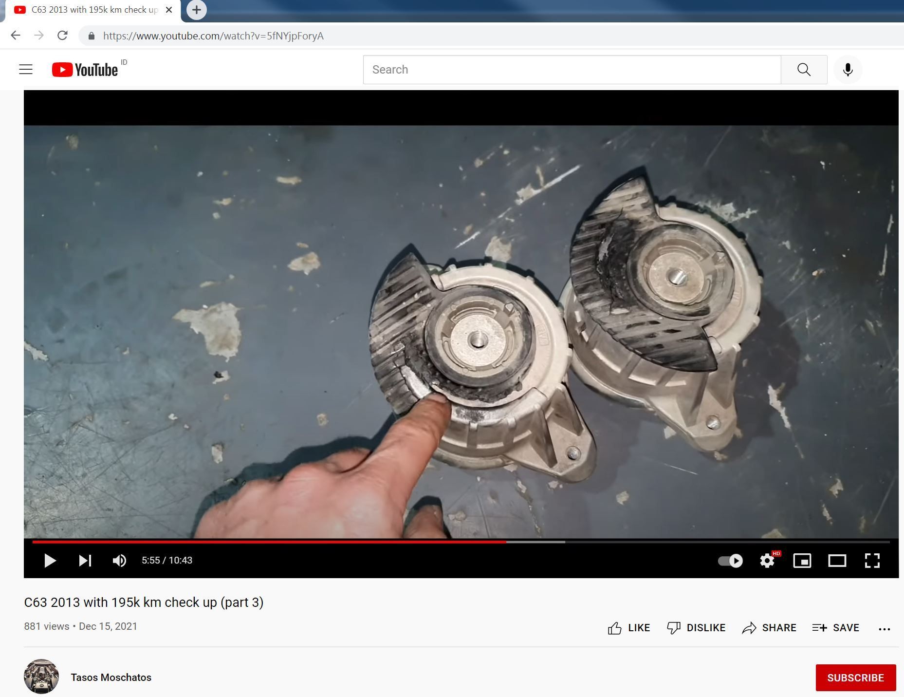

Below is a neglected engine mount, it is not 195,000KM, it is surely less than that. However the driver surely experienced knocking sound big time already.
The engine mounts had rough sex with the engine bracket
Youtube link to see the above engine mount :
