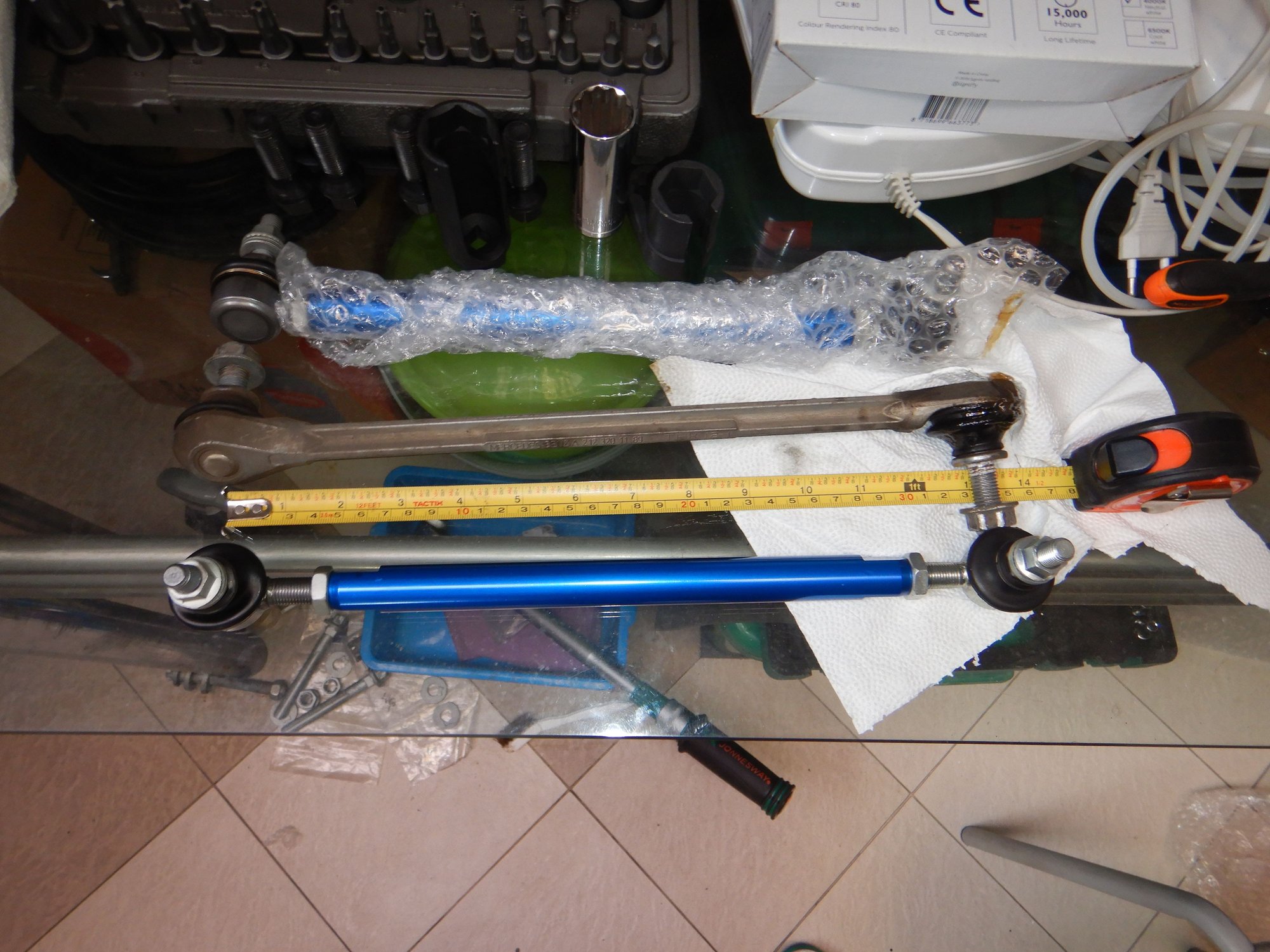

No marking means it is non genuine.
This is genuine, see below : Made by a Japanese company called THK. https://www.thk.com/?q=us/node/5219
Blue one is aftermarket by SuperPro Australia
Mine only torn boots, ball is still decent, no noise.
