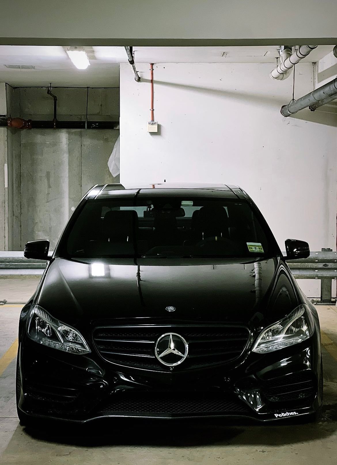

I was wondering if I could run 20” wheels with wide tire setup on my 14’ E350 4matic?
front: 20x9.5 ET35 with 255/40/20 tire
rear: 20x11 ET45 with 295/35/20 tire
Would I face any issues? Let me know how you think it would help me a lot.
