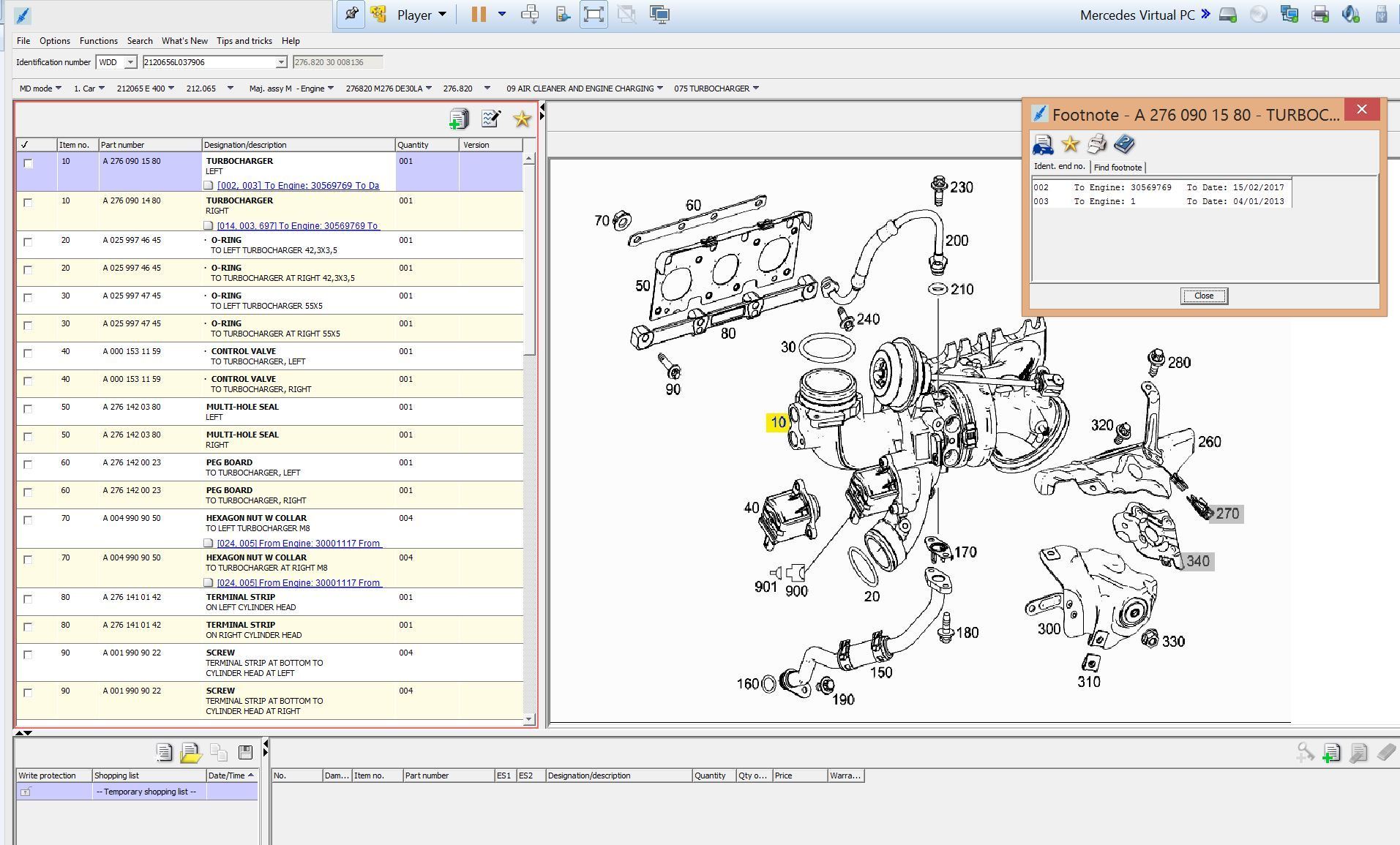

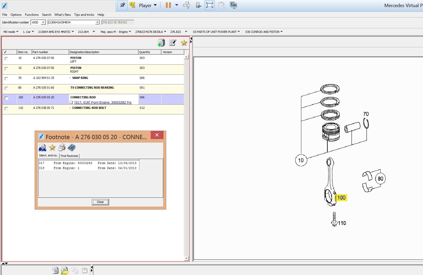

If someone has a 2019 or newer EPC, maybe it can shed some light on internal component differences between the 328HP to 396HP of the 3.0 turbo
Based on 2018 EPC , new suggested piston P/N of my E400 engine is the same as W213 E43 which is supposedly 396HP as per Car & Driver https://www.caranddriver.com/mercedes-amg/e43-2018
Con-Rod been the same. Cylinder head new P/N for E400 is the same with E43 and so are the camshafts.

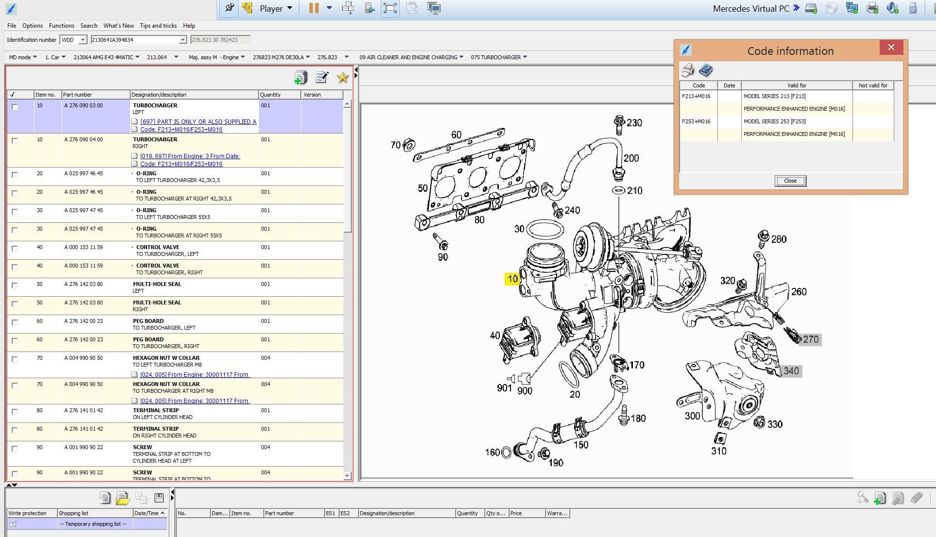

E400
E43
Turbo is different P/N, you can see the special power upgrade code. E400 is M014 vs the E43 M016. Data card will show this.
E400
E43
