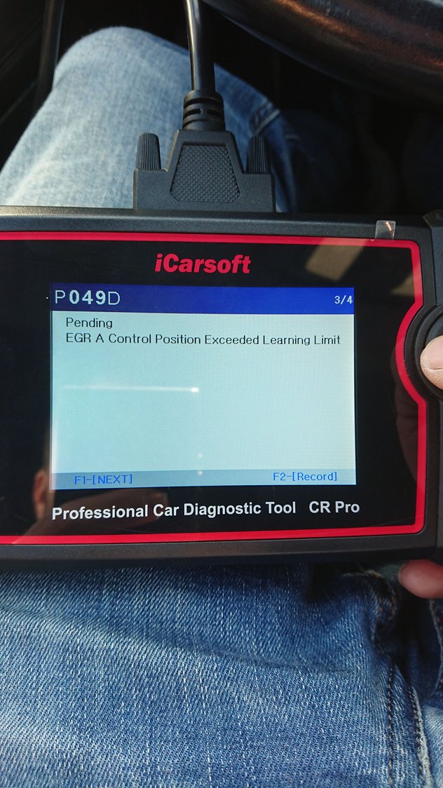

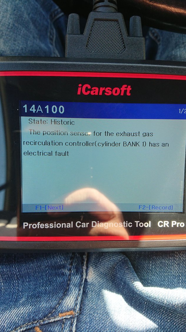

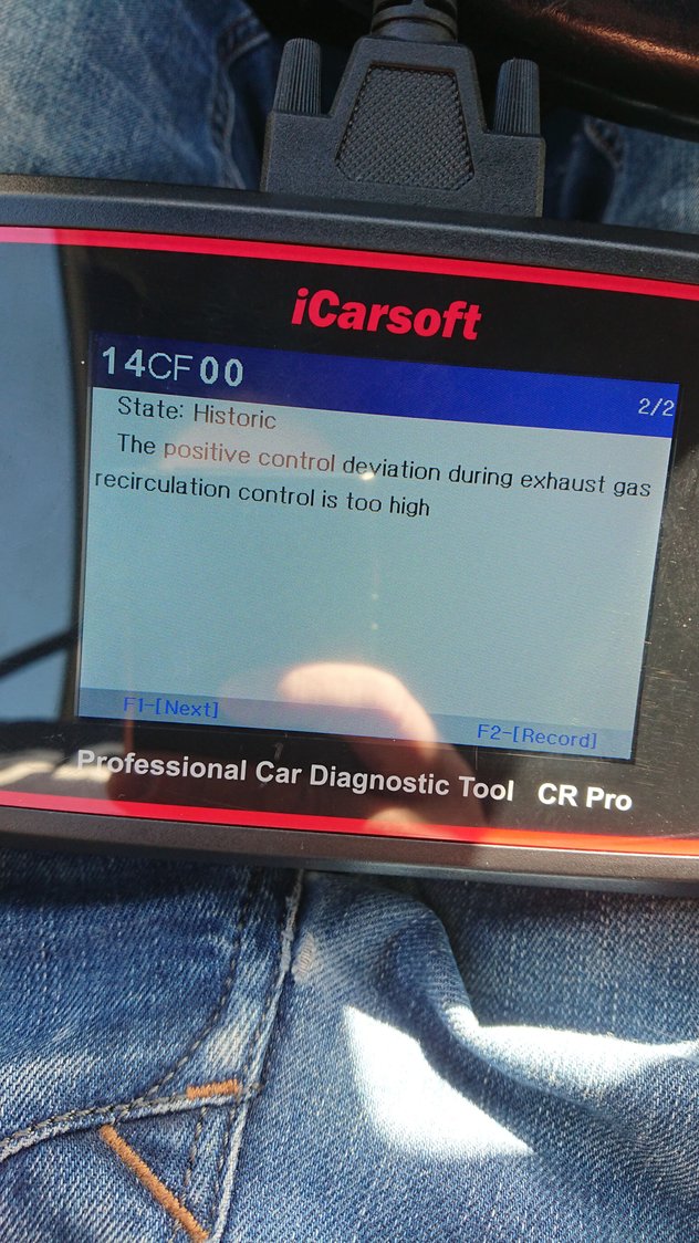

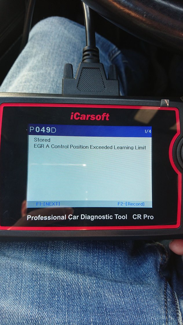

I have code P0405, 149A00 14A100

149A00 P0405 Component 'Y27/9 (Left EGR positioner)' has an internal fault.
EGR valve may need cleaning or replacement – part # 6421401960 or MB direct 642140196064 need VIN to confirm.

350 cdi
Old Jun 2, 2022 | 05:17 PM
C.Lopez's Avatar
Joined: May 2022
Posts: 5
350 cdi
The cables are complete between the EGR valve and the cu..
