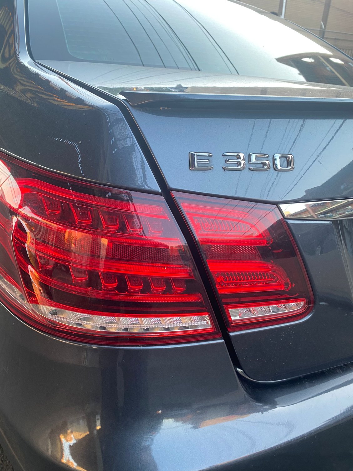

Hi friends!
New to the MB universe here. I recently got myself a later model 2014 e350 (the one with the facelift). The dealership said that this is normal and can be fixed at home but I have not found any threads that help. I’ve seen a few that deal with uneven trunk closures which usually happen after the trunk has been slammed with something blocking the way. But this is not the case. I came across a youtube video that pointed out that he got this same issue naturally over time but never pointed out a fix for it.
Normally small panel gaps and misalignments wouldn’t bother me, but this spans across the entirety of the rear end and is VERY apparent even from a distance so I’d prefer to find a fix sooner than later :/
I’ve attached photos of the trunk gap when the trunk is closed. Any information or a point in the right direction would be greatly appreciated!!

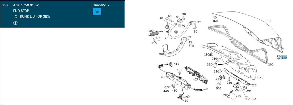

See attachment for gap dimensions if purchased from dealer they should correct matter, end stops may need adjustment/replacement.

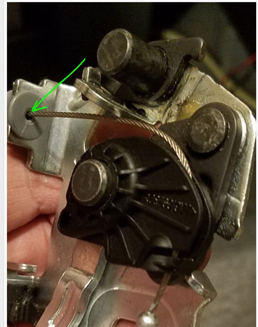

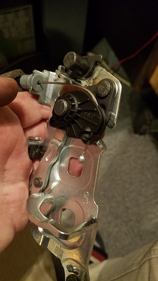

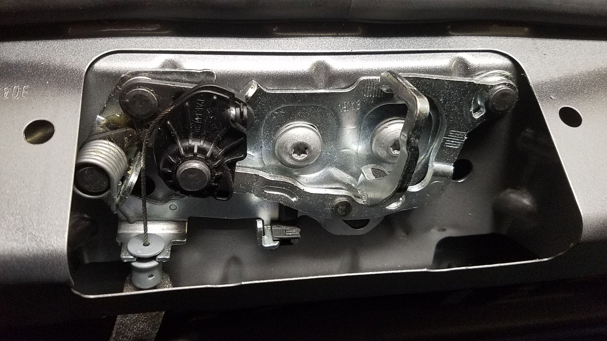

trunk soft-close

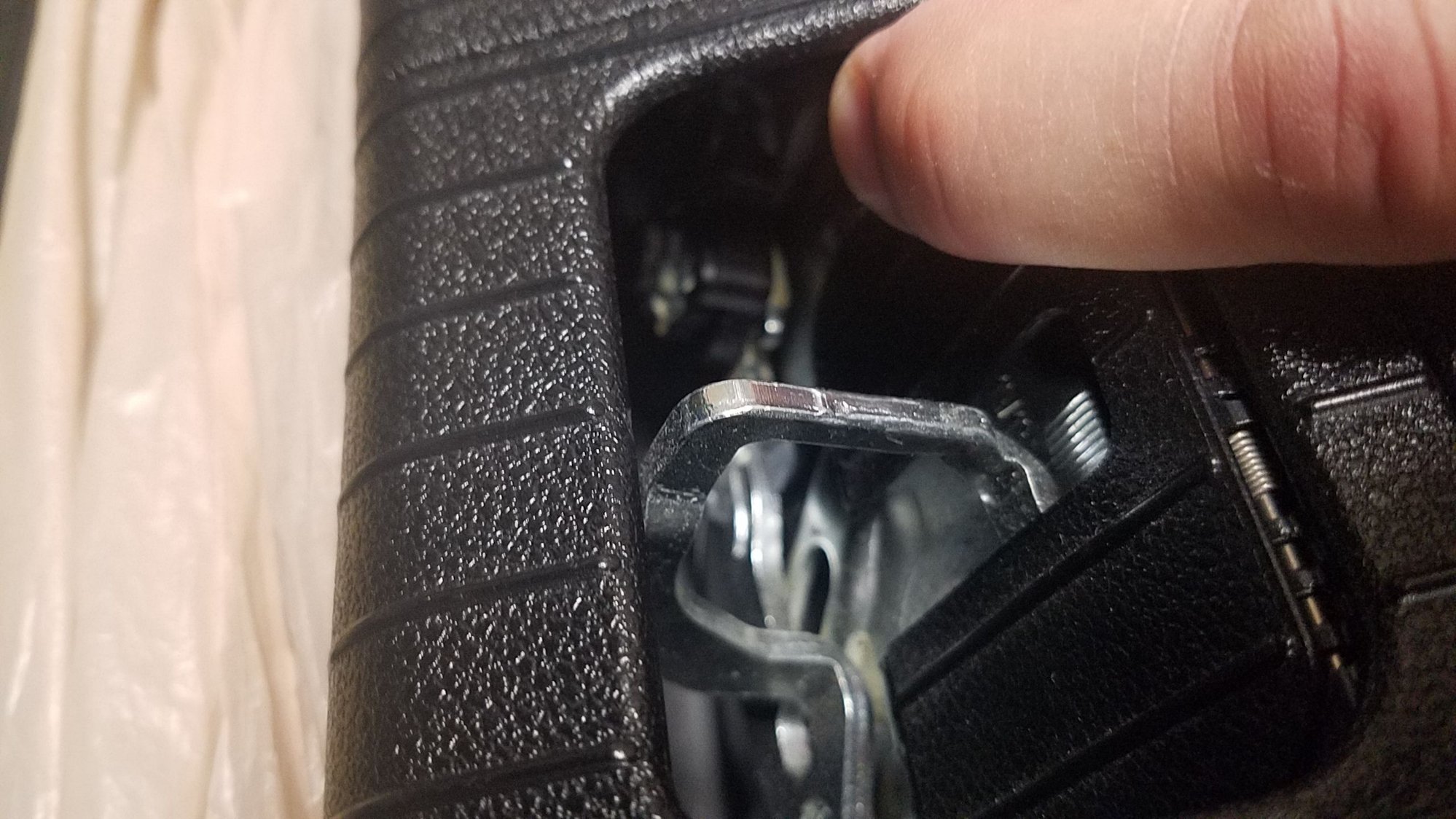

soft catch installed
cable actuated mechanism
lubricate all shafts + rubbing surfaces
dry gear actuator... needs silicone grease

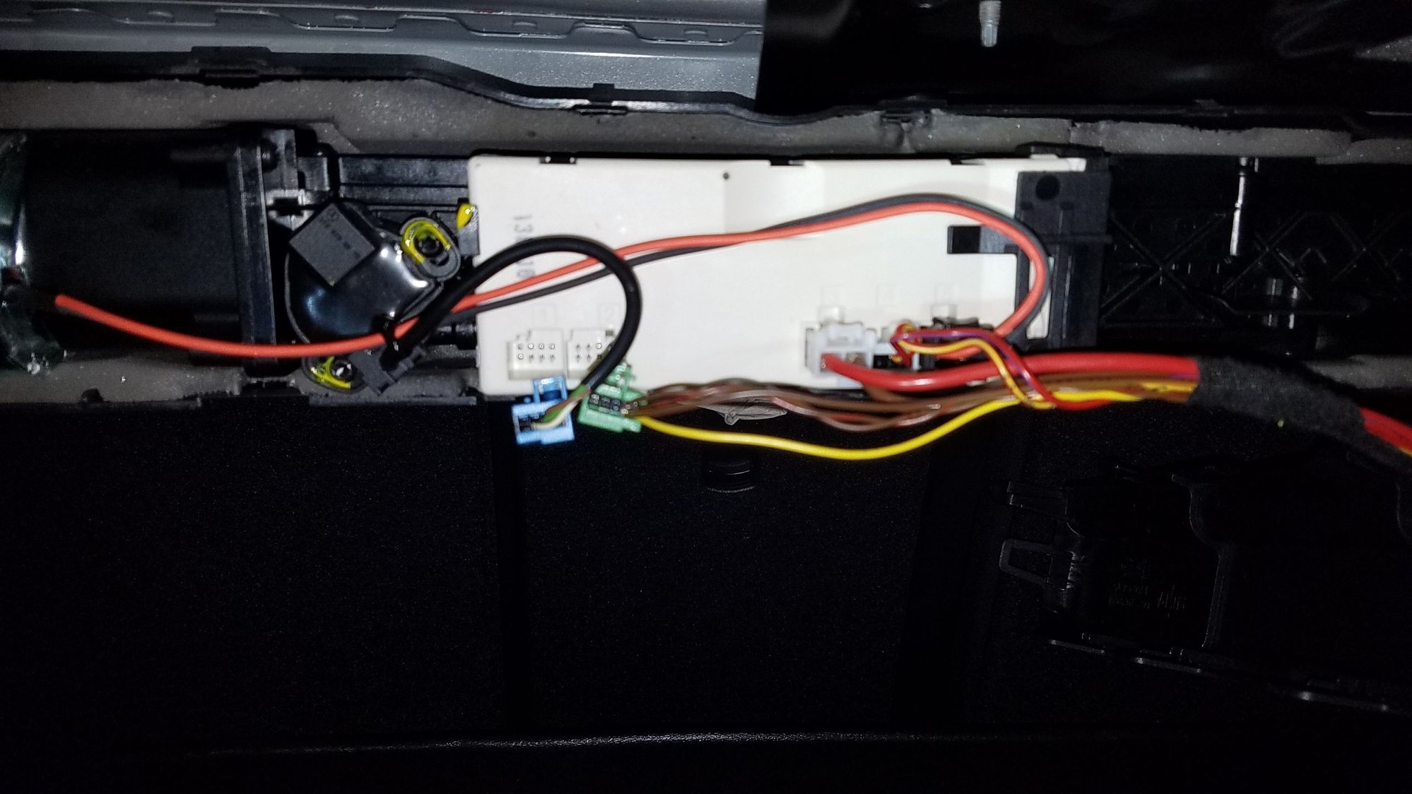

trunk lid pull mechanism + controller
trunk controller enclosure & harness

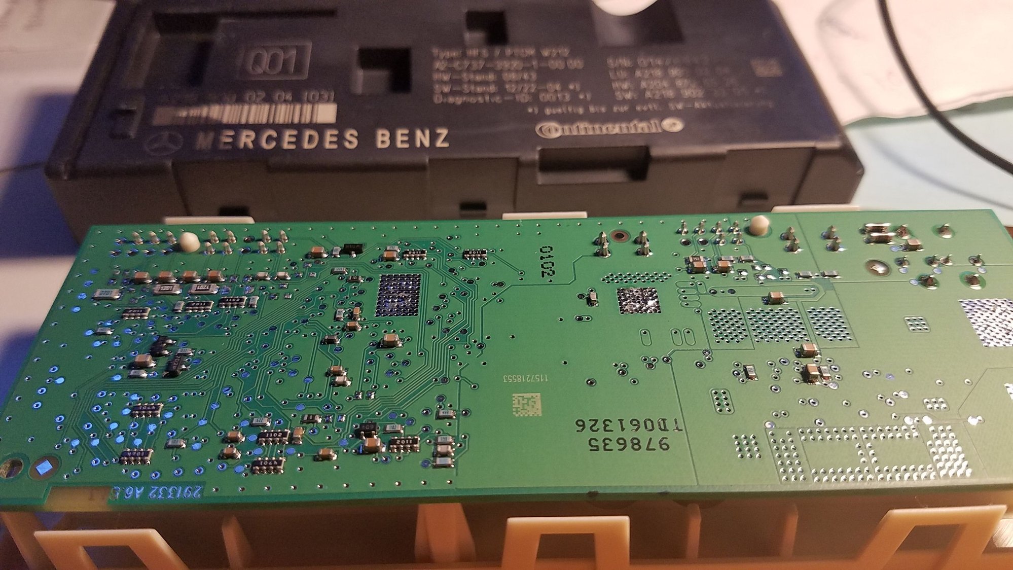

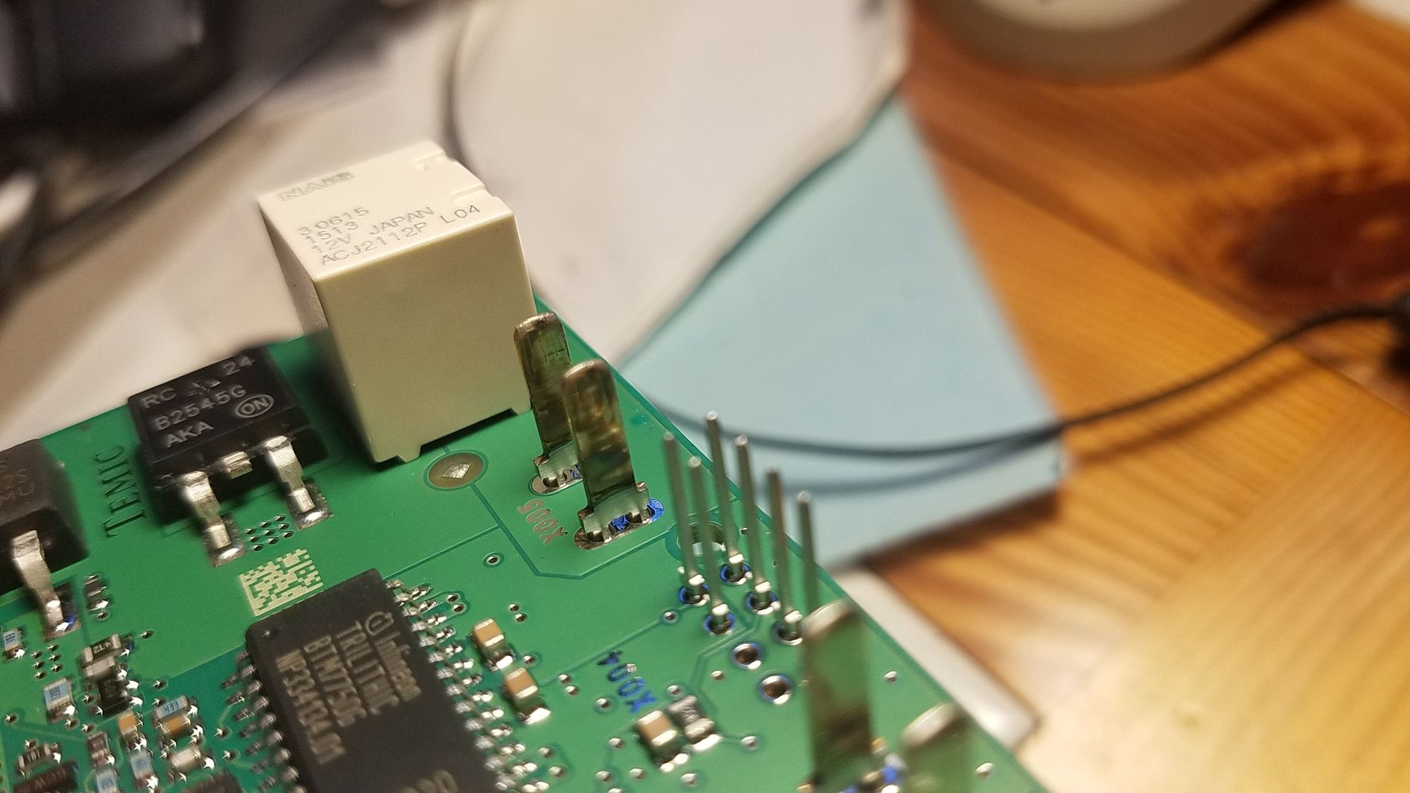

overall view of trunk controller board

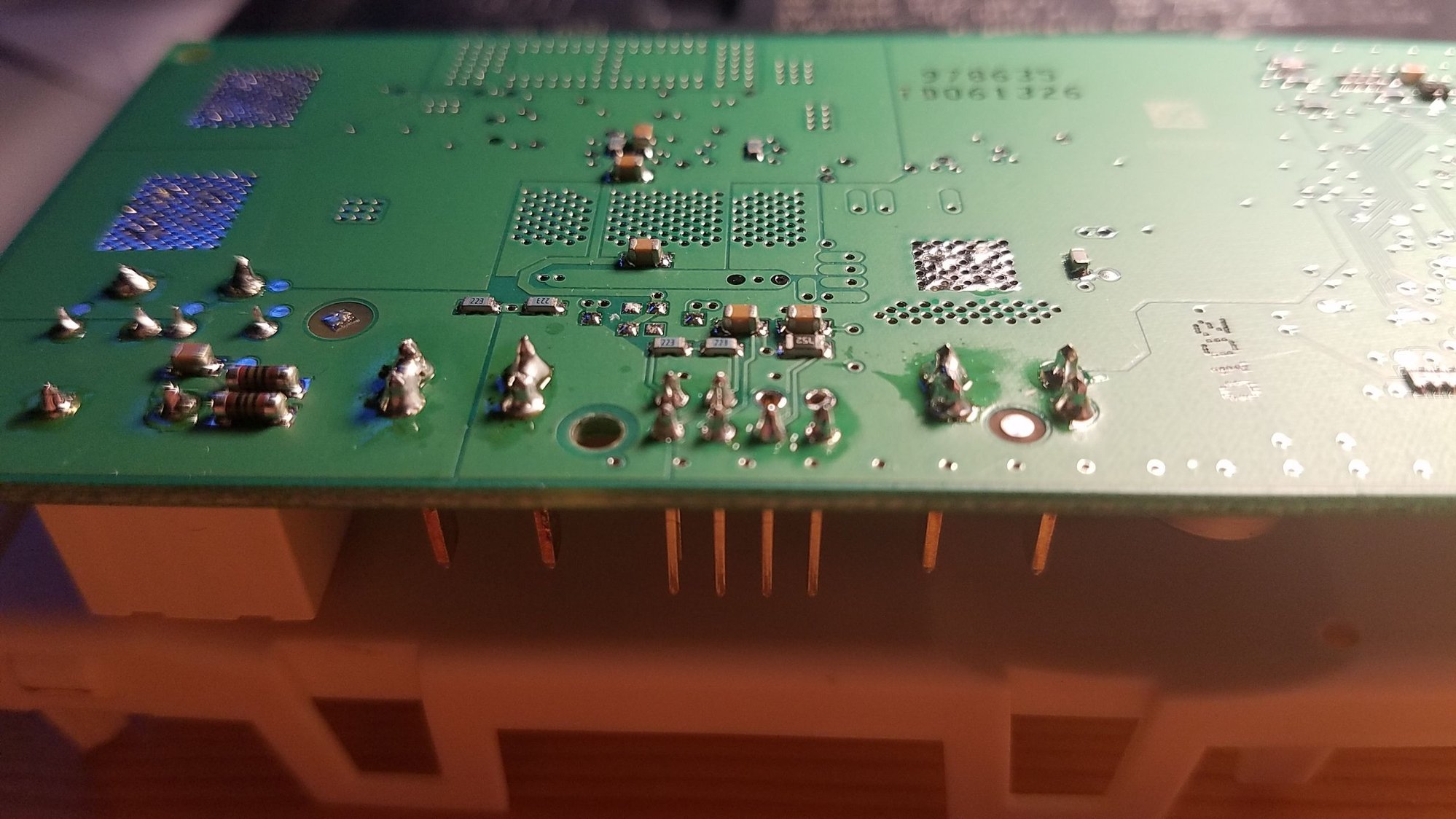

overheated connection pins
das ist das... Easter eggs for Cali
solder side ... solderless mix
solderless pins... turned soldered pins
Consider lubricating the lid puller mechanism hosted near the controller. It has to work against the 2 fat trunk springs to pull down the lid... a little grease goes a long way to make it move smooth.
> Pedicted failure:
The pull mechanism suffer from no lubrication and overload the electronic circuit with high current through loose connections.
When lubricated mechanism operates smoothly with minimal friction.
Same thing on the electronic side: when soldered the loose pins can no longer overheat from high resistance drop-voltage.
If you stop this game early, you'll prevent unnecessary wear and damage to plastics. You may also be interested in reworking the clunks out of your steering "convenience entry" mechanism.
