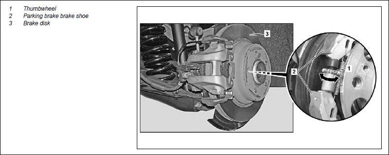

so I have a 2014 w212 e300 4 matic with 130000km on it. that problem I have is, when I am driving and come to a stop or when I back and push the breaks, I get a clunking sound from the rear.
help would be much appreciated

Need to check rear brakes inclusive of parking brake but you know that already.

Jack it up pull the wheel and visually inspect the condition of the pads. Both inboard and outboard. Make sure Caliper bolts are snug. Make sure your rear pad wear sensor is present.

Ya I did check those pads and they are close to be worn out on the inner side, do you really think it could be the breaks?

Are the rotors all rusted? Is your car parked outside? Sometimes you will get a pop noise from your pads being welded to the rotors if they sit in a damp environment. Sounds like the pads are shot though. Replace both pads and rotors.

No the rotors look good, the pads I can see that.
car is always parked in the garage.
But that noise is always there when the car is moving and comes to a stop.
I thought differential or maybe the driveshaft

If you have access to a torque wrench, go around to each wheel and properly torque all lug bolts to 100 ft.lbs. If any are lose the wheel may clunk or tick when braking or even turning.
if you suspect a differential problem sell it.

Well I'll replace the brake pads first and see what happens
