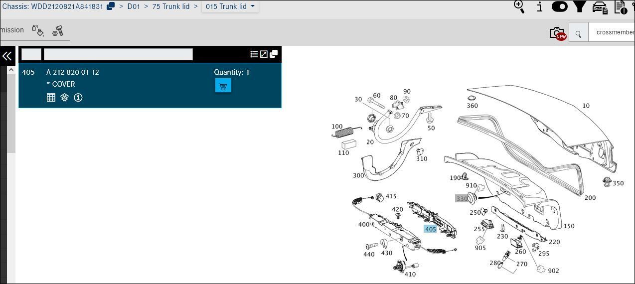

2013 E250CDI 4-Matic missing cover?
Located in the roof of the trunk, can anyone help me identify what it is covering and perhaps even help me with the partnumber?

missing closer cover
your missing cover is for the front of the "Trunk closing" module. It's just cosmetic.
If you extract this module out of its enclosure, you'll be rewarded with an easy soldering job.
Reply with VIN# so @konigstiger can have a chance to find your specifics

WDD2120821A841831

Access cover is broken off need to replace cover assembly part # 2128200112.
