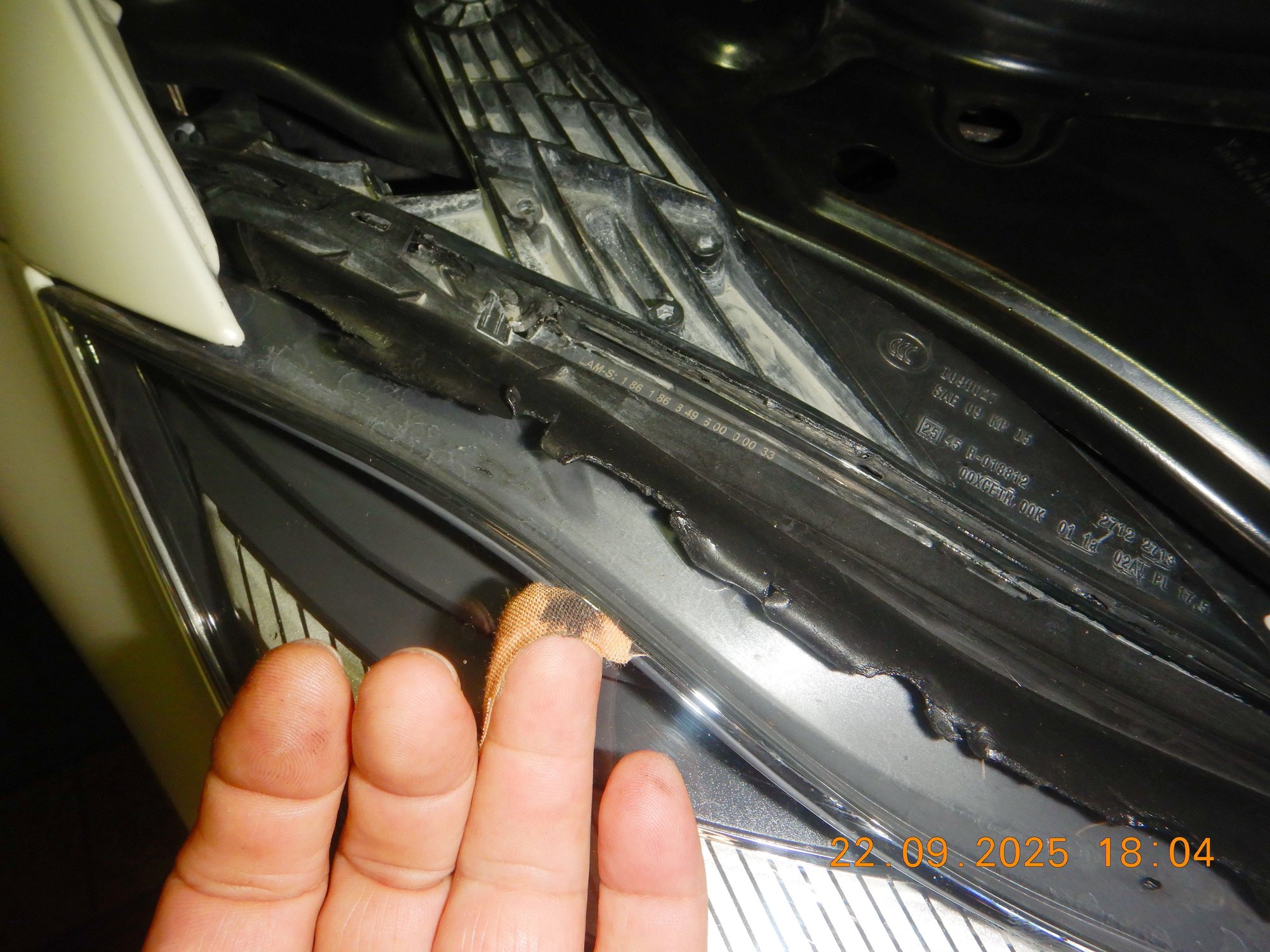

See this rubber edge gasket of CLS63 headlight, kinda "melted" :
Rubbers/polymers aging on its own. The LEFT side is apparently okey, I wonder why.
This gasket is for between the headlight and the hood when closes. Wind and water protection I guess.
I have seen my car interior wiring foam turn to dust as early as car age 7th to 8th year.

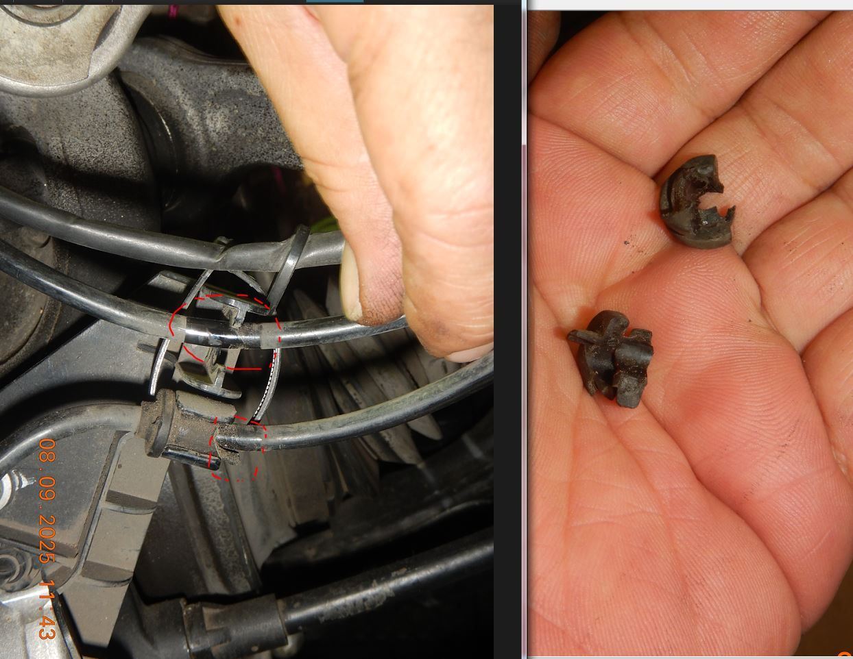

My ABS wheel sensors cable rubber clamp guide ( I do not know the real name ) , broke off due to aging.
