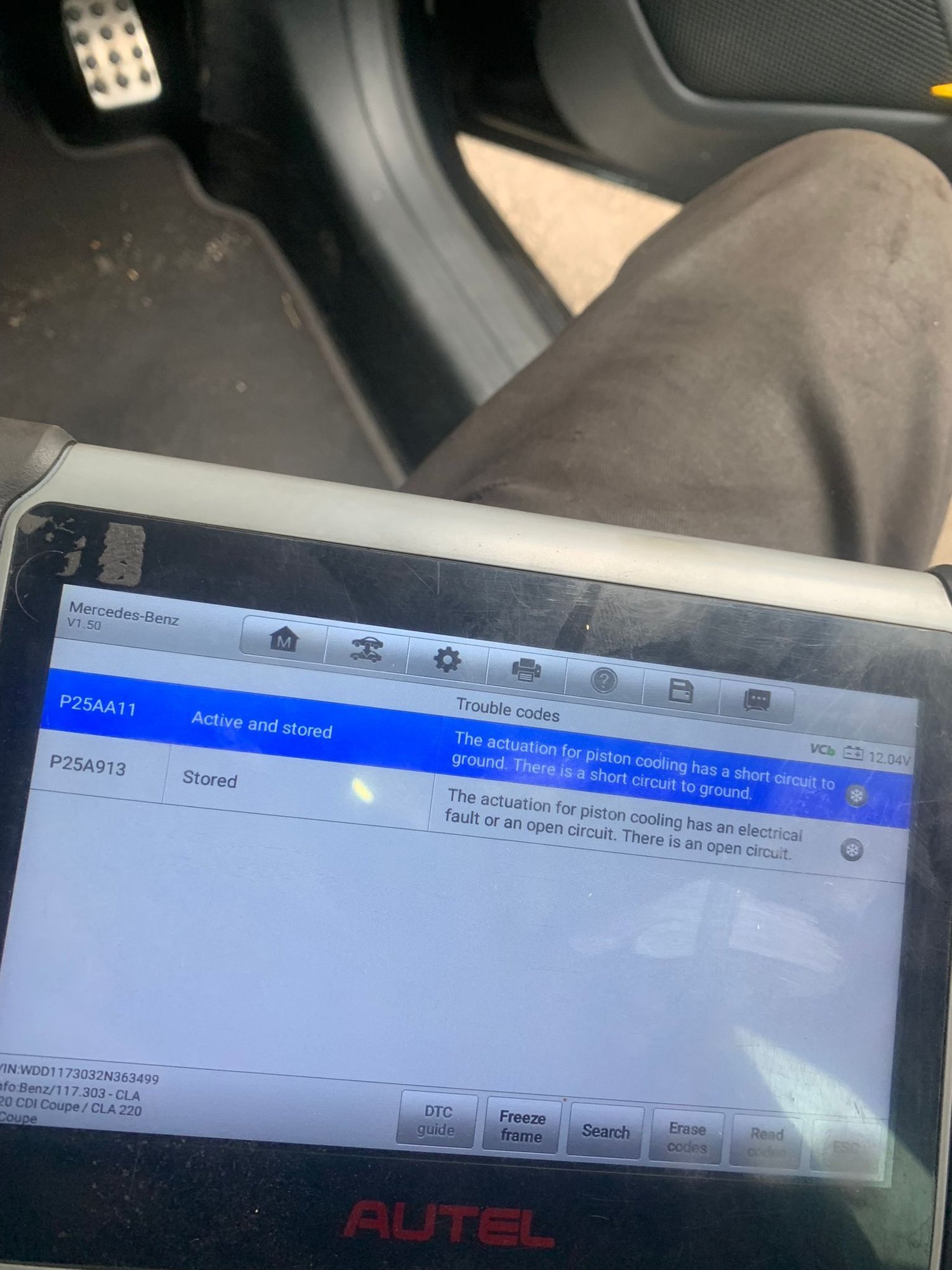

I have the same issue what part did you order for the new solenoid as I can’t find it and also could you find out where the wiring was that was fixed?
thank you

What’s the name of the part you changed?
The part number is in the pic ya quoted.
