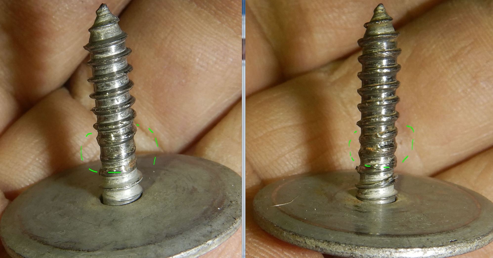

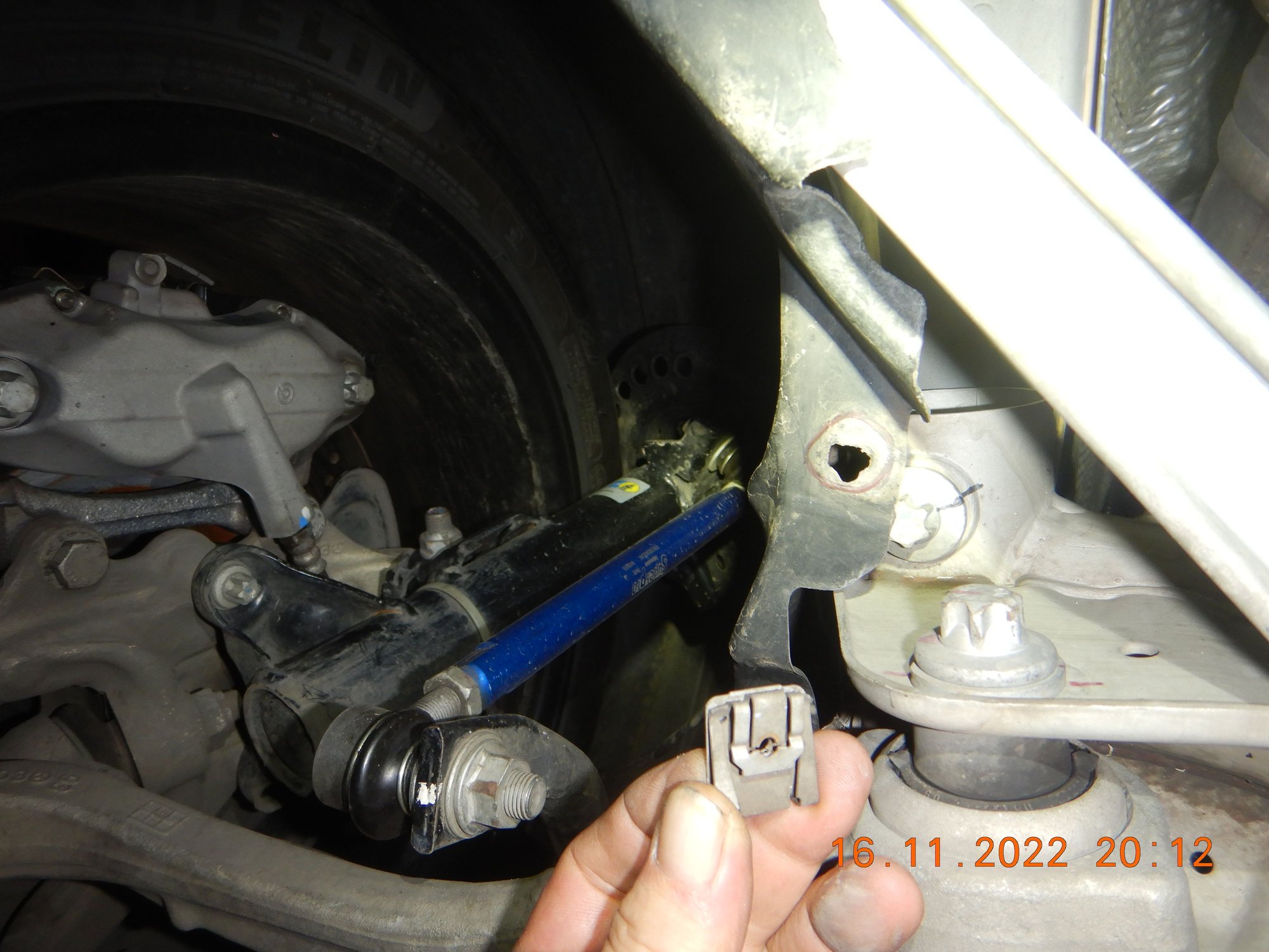

If you often remove 3 under carriage protection plate and plastic sheet

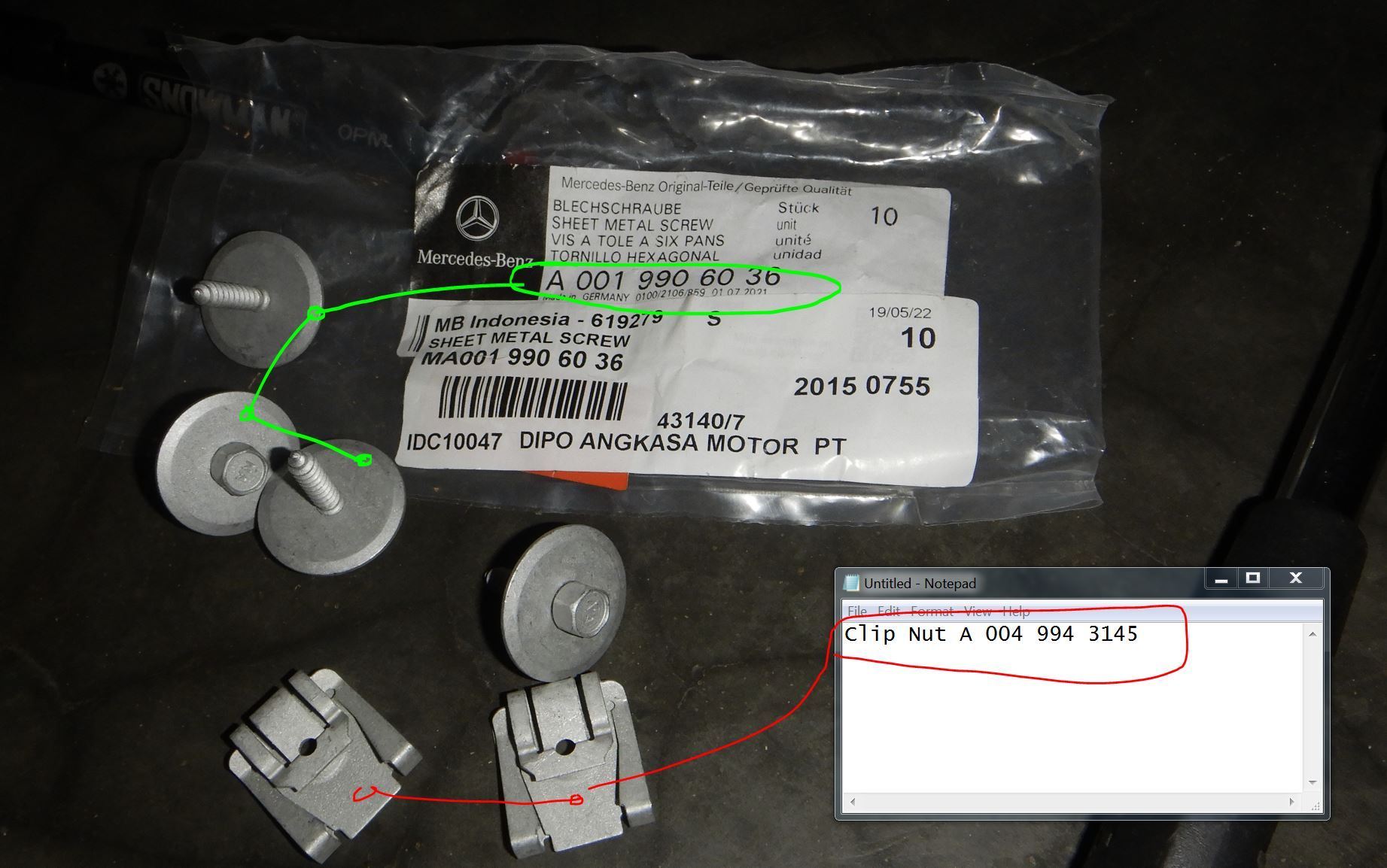

..... you may need these 2 components. They are for the plastic cover Near Bumper and below Tranny. These are the part numbers.
The male sheet metal screw little did I know they are the looser and not the female Clip Nut... I bought only 4 pcs sheet metal screws and 10 of the Clip Nut, ended up replacing all 4 screws.
If these screws falls on the road, it will puncture other car's tires or your own if you are really un-lucky.
They also can be source of plastic rattling sound.

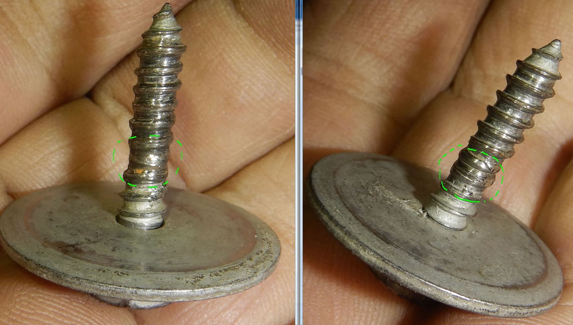

Photo above is when these screws can no more lock or full-stop tighten.
I have removed 3 of the under carriage covers like perhaps 50 times over the ownership of the car
So wear & tear is expected.

That's more likely to happen when you tighten the screws with a battery powered tool or over-torque. Those low-grade screws and speed nuts are only good for a few in-lbs.
I had ONE of them rust terribly while the rest were just fine. The entire thing, screw, washer, clip. Coating failure? Probably.

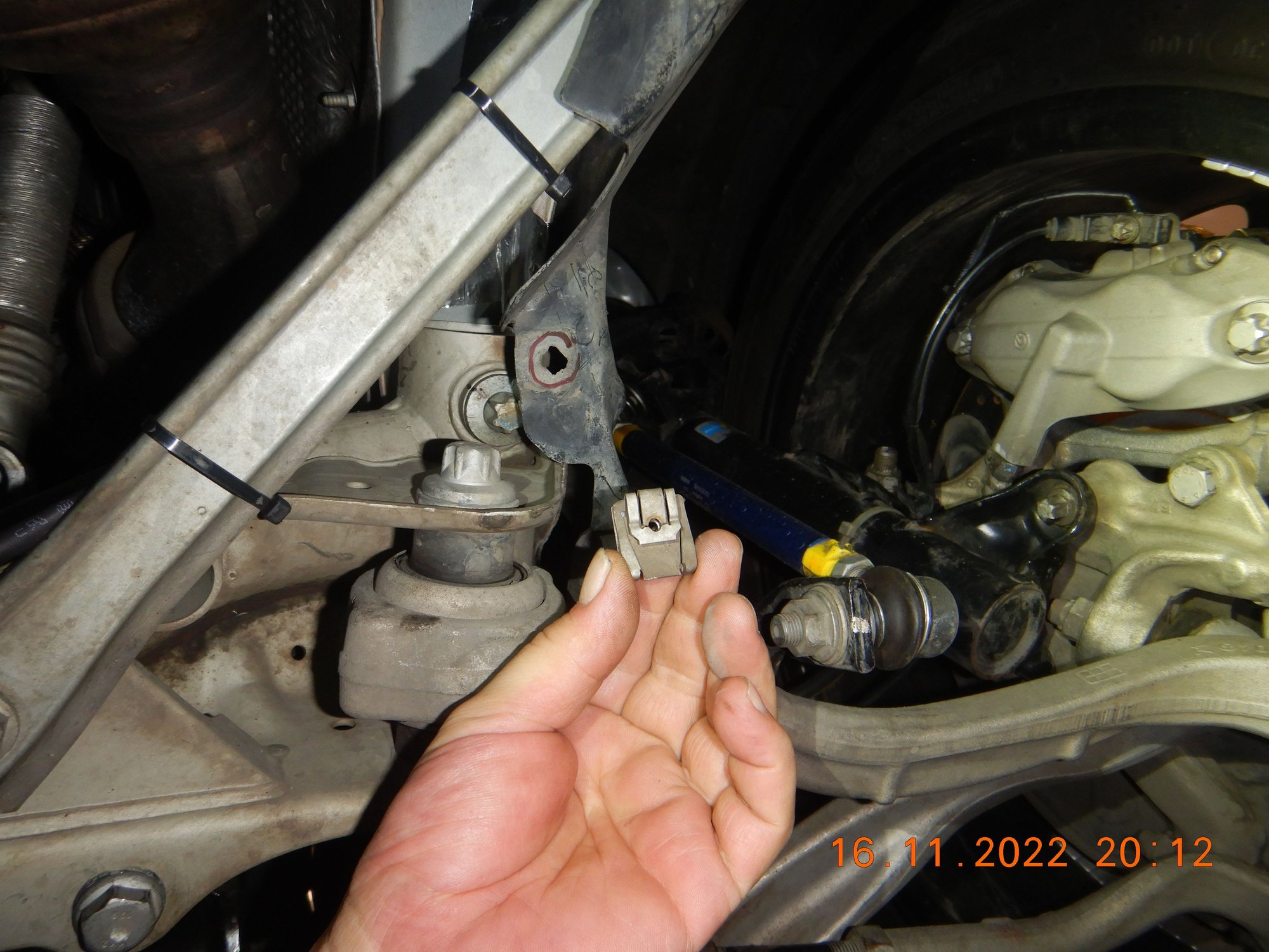

I noticed my worn out screws are usually at these two areas, too much road dirt from the tires I think and when I unscrew/screw in, more friction causing thread wear from those dirt.
I doubt any of you have removed this batman shaped tranny plastic cover as often as I did for a 2014 car
The red circle
