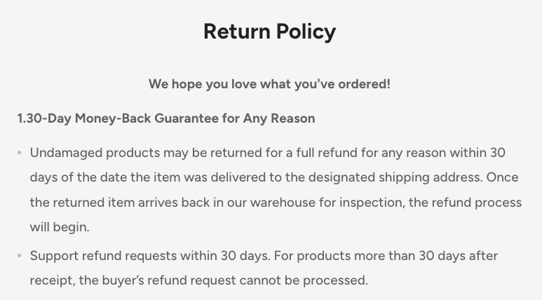

They also have the K8, K8 PRO and K10 for a little more. With a 30-day money back for any reason guarantee, it may be worth a try. Since you are servicing a fleet of vehicles, the price is very reasonable.

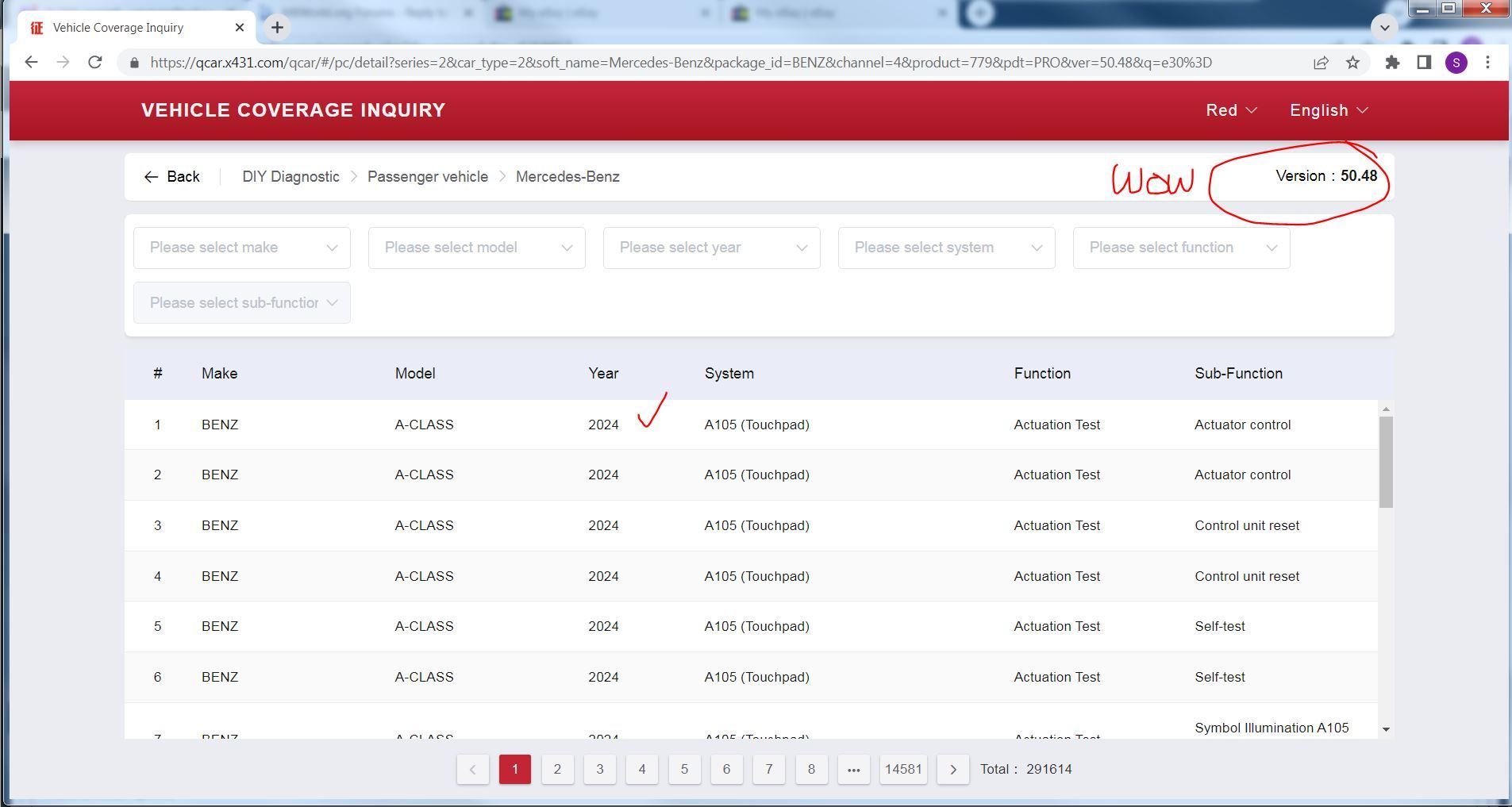

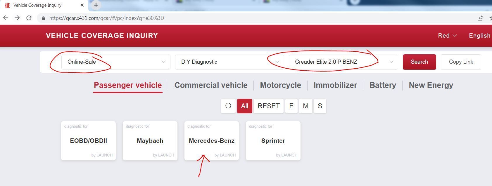

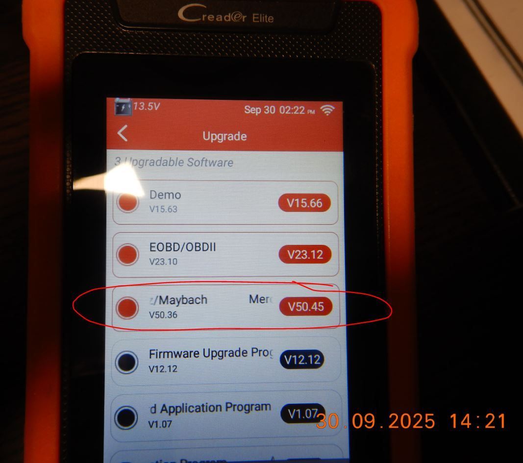

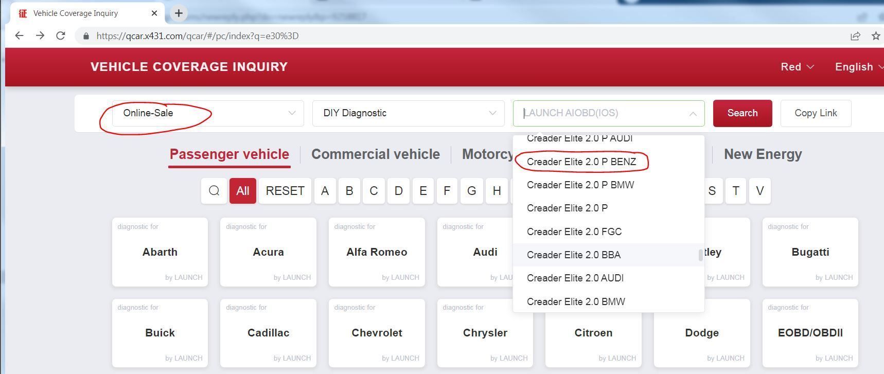

Based on my oldie gen 1 baby launch, on 3rd of Aug 2025, latest MB firmware was V50.36
Today 30 Sept 2025 I saw what Jetta was promised, the V50.45 is available.
Now, what good is V50.45 ? I dont know because V50.45 is too old to be listed in Launch website..... LOL.
Someone must try on 2024 MB cars.
Just so you know, there is no gen 1 Creader Elite Benz listed in Lauch Website, only Creader Elite 2.0 Benz.
https://qcar.x431.com/qcar/#/pc/index?q=e30%3D
Supposedly .... Elite 2.0 is already having V50.48 which can do newer cars. Now you guys who owns 2.0, test it if you can get V50.48.
Back in August the version highest for MB was only V50.47

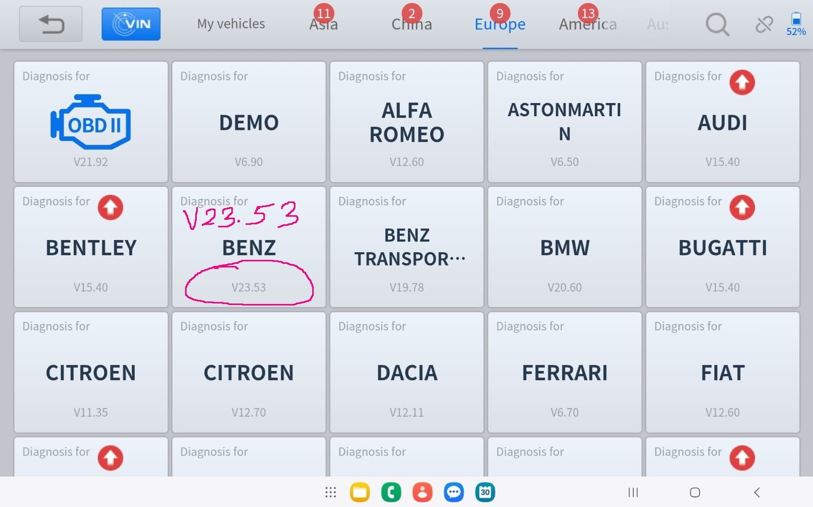

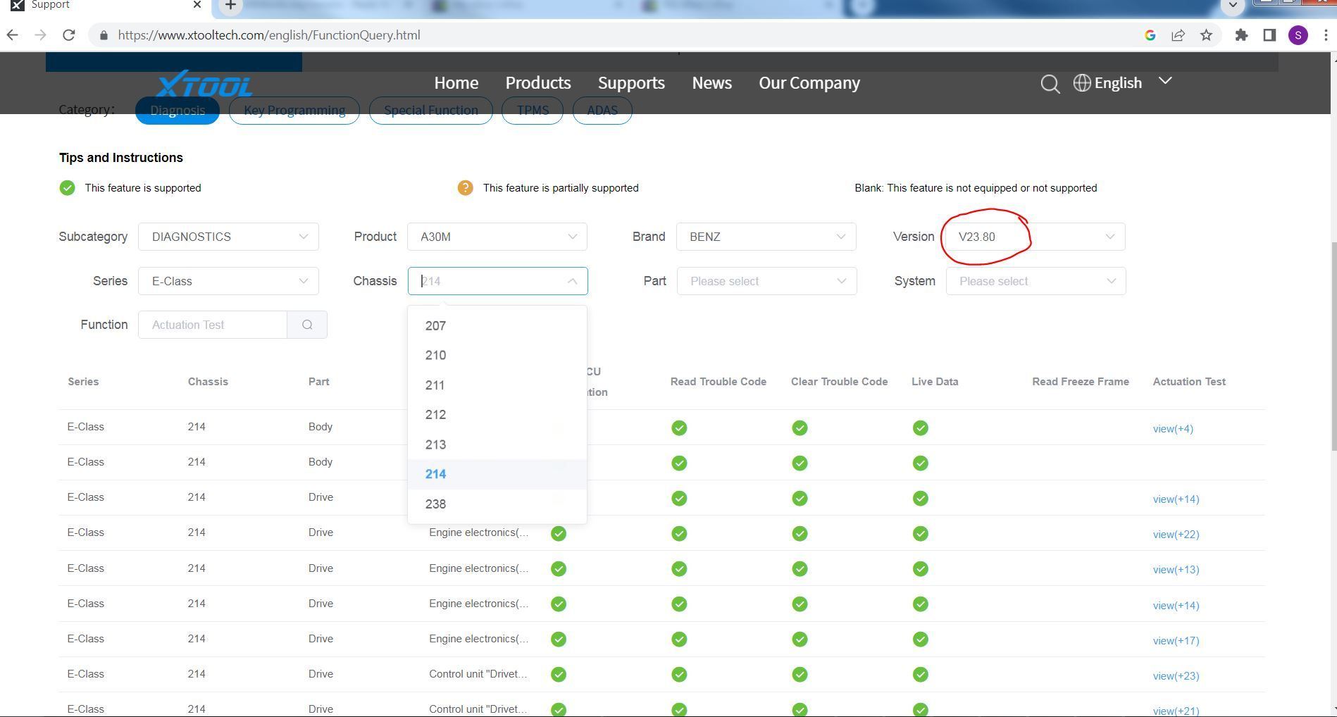

X-tool, same cheat.
As per website, my free lifetime update model is called A30M
Today I turned it On to find what is latest on MB, see way much older firmware.
If Launch still keep this cheat on gen1 and gen 2 baby Elite, best to make much noise, more so the American consumers where the consumer law is strong.

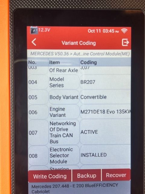

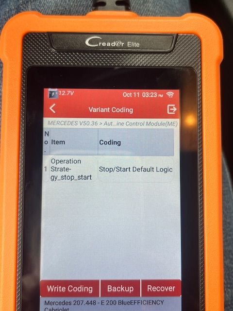

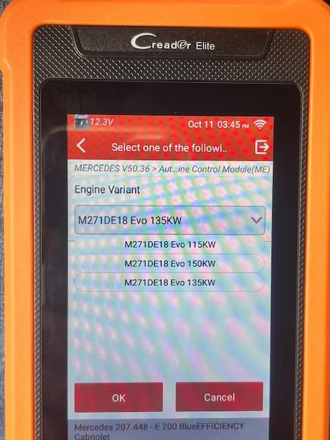

Engine power variant coding & ECO off
I have the Creader elite and finally started playing with it on my A207.
I could not set the engine start/stop to last setting 😢
But I adjusted the DRL brightness when headlamps are on 👍 looks much nicer now from 5% to 15% (any higher will probably be too blinding).
Then I found this one here
SURELY it can’t be THAT easy to transform the engine power of my car to the E250 spec, right?
has anyone tried this? I was too scared to adjust this! 😅
I would love it if there’d be a centralized place with all A207 or at least W212 mods 🙏

What error did you have when setting the auto start/stop default position?

No errors. I just want to disable start/stop completely or set it to remember the last setting, but such options are not available on the W207 platform (or at least I did not find it)

I see, try updating your system version of the scanner.

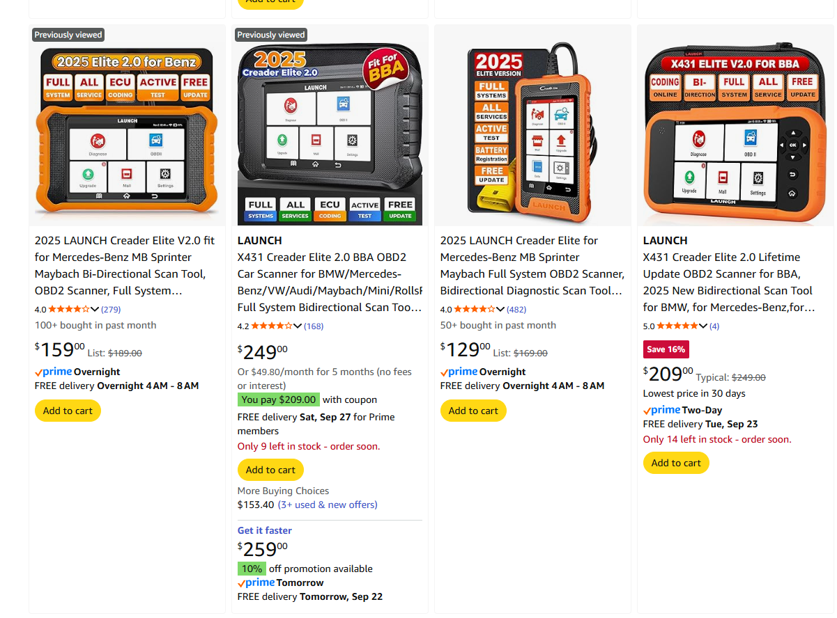

Not sure if this was covered. Im seeing 4 of these Launch scanners for MB.
Do they all do the same things, same software? Obviously the two higher priced units have the additional BMW and Audi functions. I also noticed the Android OS are different between the units.
I'm thinking about getting one and I like the "Elite V2.0" just because it has the horizontal screen. AliExpress has it for around $105.
Unless the black one can do more in terms of with Mercedes? I dont have a BMW, VW or Audi.

The expensive ones do BBA = BMW, BENZ & AUDI vehicles. so 3 manufacturers.
the others just do benz.
